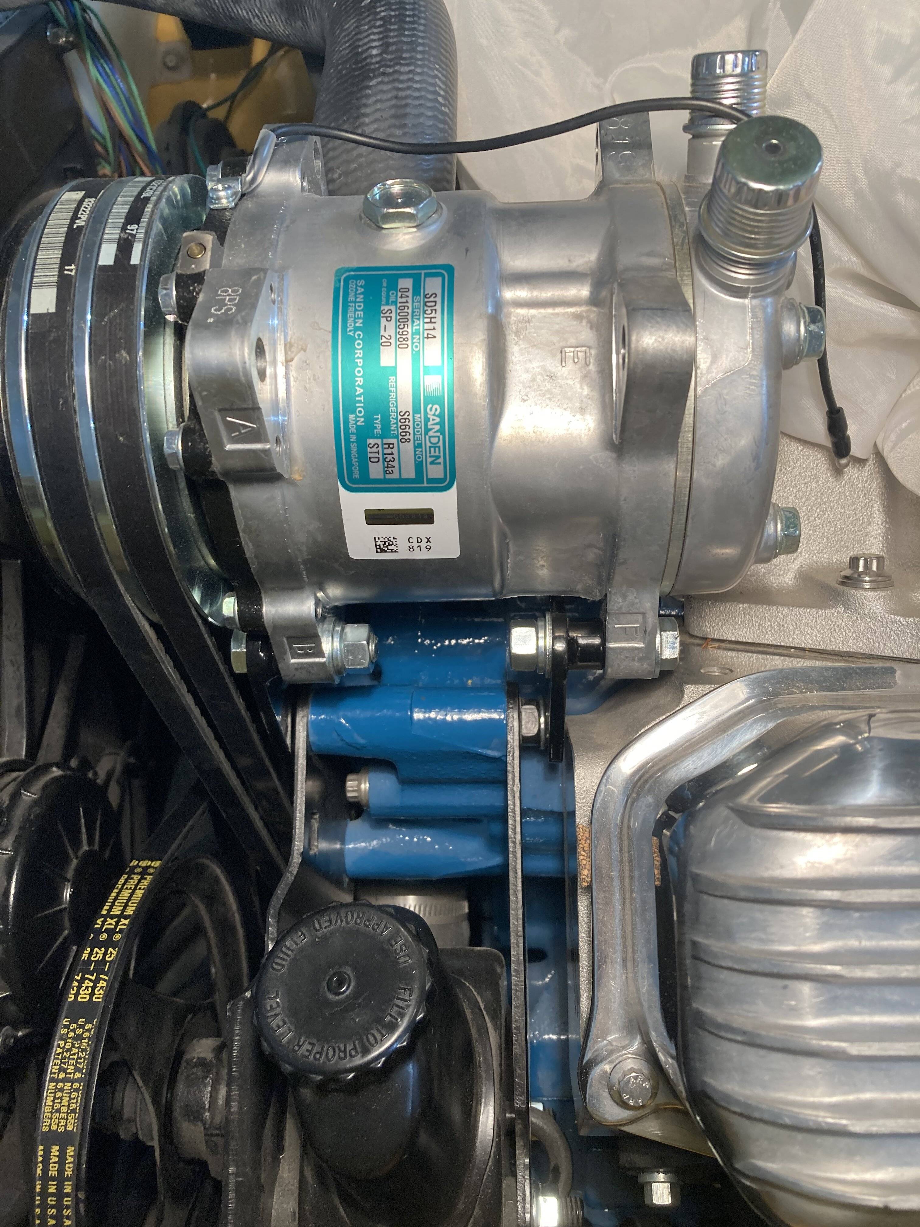

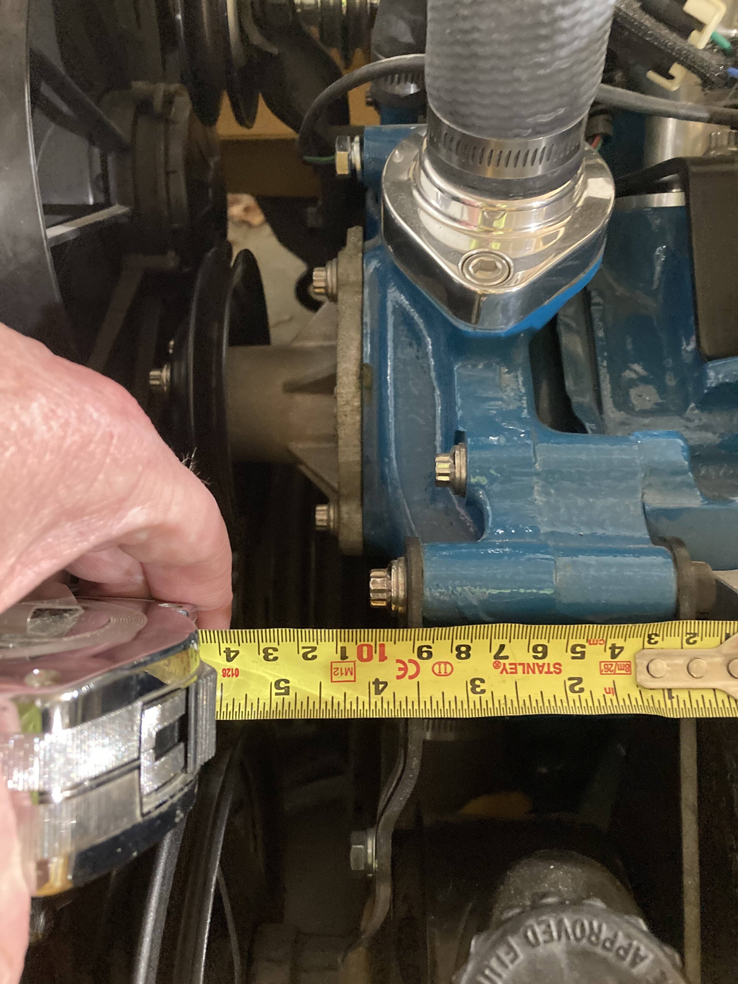

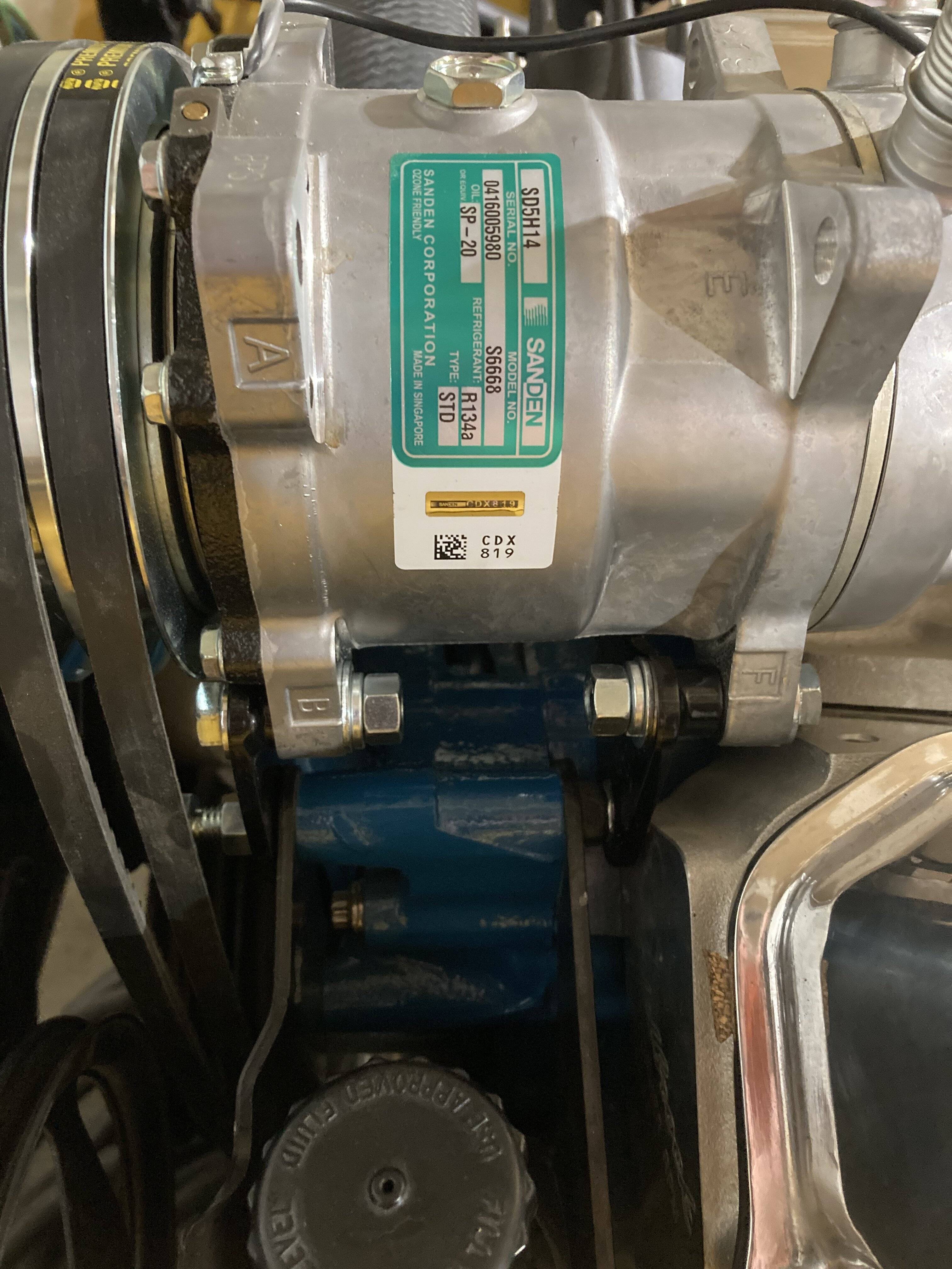

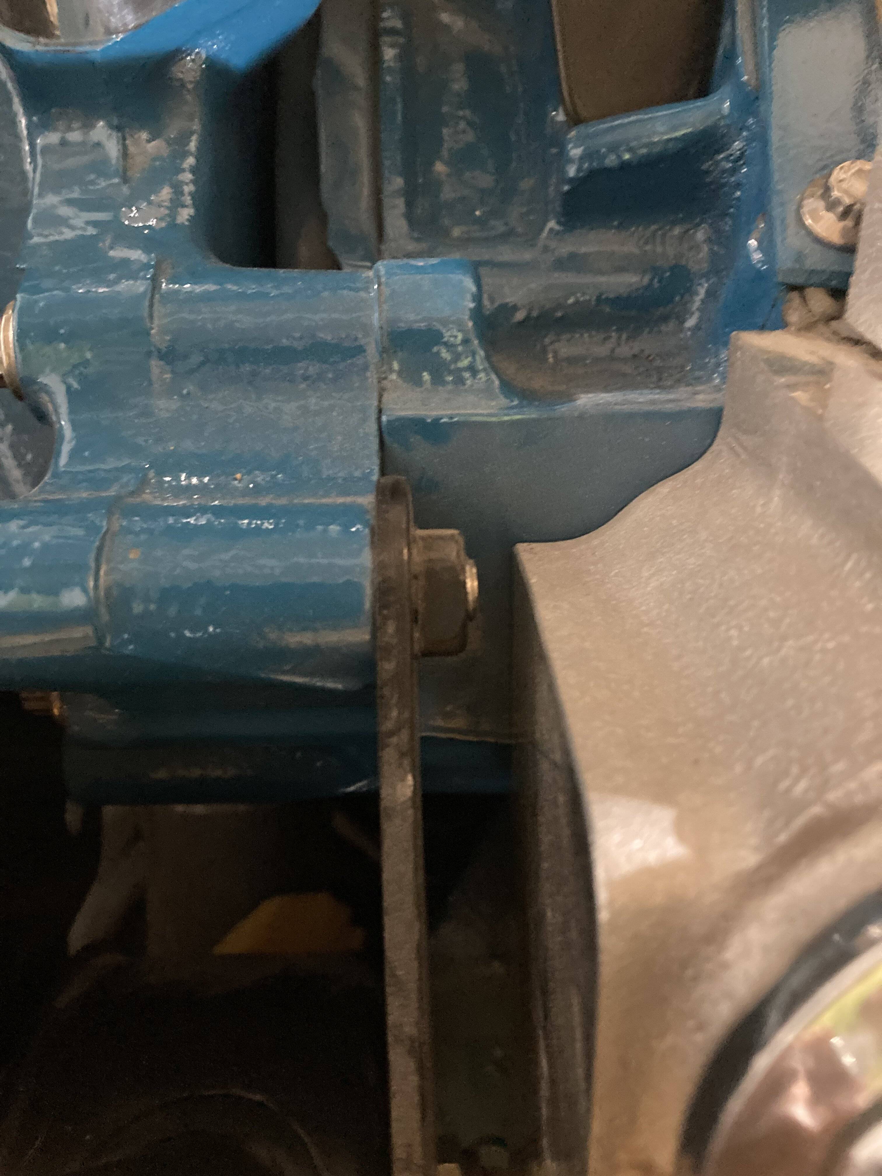

Greetings again my friend:
Here’s the photos I took of my failed installation of the Sanden 508 Compressor, and the upgrade brackets sold by Classic Industries.
This might fit Mopar 383’s with stock heads, clearly from the photos, no way - no how will those AC Brackets bolt up to a 383 with Edelbrock heads.
Is there a logical answer for this equation, or am I doing without AC?
Thanks in advance - Doug White

Probably the heads are too long at the front pushing the brackets too far forward .

Yes - that C.I. / AC bracket set up isn’t compatible with those Edelbrock heads, as it is. It’s going to need a little finesse, to make it all fit.

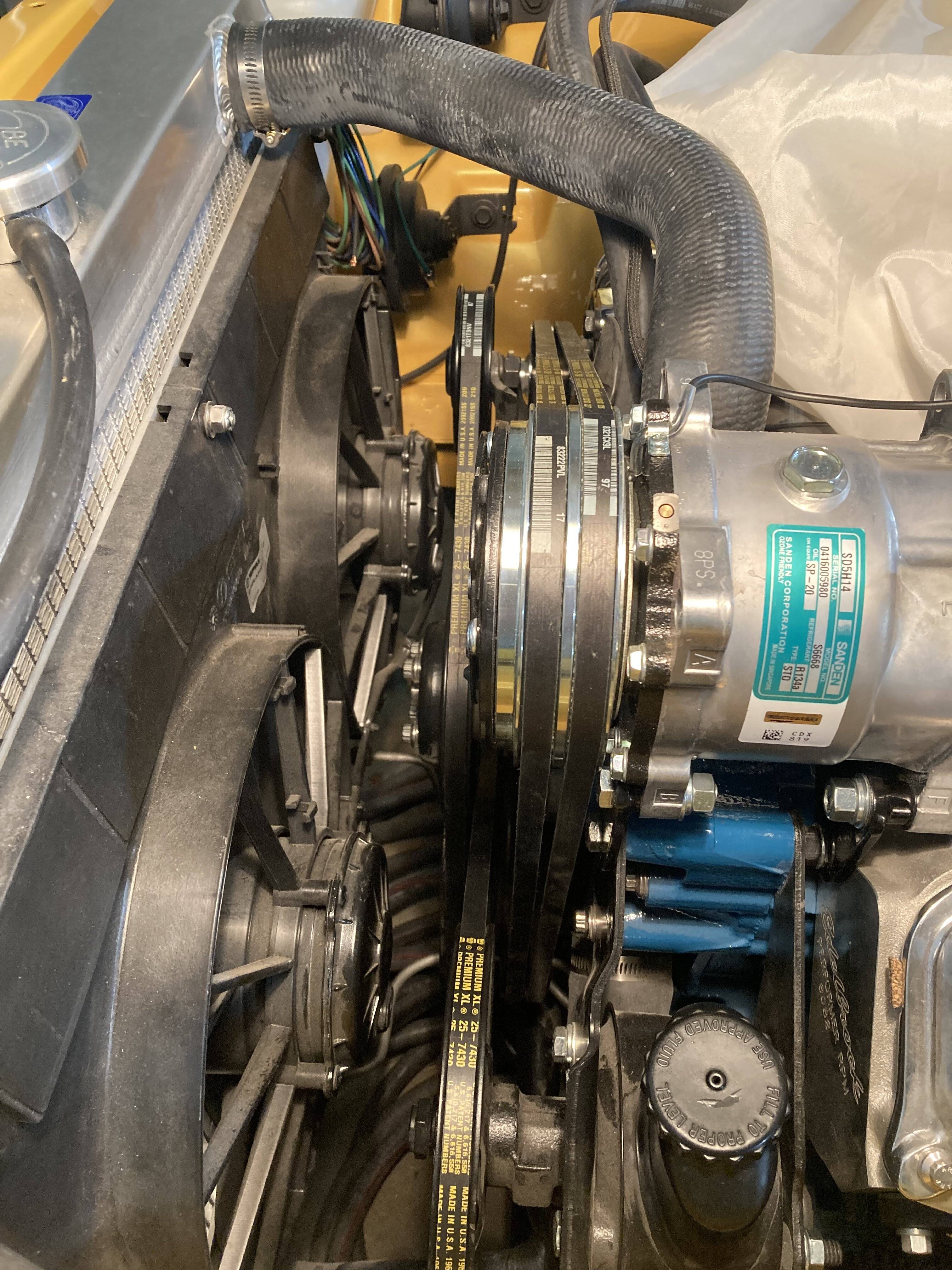

Yes, I ran into a belt adjustment issue with that chrome C.I. Alternator. The head won’t allow for the full adjustment of the alternator - but it’s close. I’m going to try a little shorter belt, and see if that might be a viable solution. I’ve still got to make final fit adjustments to the AC bracket jewelry, after that’s put to bed
I’m really surprised nobody’s ever tried this before - this forum has a knowledge base that’s second to none.

Remember that with a dual belt application, the belts should be a "matched set". That is because belts will vary in their length and this will cause squealing as the belts are actually spinning at slightly different speeds.

I went through the belt thing when I converted to Sanden with dual pulley.
Bought 4 belts at local auto store, mixed and matched until I found 2 that worked together and returned the other 2

That Sanden AC unit now fits my 383, with those Edelbrock heads. Looking at the service manual, everything else lined up as originally designed. Snug, but functional…..
