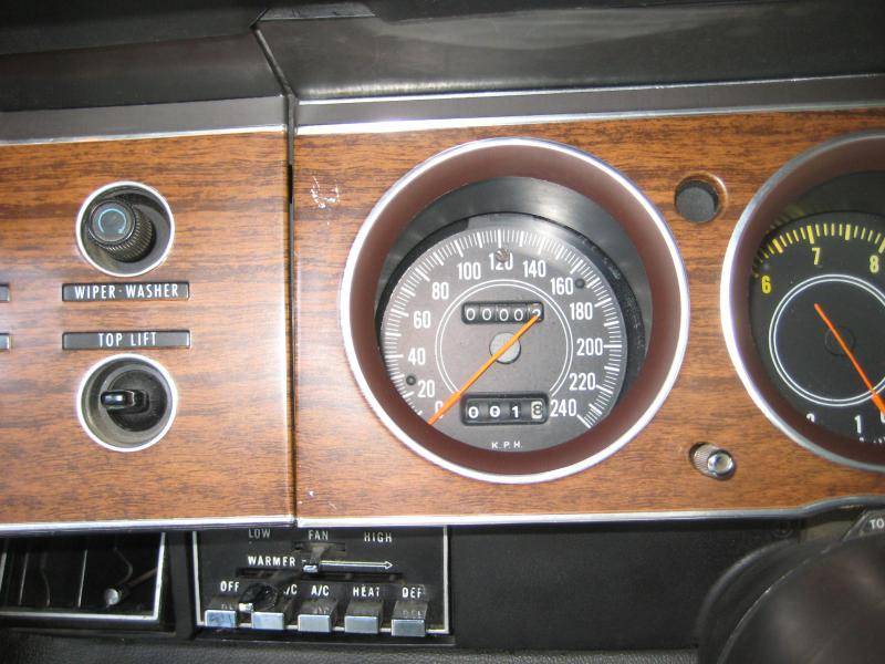

look at these they are made by my friend and has the holes for the rivets and the lines are much finer than the other brands, only the speedo are done in this photo, I can give you hes contact info if you are intrested and they are not very expensive.

I have seen those, and they look pretty decent. However, as I said originally I'm looking to get the faces redone as original which means no decals. If it's too expensive for my budget, I will revisit the thought of using decals.
