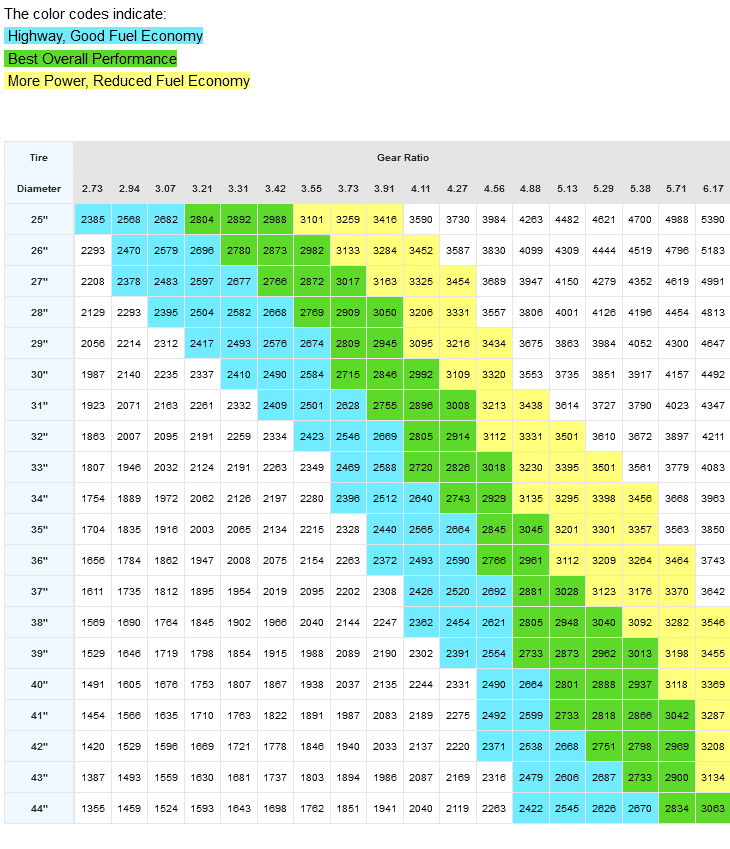

I need some help. I have a 1970 challenger 383 650 carb ,auto with ac. Little bigger cam than stock. I have a 391 gear now 8 .75 741 case... Seems like I always need gas. looking for a good gear to cruise or drive down the Highway.
Thanks .

Well the gears certainly are not helping but these were never 20 mpg cars (usually) and given your engine/cam situation you are probably not going to get a whole lot better.
That said, I'd go with 3.55s, they are my favorite usually. Good low end but not horrible for the highway.

There is so much to this .
Where does the cam start to make power , what converter lock up speed do you have ?
If the converter is unlocked at normal cruising speed you will make a lot of extra heat in the trans from slippage .
Use an online calculator to make sure the change puts you into the range you want

Personally I like the 3:23 gear with stock tire size. Drove to navy bases about 275 mile,on just less then a tank of gas.I would have about a 1/8 tank left as long as I didn't kick in the four barrel. four barrel would kick in on some grades running 60-65+. It amazed me how the thermo quad performed. I had a 68 and 67 mustang that would pass any thing but a gas station.same trip four tanks of gas.high lift cam 650 dbl pumper 302 auto

I would fill up at start of trip squeeze in 16-18 gal,fill tube filled. Drive the dead of night and cool. 90% highway and turnpike I would get 15-17 mpg lucky if I got 18. stock 340 4spd 3:23 G 60 15. I Know the 71 thermo quad was different then 72 and up, if that made a difference?
