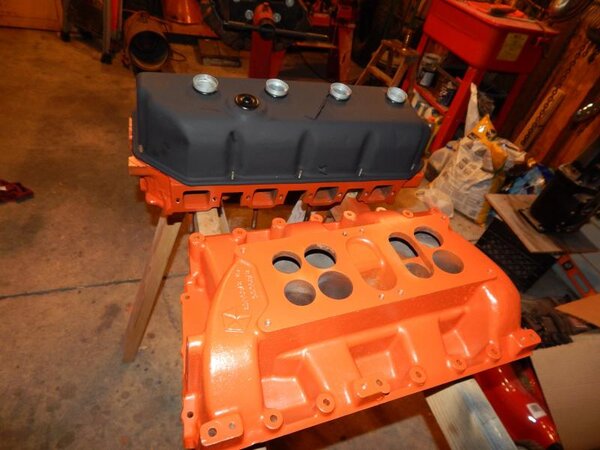

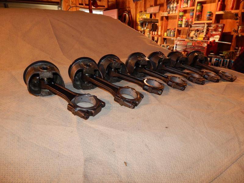

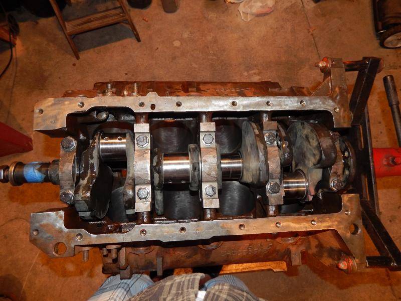

DSCN0855.jpgDSCN0857.jpgDSCN0854.jpgNew bearings, new rings, new paint. It won't be long now.

Even Stockers tend to get abused occasionally...
Are they at least new replacements?
Thanks for posting. It never gets old looking at them.

Just checking to see if anyone else was reading this. With the cost to build any Hemi, I would only go with the best. But that's just me. Learned a long time ago that you never save money by going second best.
RUNCHARGER
Aug 16, 2013
133
42
Looking good. I've run Hemi's since 1980. No need for studs, Hemi's have Crossbolt mains, much stronger than a wedge and stock they'll handle double the horsepower of a wedge block.

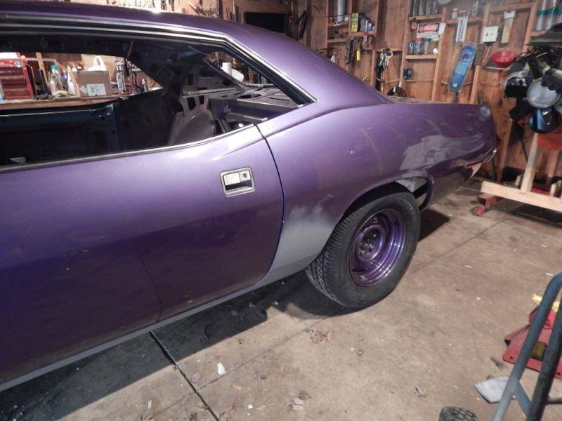

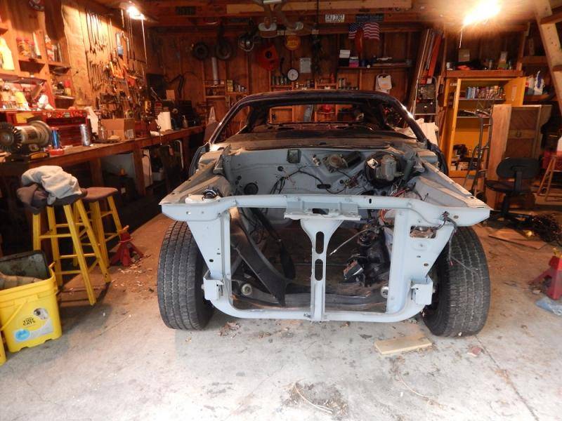

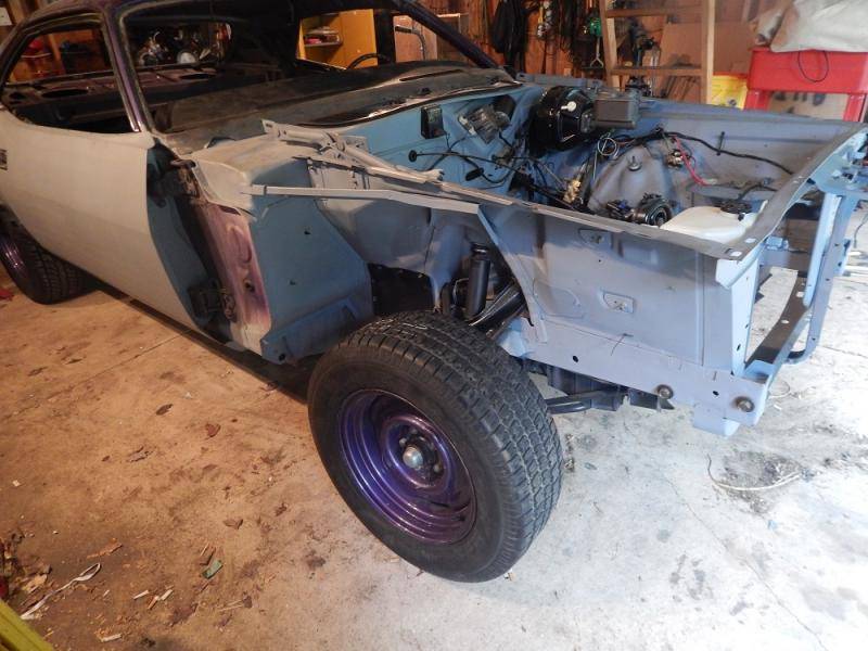

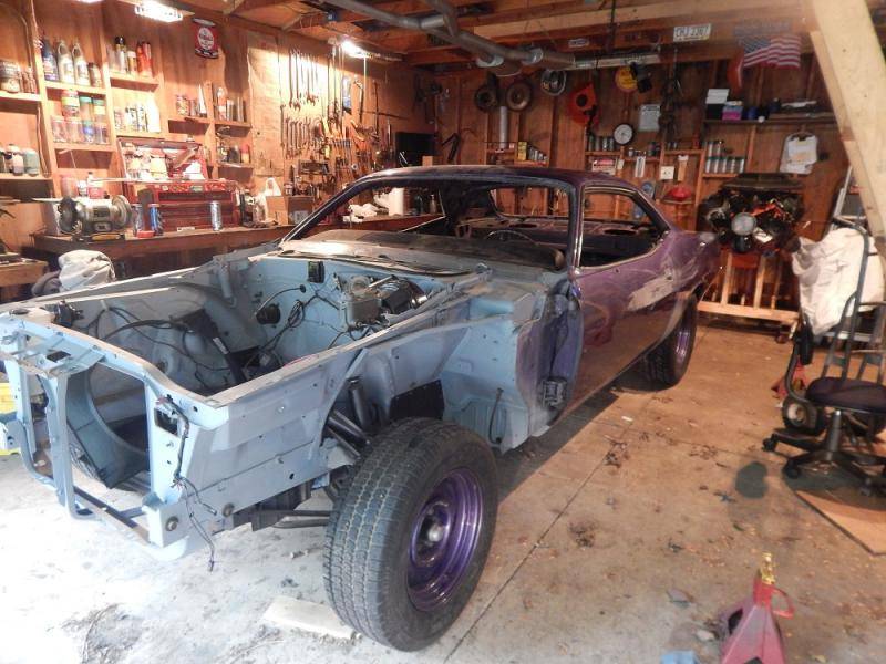

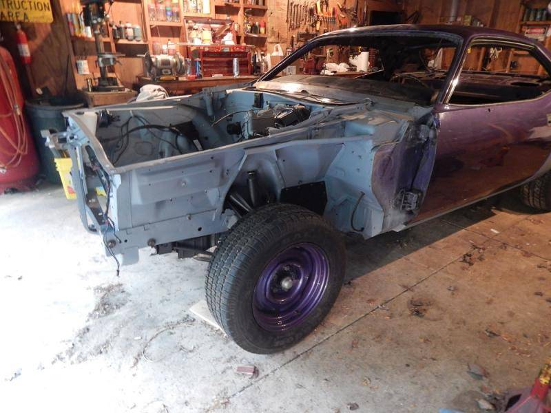

Well I got four tires and she has touched ground at about 5:45 pm eastern time for the first time in about 10 years.DSCN7283.jpgDSCN7284.jpgDSCN7285.jpgDSCN7286.jpgDSCN7287.jpgDSCN7288.jpg

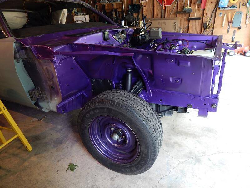

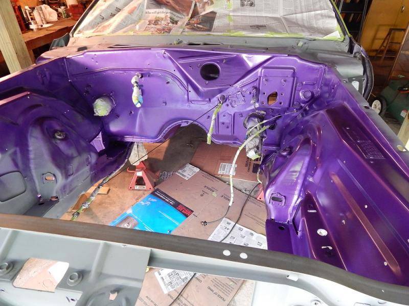

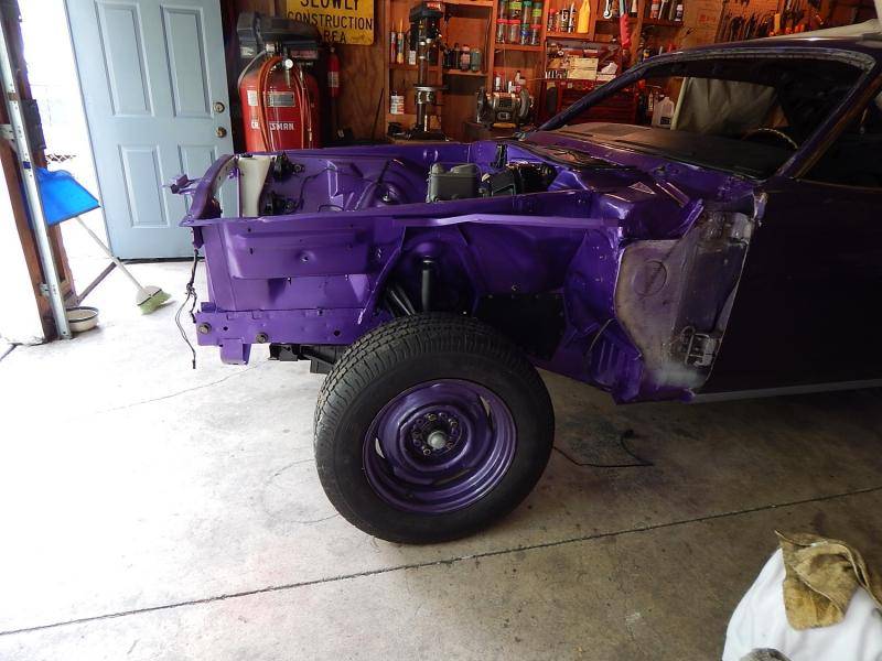

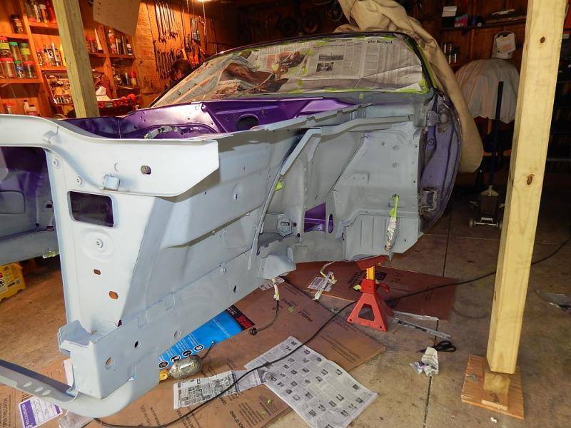

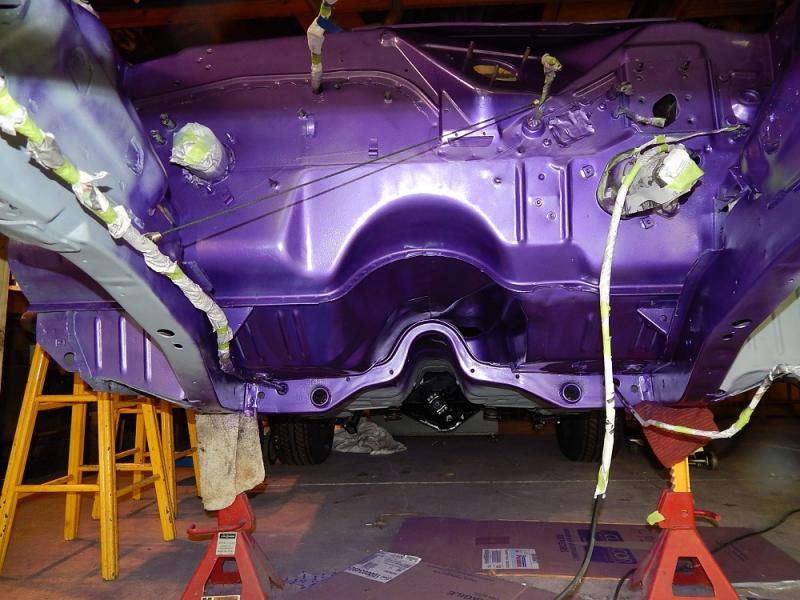

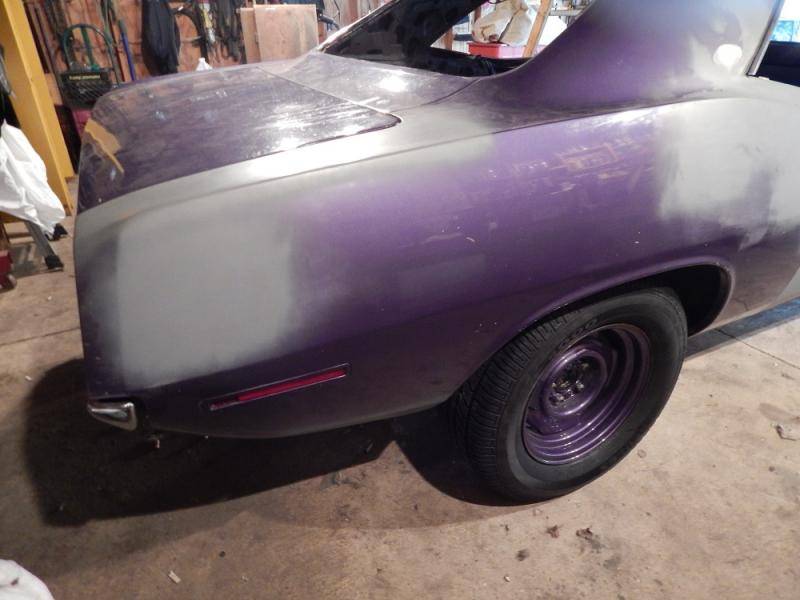

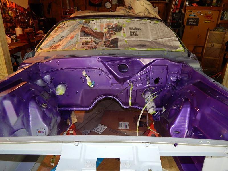

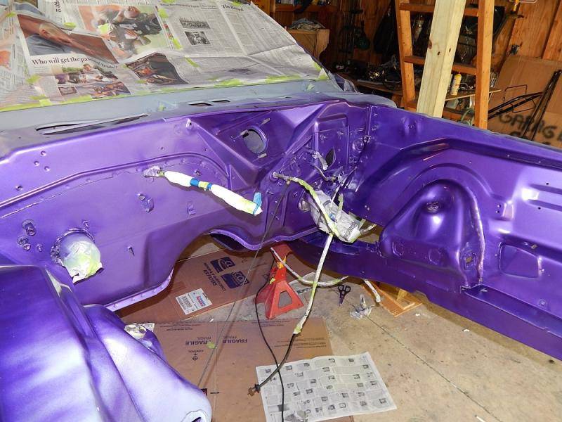

DSCN7986.jpgDSCN7989.jpgDSCN7991.jpgDSCN7992.jpgDSCN7995.jpg Started the paint process, so far everything is looking pretty good. Picking up more paint tomorrow to finnish the rest.

Very Nice....LOve watching it all come together!
Adam
Dec 25, 2012
1,694
758
Washington
Install the engine and trans from the bottom if you can; wont mess up that paint and you don't have to wrestle your starter and steering box around!
heybird426

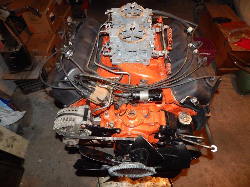

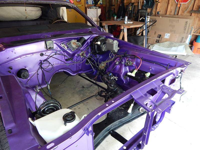

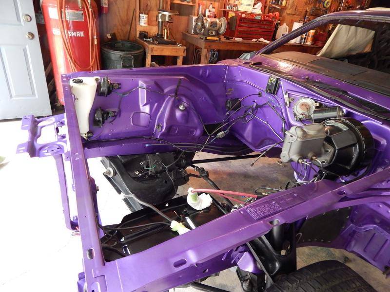

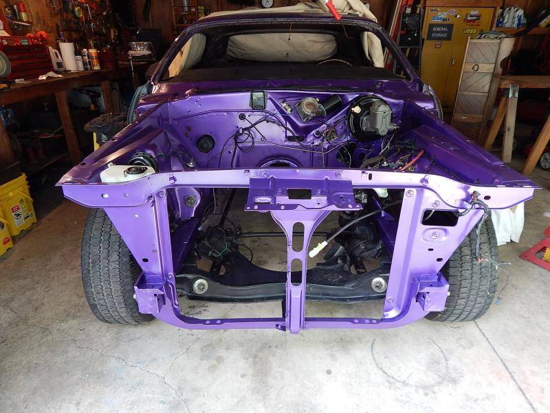

I have no way to put the HEMI in from the bottom so I'll just do it the old fashioned way. Just about ready to do that now, first a new timing chain and I'll be ready to go. Got the paint done and everything back together as far as this go's.DSCN8007.jpgDSCN8008.jpgDSCN8009.jpgDSCN8010.jpgDSCN8011.jpg
