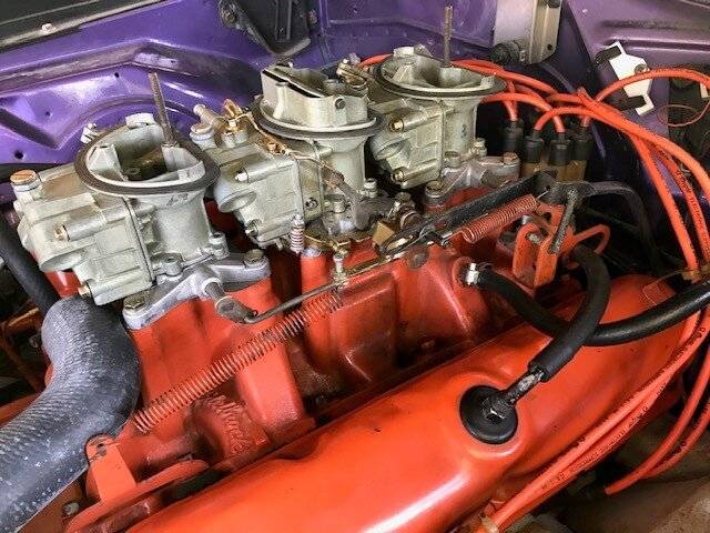

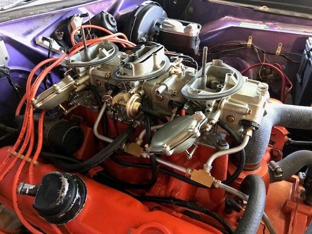

Its been like this for awhile, always rough when in gear and great idling when in park. Wires are correct and vacuum lines are fairly new. I do appreciate any and all help with this problem....

It does sound like a possible vacuum leak. A small leak could cause a stumble at a low rpm, especially when in gear on an automatic trans.
Make sure the vacuum lines are all hooked up correctly. I once had this problem with a damaged intake manifold gasket causing a vacuum leak. A damaged spark plug or wire could also cause this symptom.
Worst case scenario I have seen was a single bad valve. I would also do a cylinder compression test. JMO

Where to start? have you measured vacuum recently? Sprayed around for vac leaks?

Also, my recollection of the vacuum lines from my old 440-6; the line at the center carb base plate goes to the dash pot. The line at the side/metering plate to vacuum advance and the nipple in the middle goes to the outside carbs.
There should not be constant vacuum pull to the outboard carbs. It has been a while for me on this. I would pull up a factory diagram.
