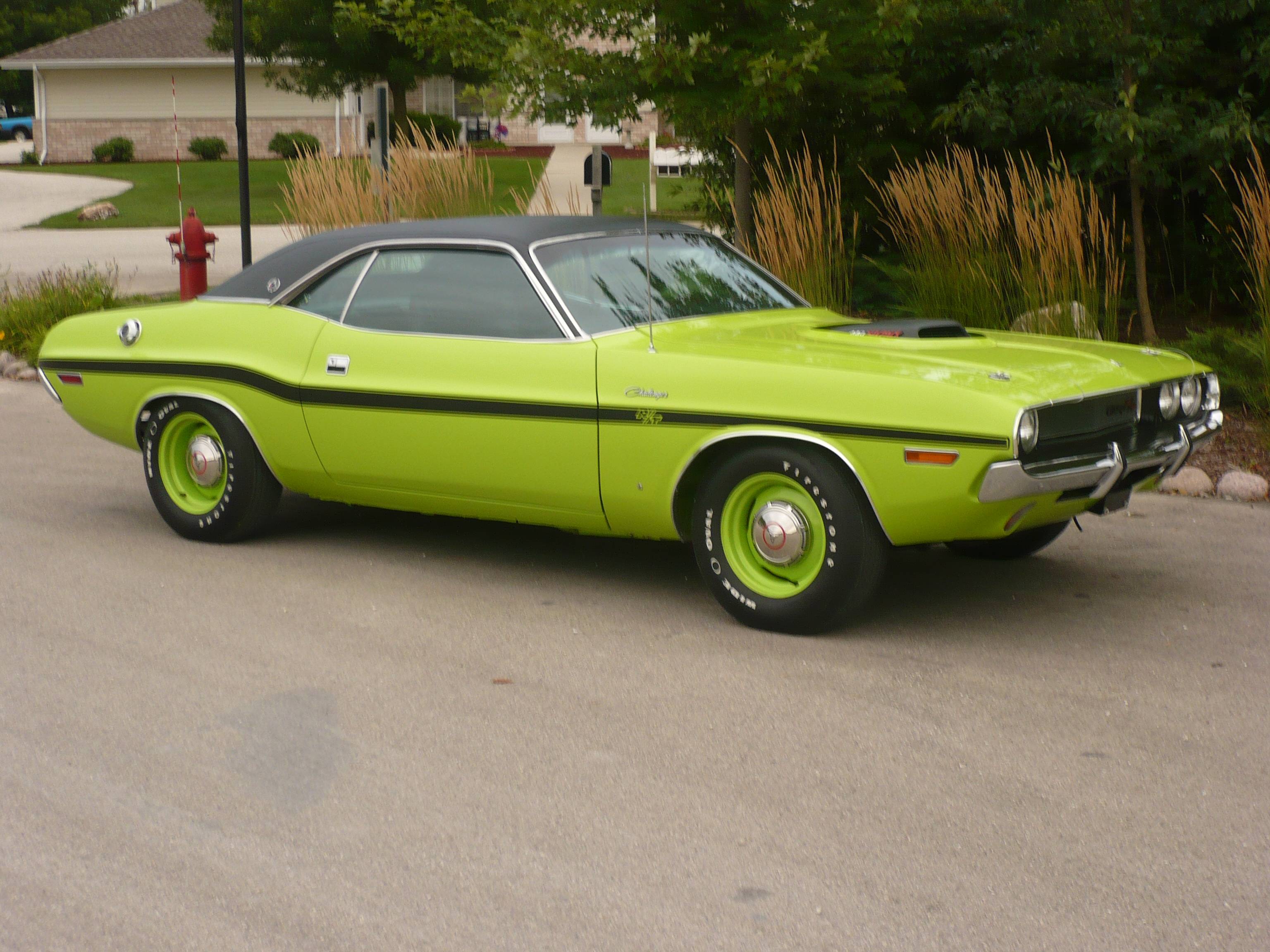

Hey all, new to posting. I have for years read a lot of threads. Great info and input. Rebuilding front suspension, Anyone know where to get the 3 point castle nut for tie rods ? Also. Any pics of front ends restored would be great

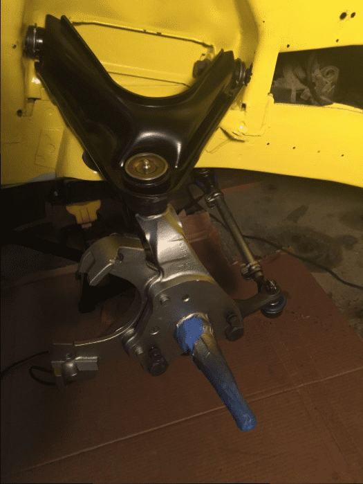

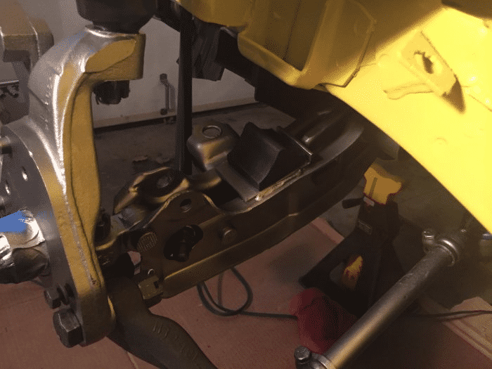

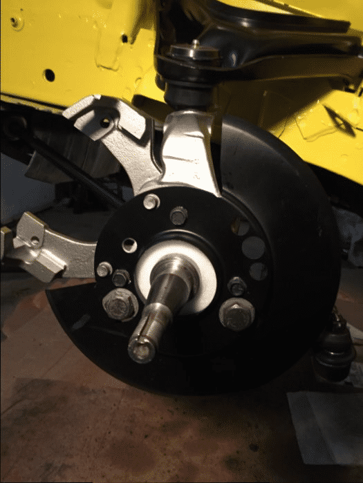

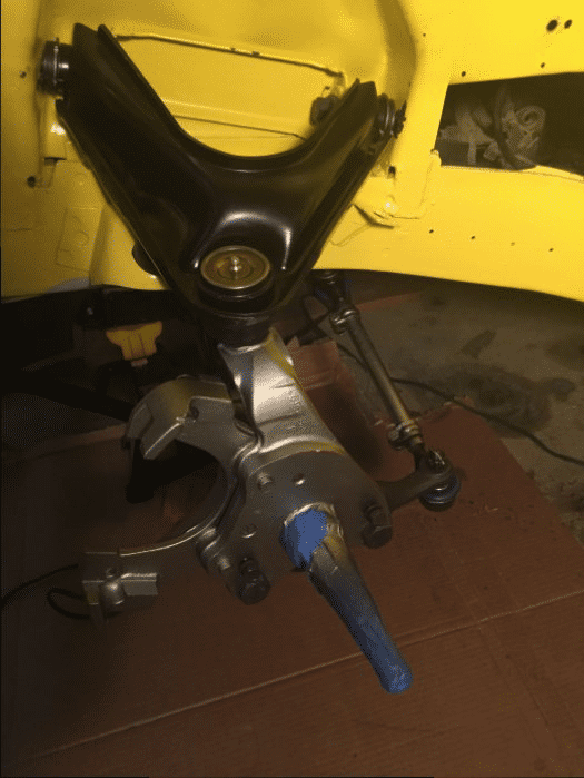

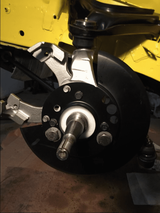

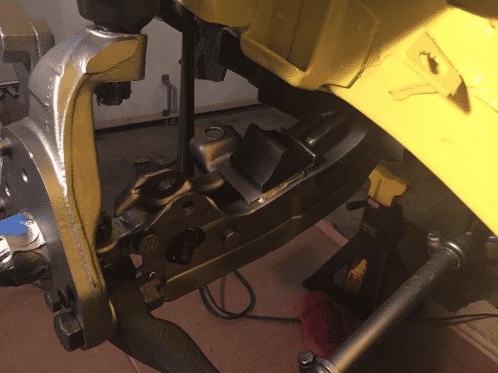

Some pics of my front end rebuild; I purchased new upper control arms, cleaned up the hardware and replaced the tie rod ends, new ball joints, bumper stops, torsion bar screws and other wearable parts;
