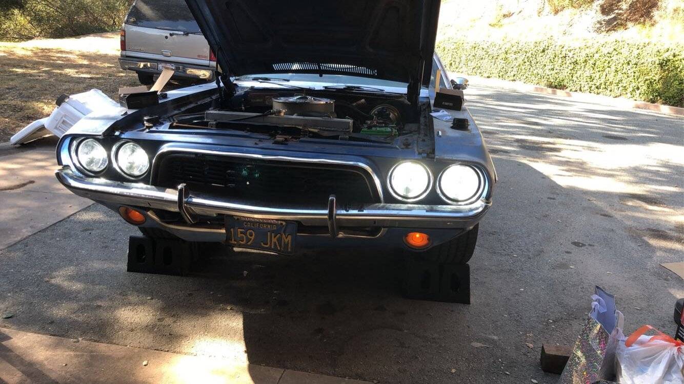

Hey everyone, I have a 72 Challenger that has been sitting for over 30 years. Bought it a couple years ago and just finally got it on the road a few weeks ago. All of the electrical works, except once I turn on the high beams. I have already put over a thousand miles on in the past few weeks (I have a long commute for work lol) and almost half has been night driving. The low beams work great and I have no issues there, but once I turn the high beams on, after a few minutes the headlights will randomly just shut off and then turn right back on a second or two later. This will continue to happen until I turn the high beams off and then the headlights will be fine. I hae replaced the floor dimmer switch twice now which is making me think that is not it. This sounds like a switch problem to me however. Any ideas?

Great! I did plan on doing the relays, but since I have only just gotten her on the road I have been enjoying driving lol. I just put Octane lighting's H4 kit into it last night and it is much brighter. Same issue with the high beams however. I thought it could possibly be a ground? but seems unusual that the low beams work. That is why I decided to ask all of you. Also put LEDs into my gauge lights and it is a whole world of difference. I highly recommend you all do that.

Just installed my LEDs and so far so good! I’d like to fix the underlying problem but I’ll take this win for now.
