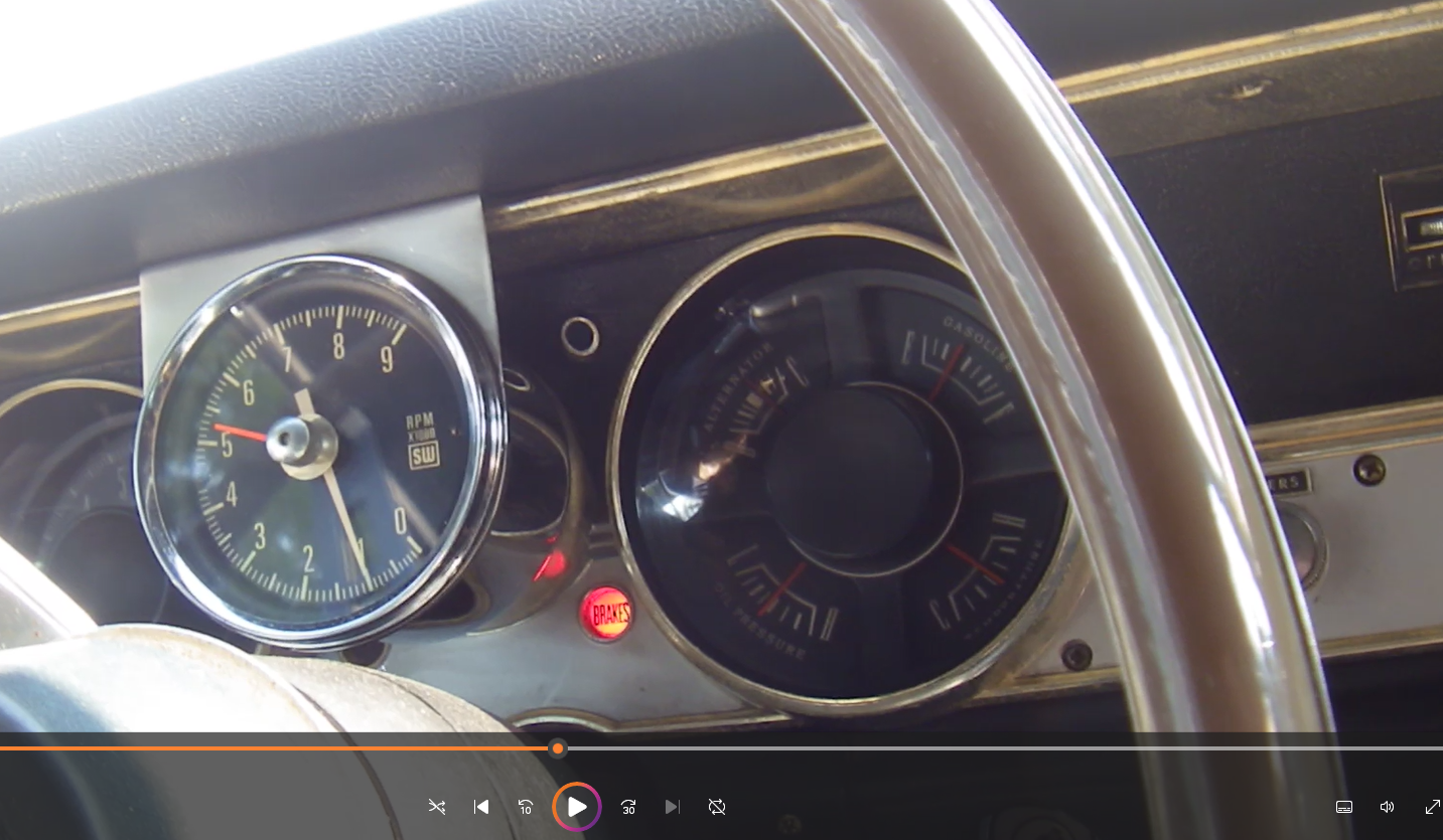

I don’t think it is an aeration problem, but that’s only my opinion based on the condition of the oil when I check it on dipstick after driving and there is no frothy or bubbly appearance to the oil. Also I do have a windage tray installed so they had to be better than no tray.
A bad oil pump can churn up the oil. Oil pick up tube not sealed. Oil sump location to closes or to far. You just have to go through it one step at a time. Pull valve covers, prime see what you have.
Yeah it just sucks to think that I have to remove the pan and windage tray with the engine in the car and how difficult it will be to put it all back in with no leaks. Also if there is nothing obvious after getting into the pan.🫩
Do what challenger rta mentioned above. You just have to pull the valve covers and the distributor. Get a good heavy duty drill and see what kind of pressure you can build.
Yeah planning to do that and I have another oil gauge that I plan to use to see if I get a different reading than the gauge I have been using in the car.
