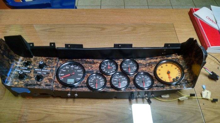

just ordered the speed hut gauges did you use 3.5 inch or 4 doing a wooden sheoak overlay on the laser
My TKO 600 turns up monday full kit with clutch & flywheel whether you will use the second overdrive will be a test & see.
Do you have a pic of your dash would be interested to see did you make it 1 panel including switches or kept the 2 piece.

Austa, I kept with two pieces. I "tried on" several cardboard mock ups to try to optimize gauge placement around my smaller 14 1/2 steerring wheel and long torso. Ultimately went with 4 inch for the Tach and Speedo, and 2 5/8 for everything else. I converted the switch panel to include a manual over ride for my electric fans. I gutted a broken Rallye dash to keep the framework, and then put an abs overlay on it with the holes cut out to support the gauges. Then the copper veneer overlay followed by the gauges. Just installed yesterday so no finished dash pic but here is the two panels.

Looks great ,the fan switch is a good idea i use a turbo timer set to 5 mins to allow the engine to cool a bit

I am using a Dakota Digital controller with preset triggers but since overheating is the number 1 issue on power tour, I always have built in redundancy in case the controller fails. Still remember my first tour when every hotel had several cars each nite changing rads and fans!
