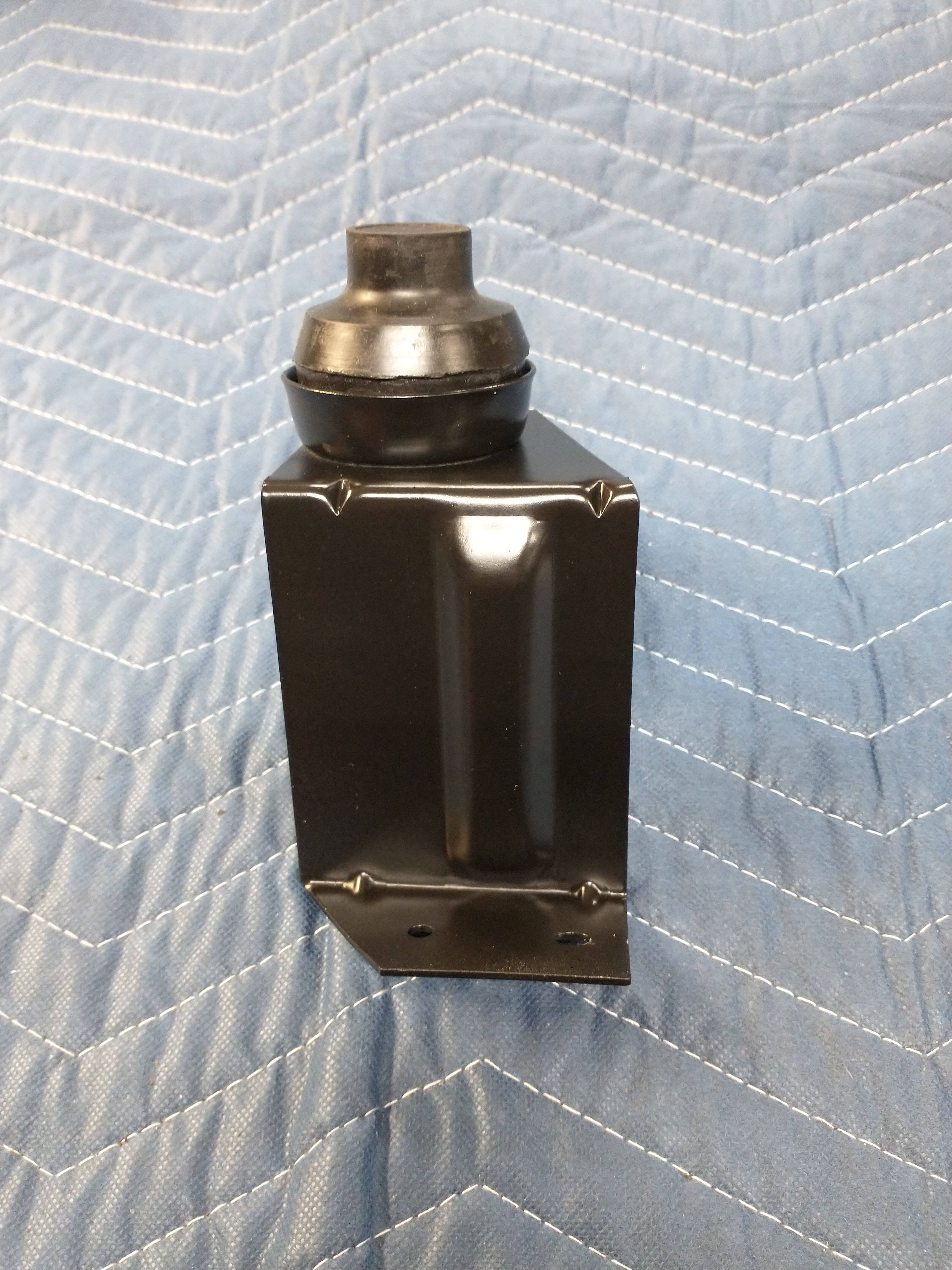

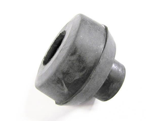

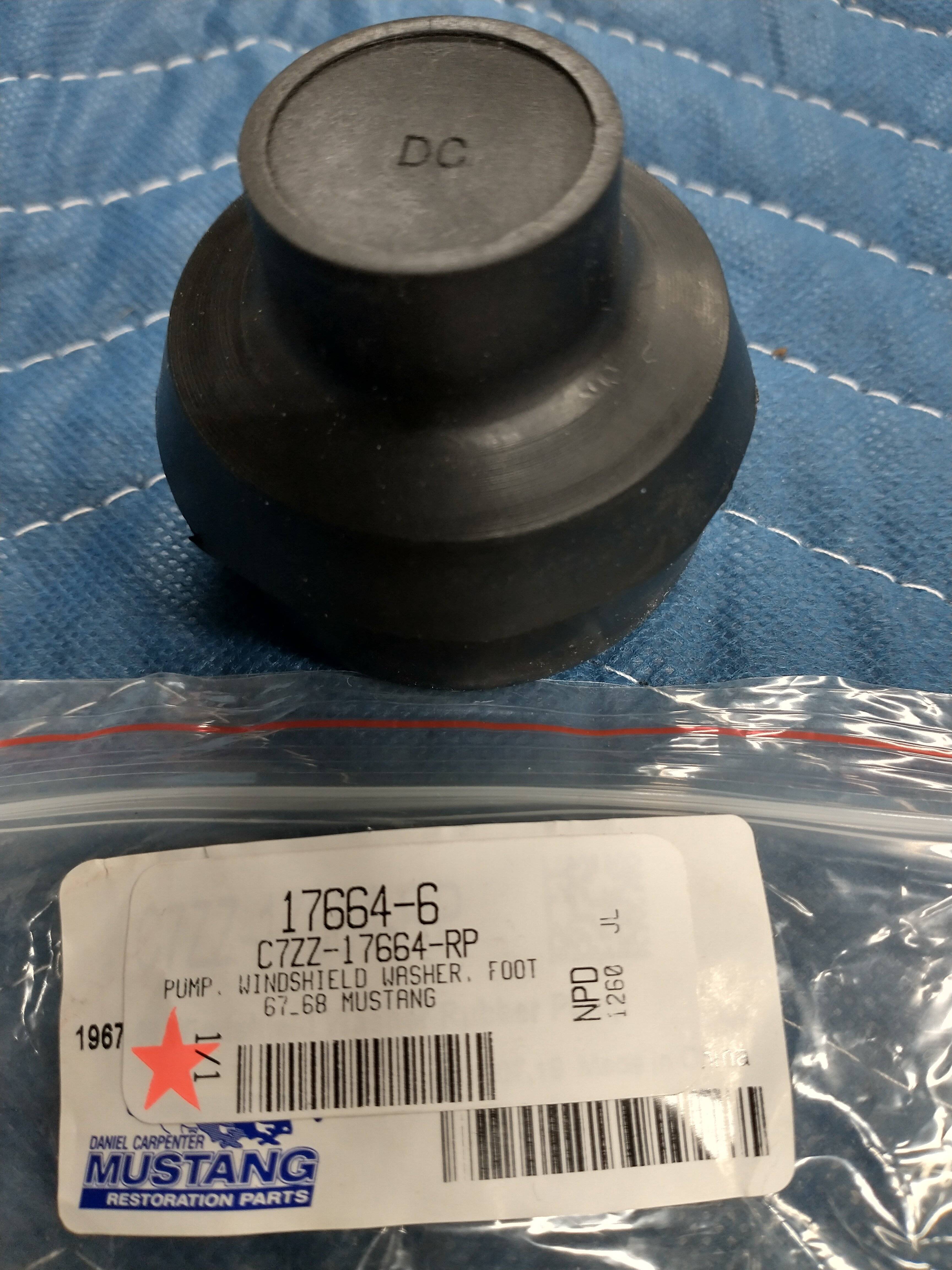

Also, does the Ford replacement rubber fit a Mopar pump? Below is the one for sale for a Mustang.

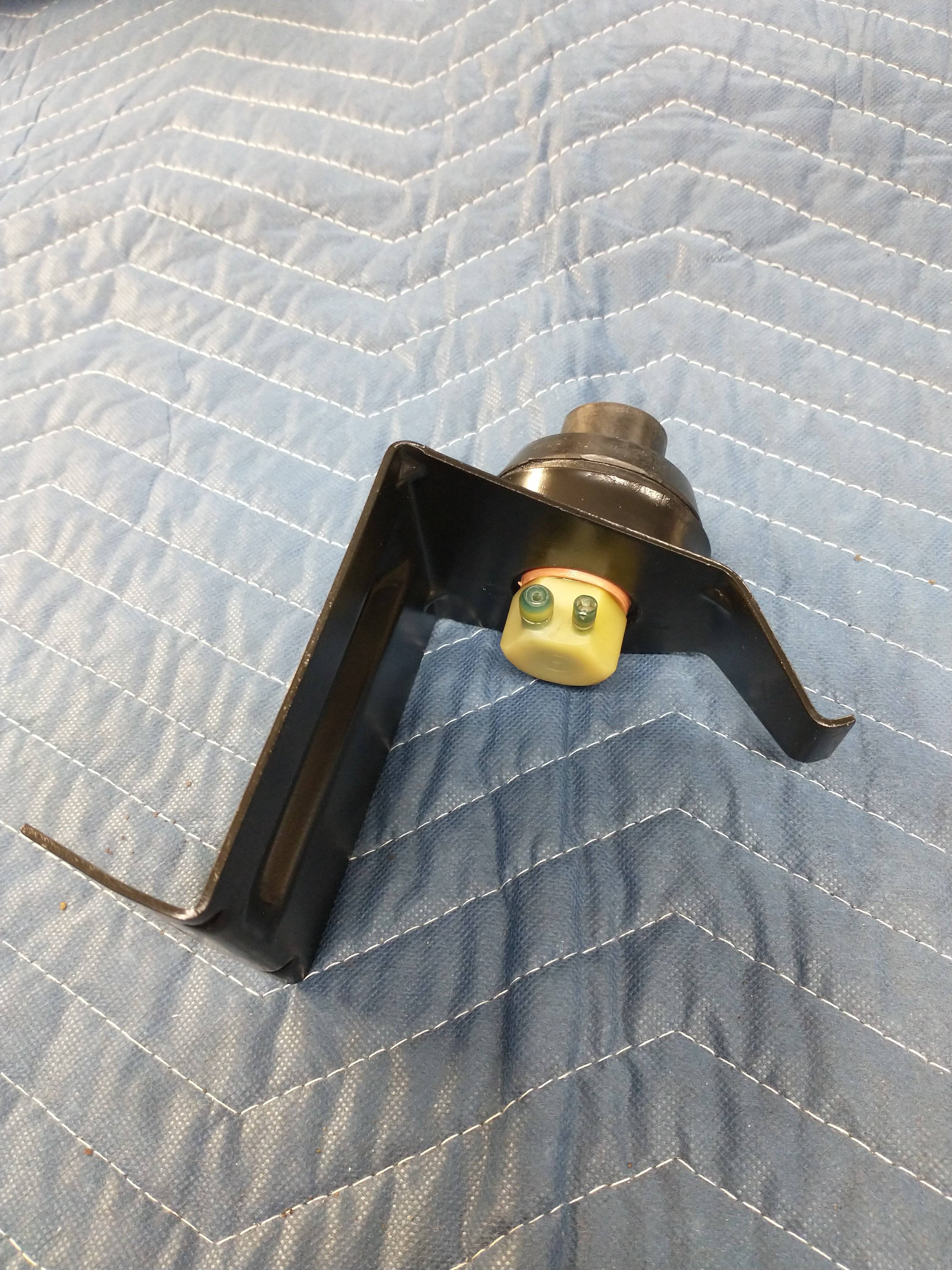

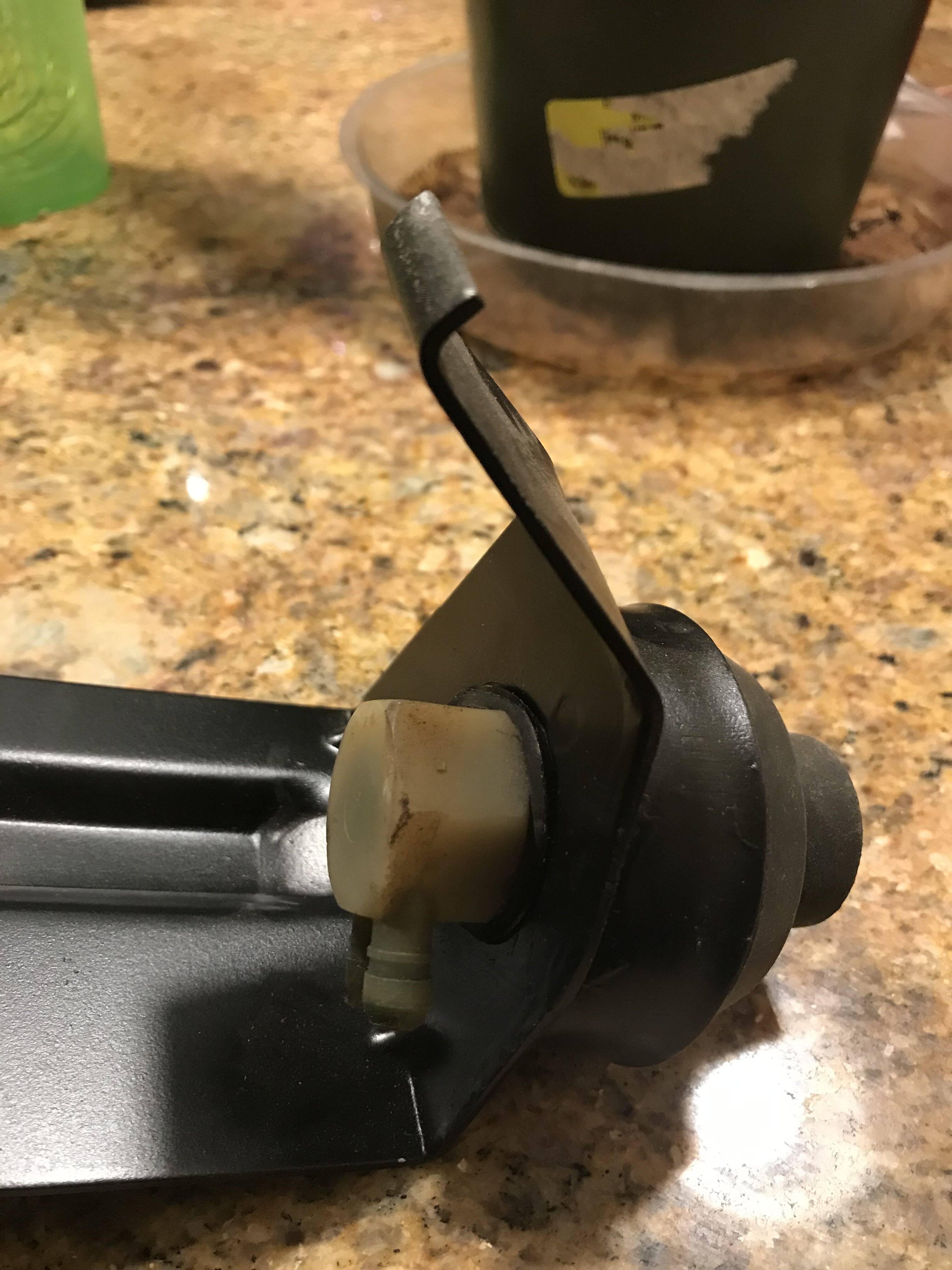

Here is a picture of my pump out of my 71 Barracuda. Looks like the one end of the rubber bellows feeds thru the hole of the bracket and the plastic fitting is most likely glued or threaded to seal it. I guess it is possible that the bellows fits over the top of the fitting that extends through the hole of the bracket.

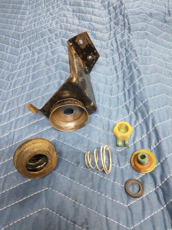

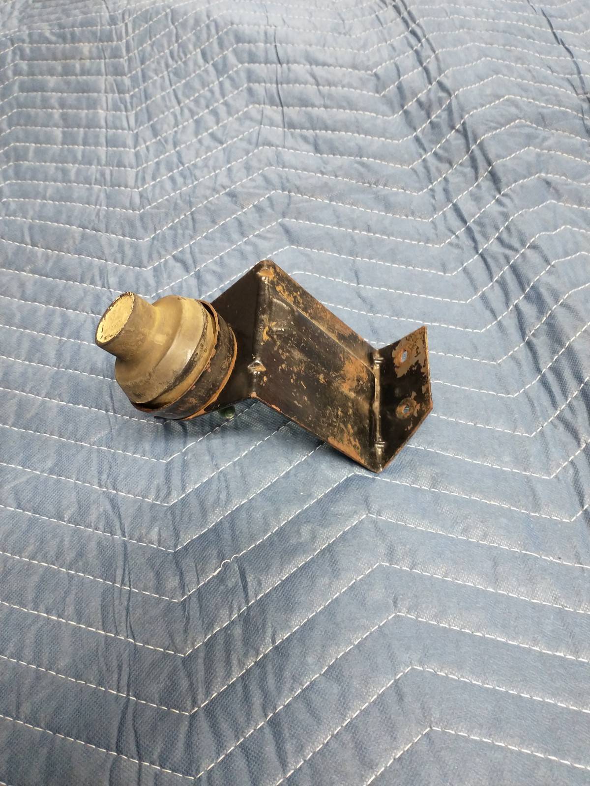

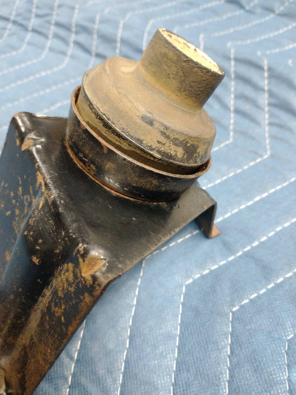

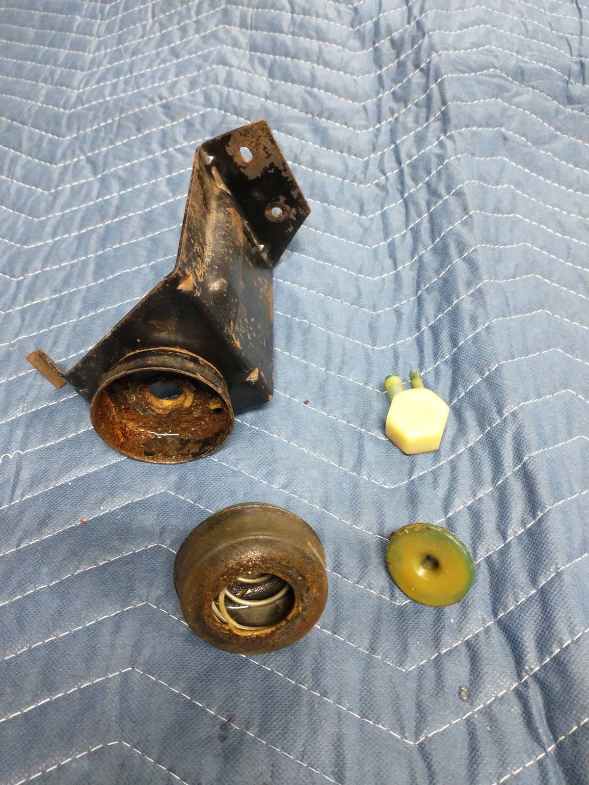

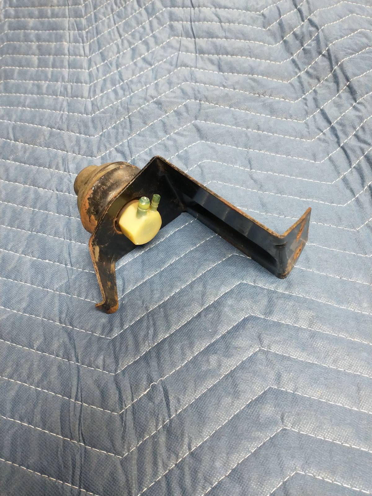

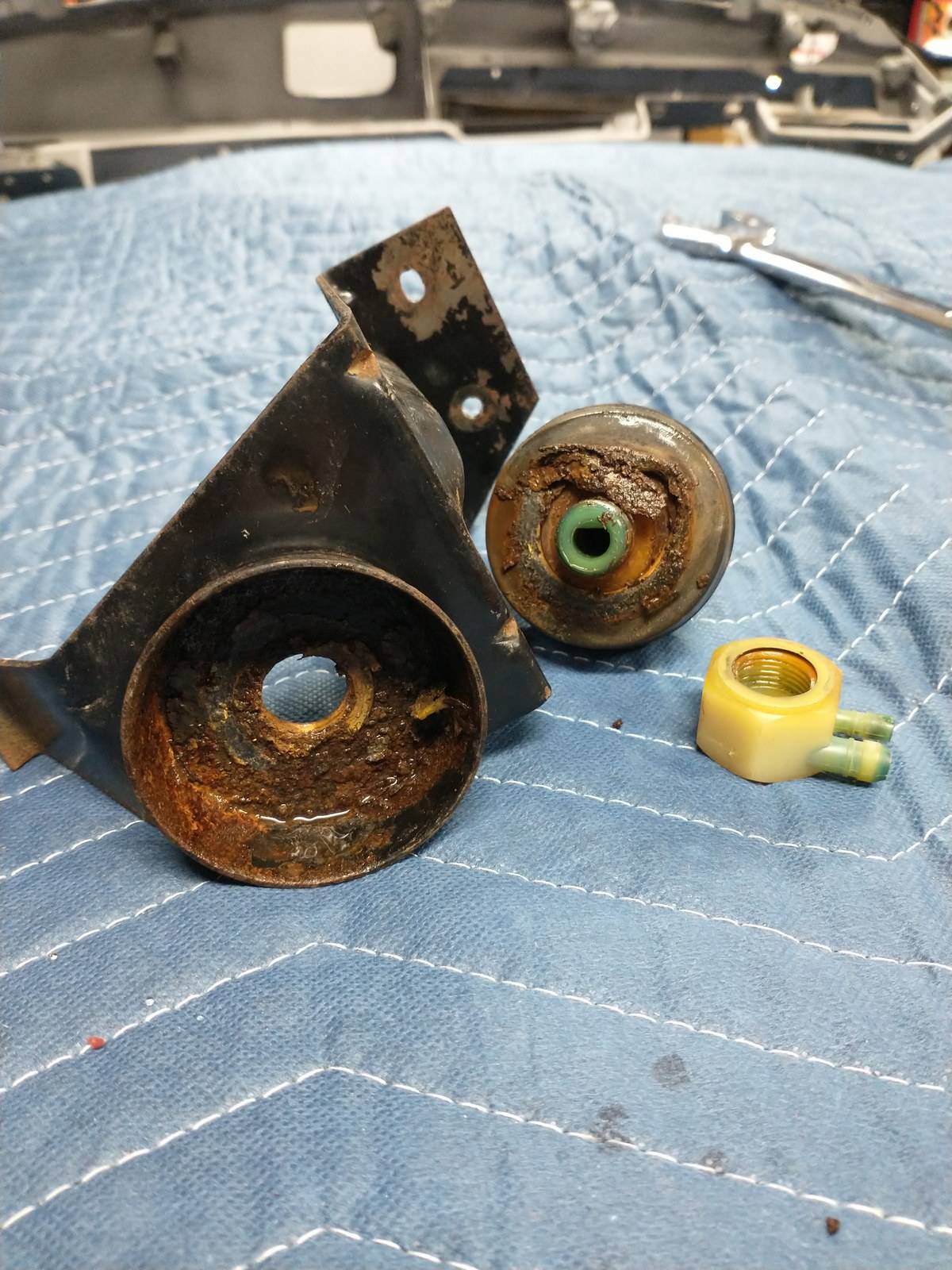

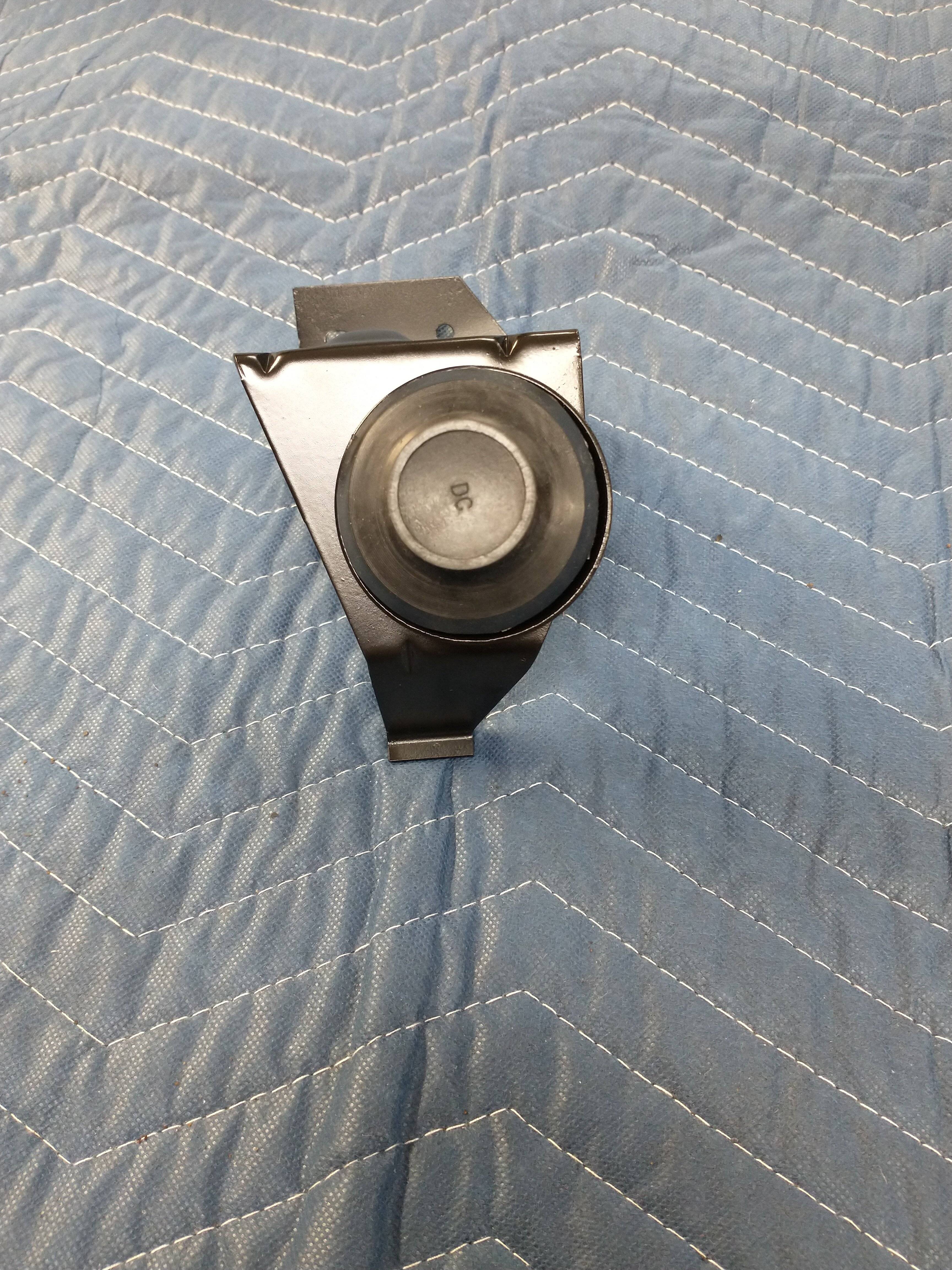

I took a chance and unscrewed the plastic valve using a 1" wrench and it didn't brake; Thank God!
The rest was easy.

Nice! I just wasn't willing to take mine apart as it still is functional. Since the parts are plastic, they probably will come apart because they are not rusted together.

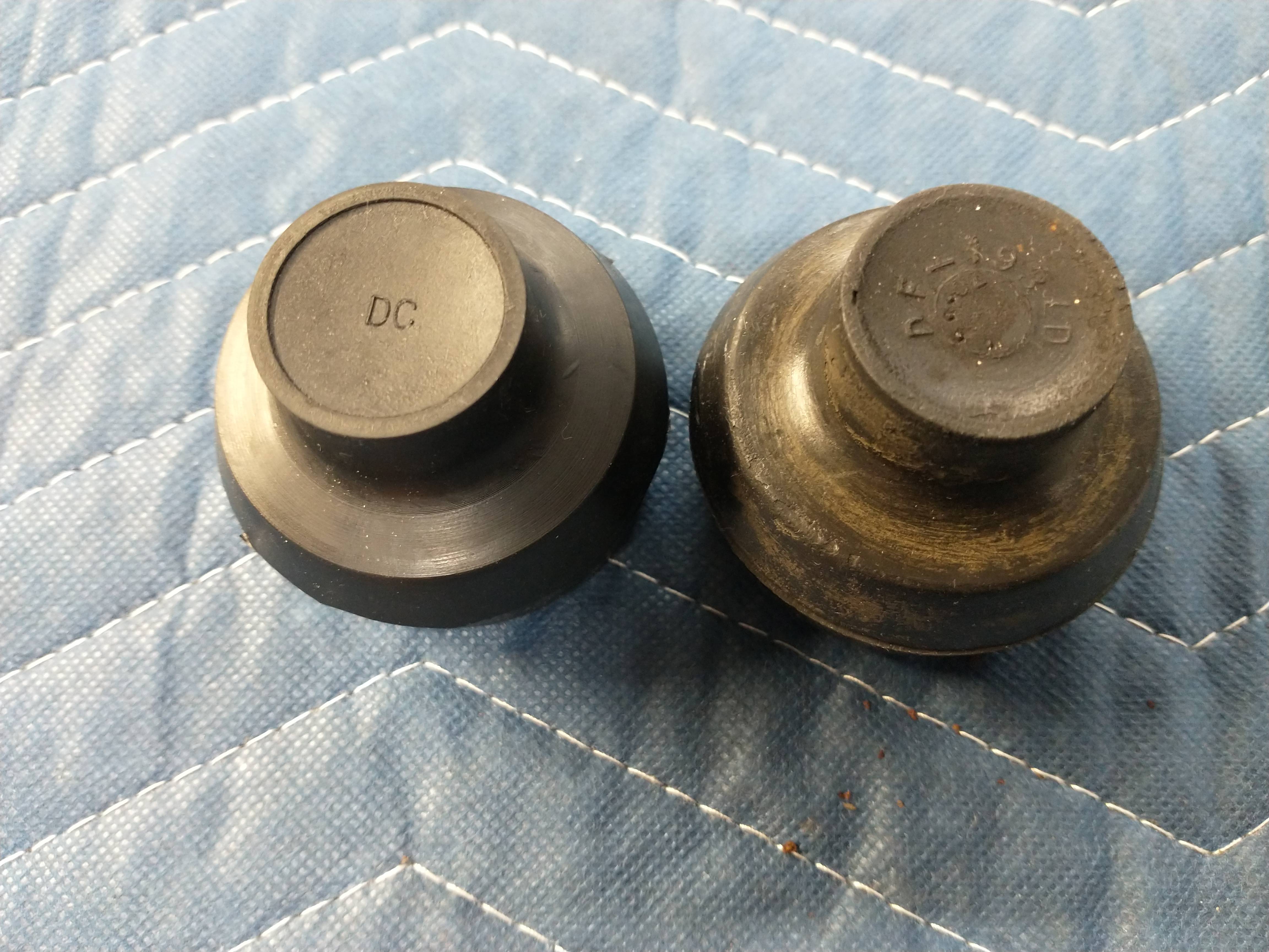

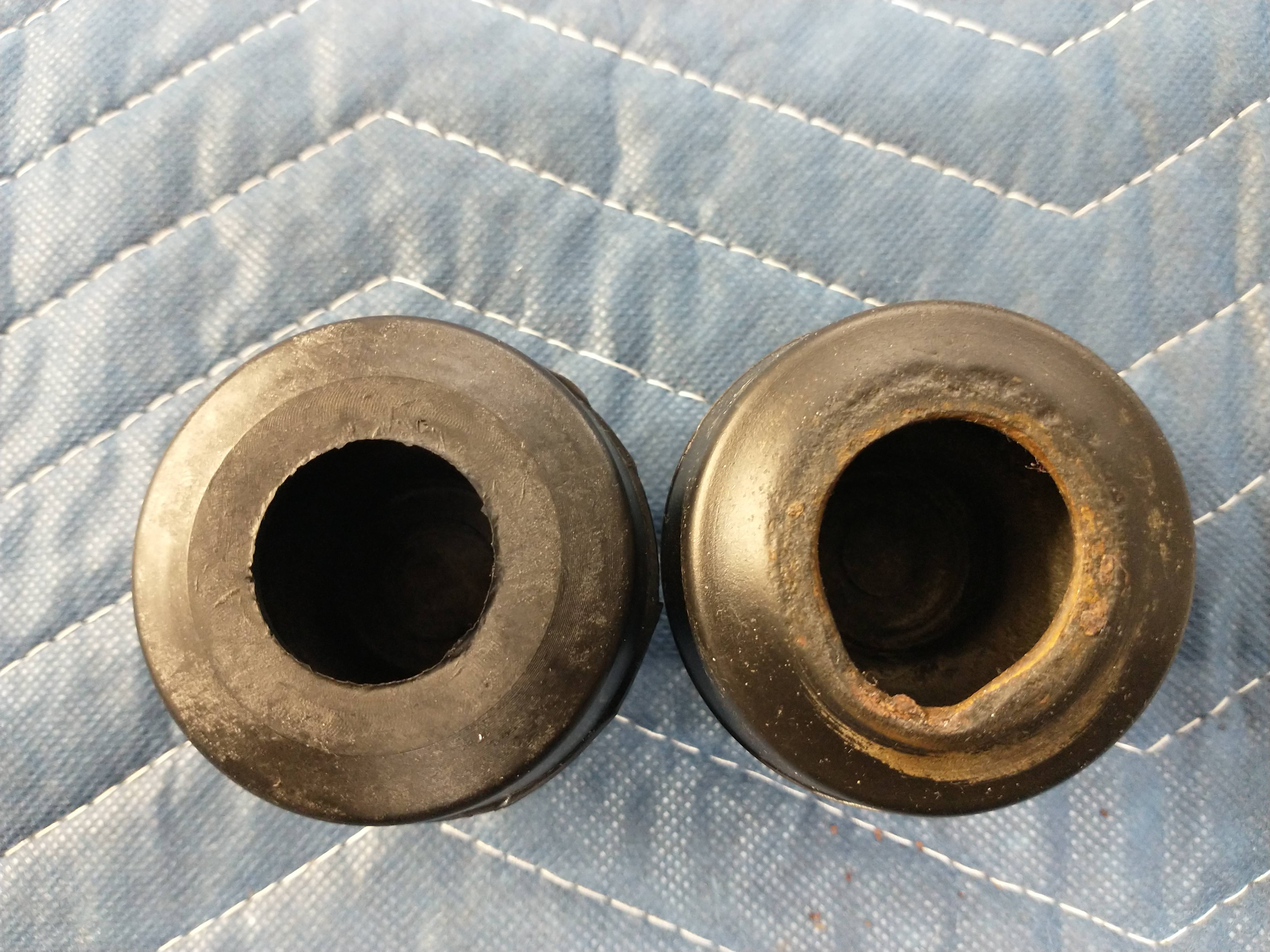

I ordered the replacement rubber for a Ford Mustang from National Parts Depot. I'll come back and let you know how it fits. Fingers crossed.

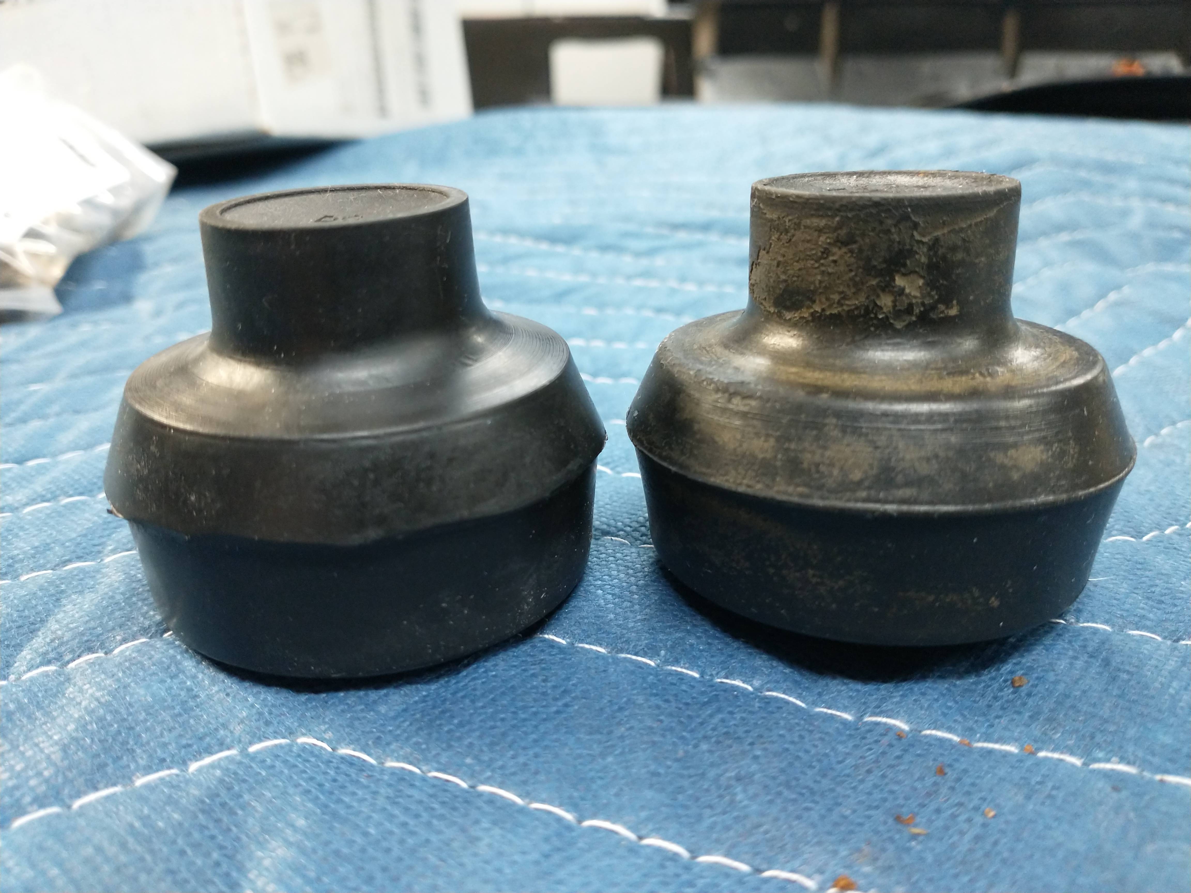

I received the rubber part from National Parts Depot and finished reassembly of the manual washer pump. I used a garden hose gasket and a bit of silicon grease on the plastic threads and under the rubber as it is self-centering. I left a review on NPD letting them know this is exactly the same rubber part as the Mopar uses. So, maybe they will list it for Mopars in the future.
