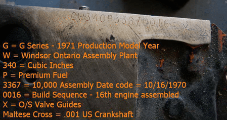

    David, look for a number on the driver's side of the block, front, right below the head. A 70 engine would start with F.
    A 71 engine would start with G. The next letter is where the engine was assembled, followed by the cubic inches engine size.
    Check out the link I posted above; it has actual pictures of number ID locations
    "How to ID a small block engine block"
    It will give you all the information you need with photo locations

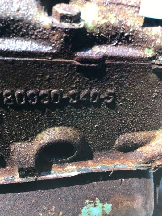

    It's cast into the Left-hand side of the block - large numbers - basically behind the starter. You can read it with a good light and a mirror, as necessary. Either 273, 318, 340 or 360 will be displayed - then a dash (-) and single number.
    ie: The 340 casting number will be 2780930-340-3.

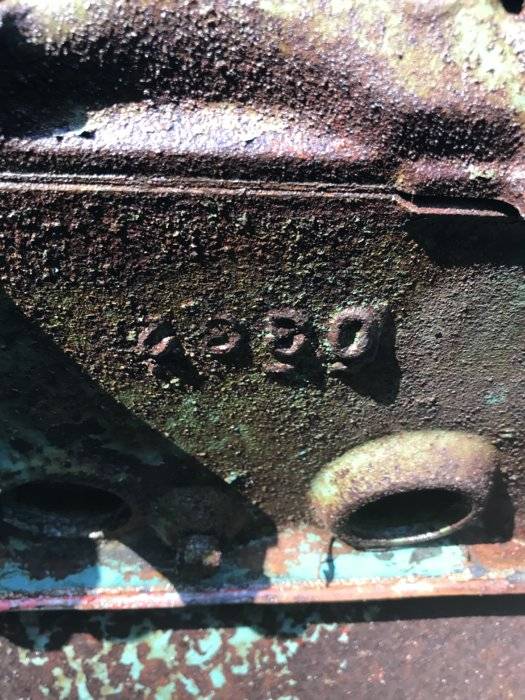

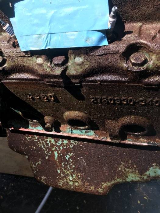

  10. Edward Hackett
    Edward Hackett Member
    Messages:
    21
    Likes Received:
    7
    Joined:
    Feb 1, 2020
  11. Edward Hackett
    Messages:
    21
    Likes Received:
    7
    Joined:
    Feb 1, 2020

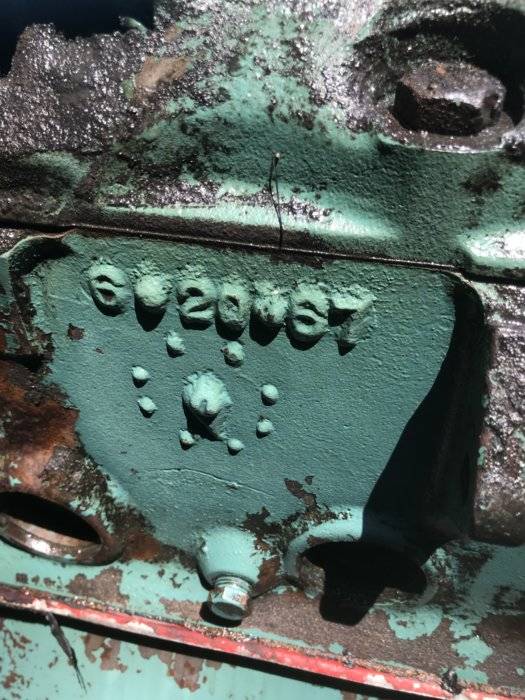

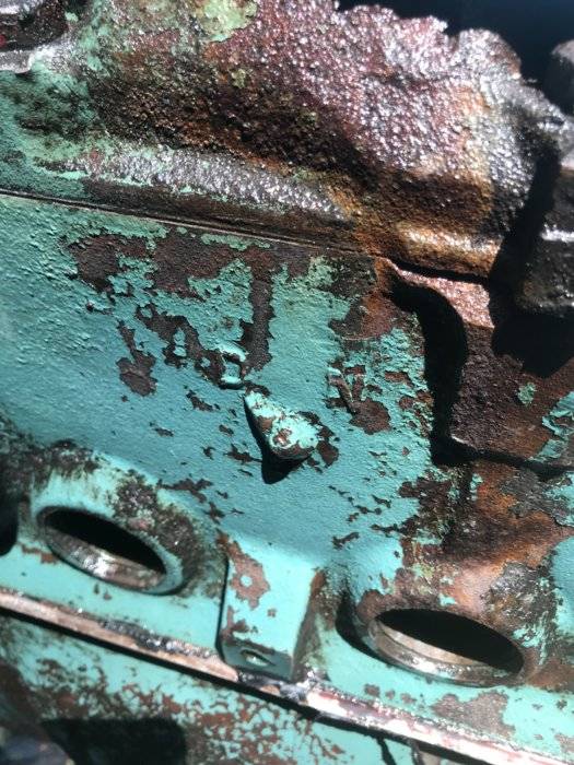

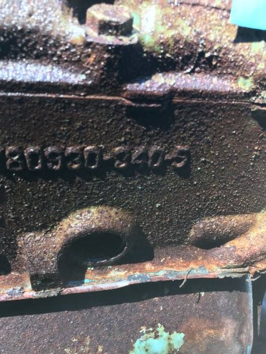

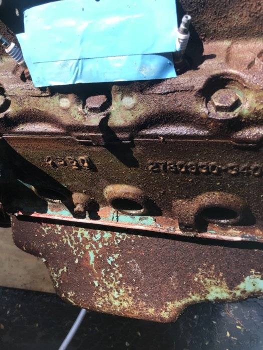

    My 1968 340.
    All Mopar small blocks are similar.
    • Like Like x 2
  12. Edward Hackett
    Messages:
    21
    Likes Received:
    7
    Joined:
    Feb 1, 2020
    The last two photos are the casting date, and even what shift cast it at the plant.
