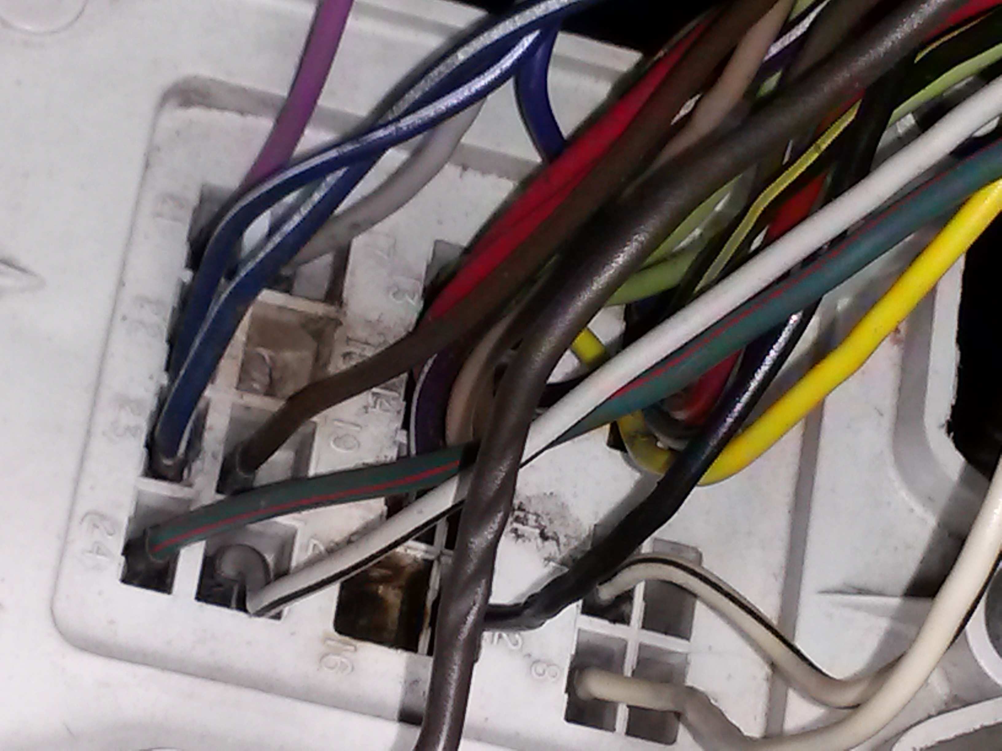

I have this same problem with my 71 barracuda and believe it is the ignition switch. I have had original switches fail the same way. I believe the problem is that when you rotate the key against the return spring it tries to push the body apart and causes poor contact on the start contacts when you release the key the contacts return and the run contacts connect allowing the car to start.

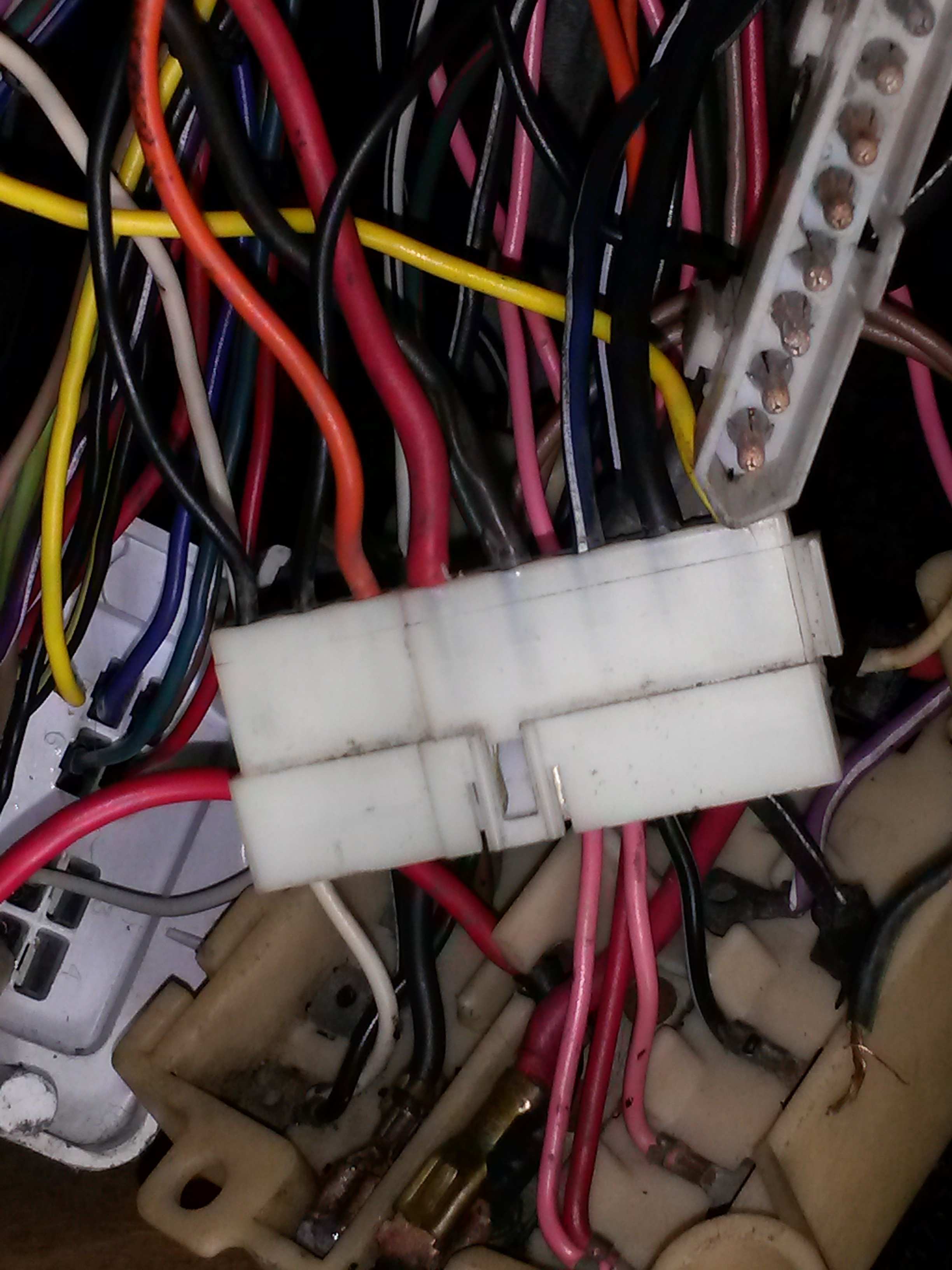

I have had intermittent problems with aftermarket ignition switches at the connector. I usually pull the connectors and squeeze the ends to make a tighter connection.

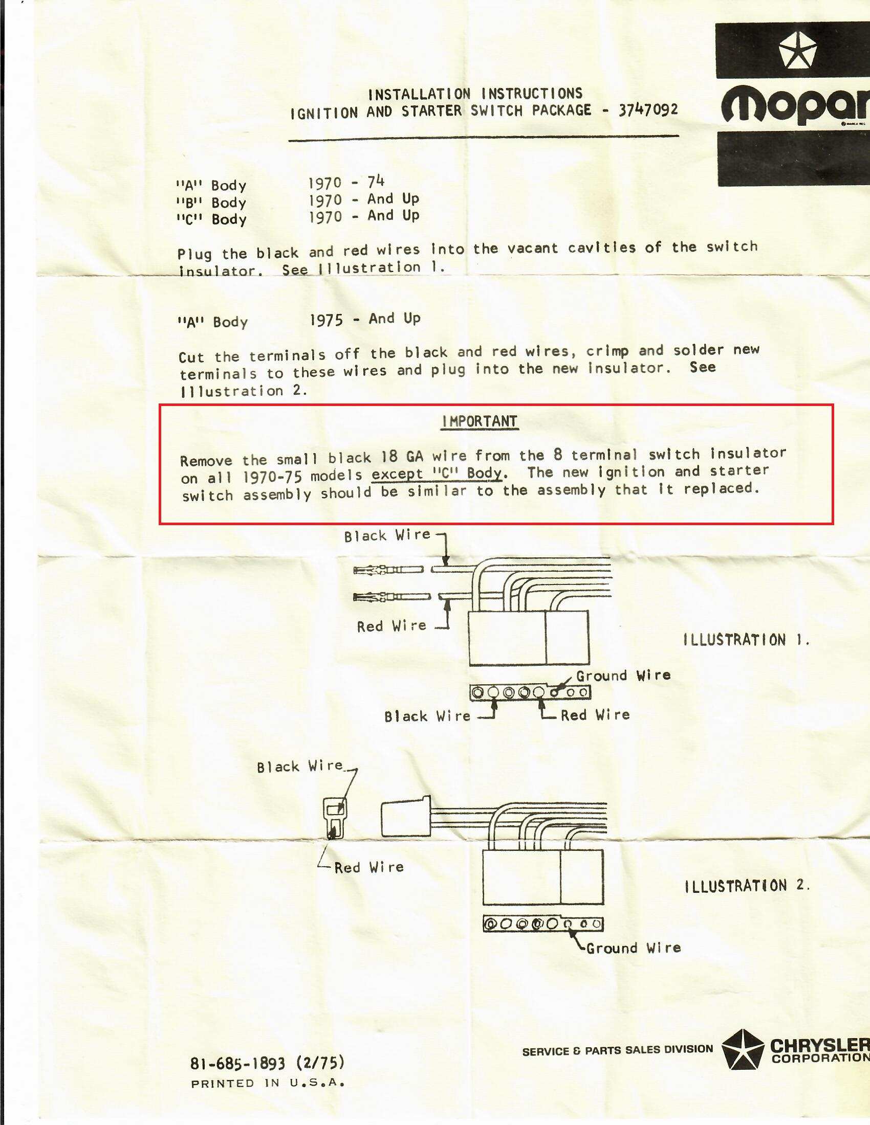

Some cautionary notes on the later replacement switches with the extended battery feed and accessory leads. May want to consider replacing the Molex connections altogether, replace with something that can handle the current.

72RoadRunnerGTX has presented this before. It would be advisable to change at the least the extended battery feed and accessory leads.​
The other connections usually are not a problem because they are low current carrying circuits. But they can corraded and come loose over time.
This is the link for the connectors. https://powerwerx.com/anderson-power-powerpole-sb-connectors

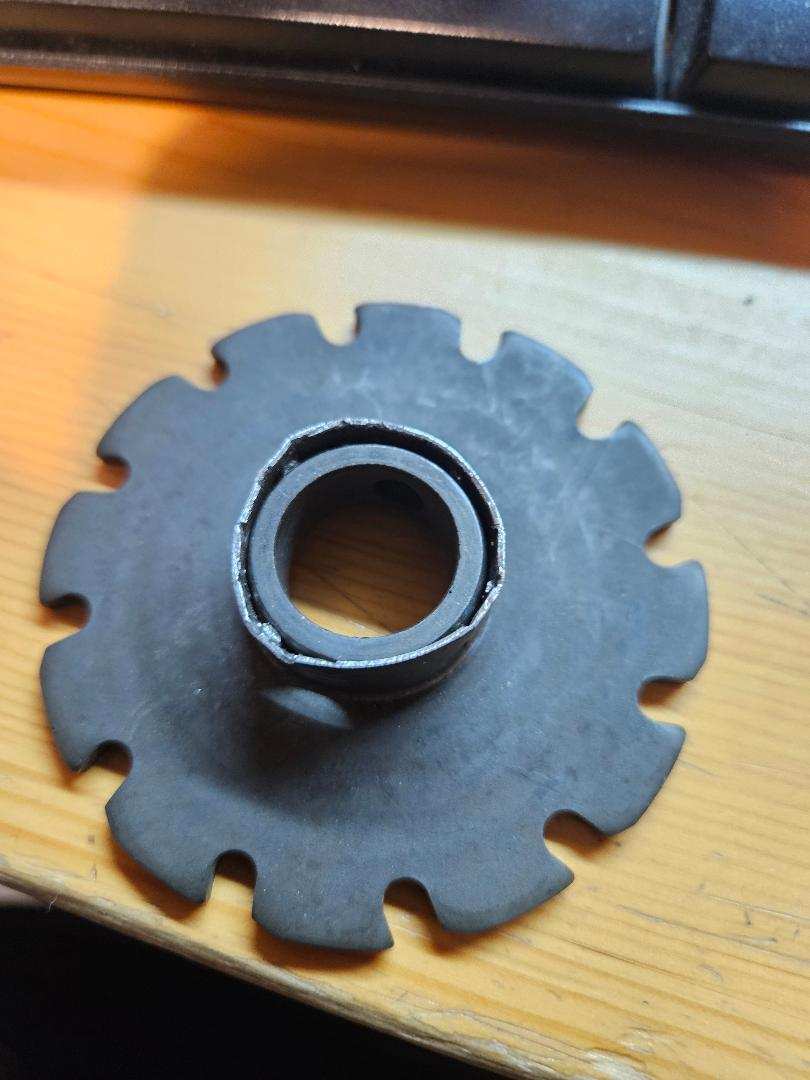

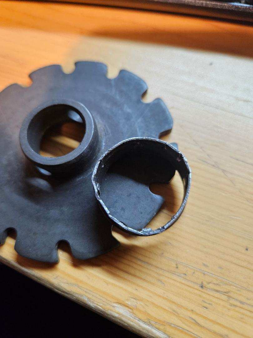

OK well the new switch DID NOT fix the run problem... oh my gosh, now what? In fact, the two switches looked pretty close to identical, so the old one may have been a Standard Motor Products also! Most trouble I had was realizing I needed to remove the outer sleeve on the locking wheel, prior to being able to get to the pin to knock it out! So, back to square one!

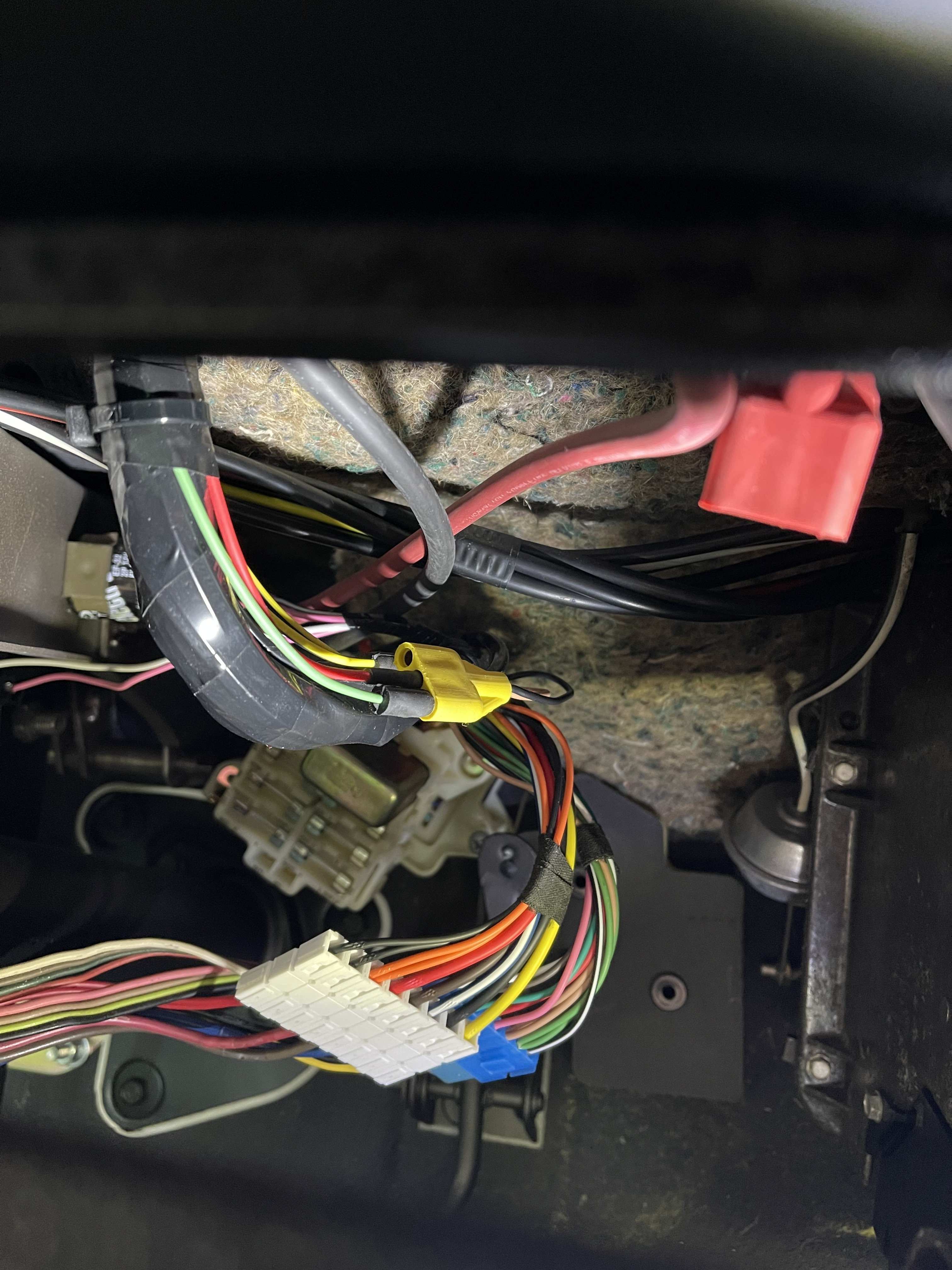

In any event the connections need to be checked.

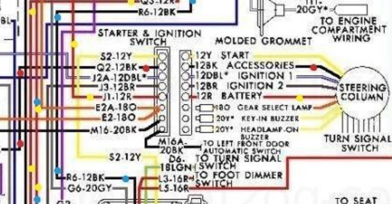

1 1st check what you did last. Install of ign sw.
2 Check molex connector with test light. While cycling thru the functions.
12Y start Energizes starter relay
12BK ACC
12DBL IGN 1 RUN Feed to ballast resistor.
12BR IGN 2 Start Feed directly to coil.
12R Battery Feed to the ign sw that feeds every thing that is switch. Not likely the problem but check for loss of power.
Check connectors on both side of the molex .

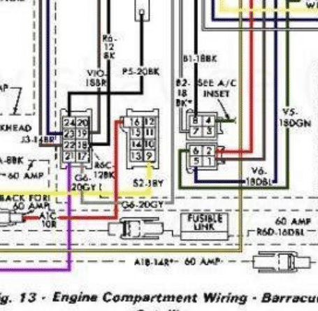

Next the bullhead connector. 22 and 23. check both sides of firewall.
This is a process of elimination.
Hear again don't forget about the ground when you get through it.

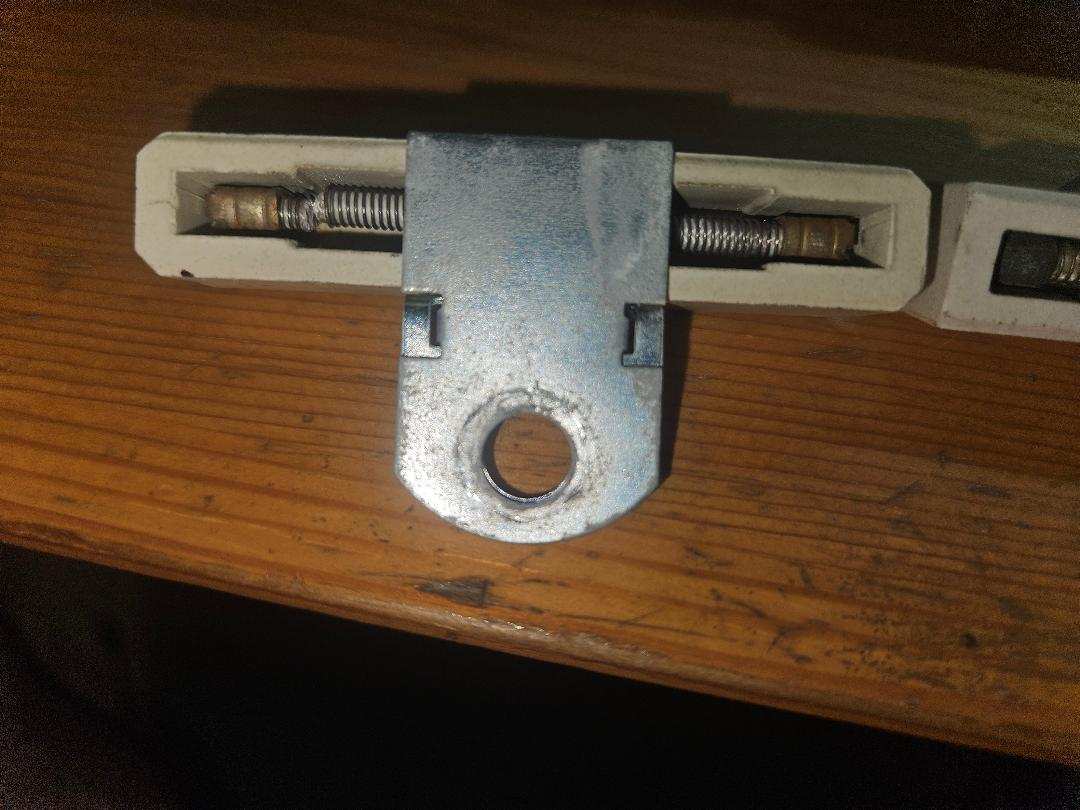

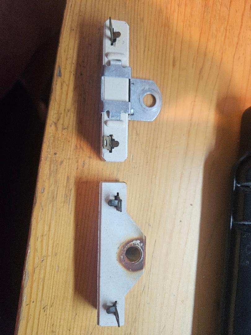

I will absolutely recheck my steps and make sure I jump out the ballast resistors. I'm wondering, are those even needed with electronic ignition?
Oystercopy
Jul 25, 2019
127
37

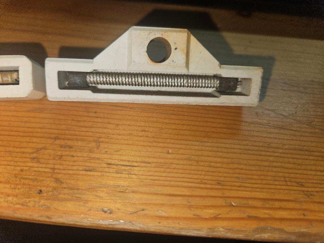

OK, jumped out both ballast resistors; no change. To answer one of the questions here, the engine cranks, but never starts, regardless of what position the key (ignition) switch is in. I am going to remove the resistors from the firewall and look at them to see if any of the coils are broken. They definitely look old. A buddy told me that he wasn't sure you could bypass them the way I did, which was to make male-ended jumpers and put those inside the harness connectors (without it connected to the resistors at all).
Question: will having the resistors disconnected entirely be the reason it won't start? Do they HAVE to be connected and jumped out, or is simply jumping out the harness OK? I realize I don't want to run the motor for any length of time or the coil might burn up, but I just want to see it run.
