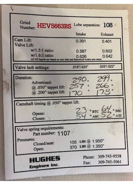

    Cam specs?

    Is it manual or auto? I tend to think it’s a bit much but, with a stick you can get away with it. The cam is tell tell though.
    If not over .509 lift, you’d probably like a 750 or 780 w vac secondaries. IMO

    It's a 4spd... I attached the cam card

    I see, nice! I know that sounds great. Personally I think it handles the 850 just fine. Are you feeling a lull or bog on the lower end?
