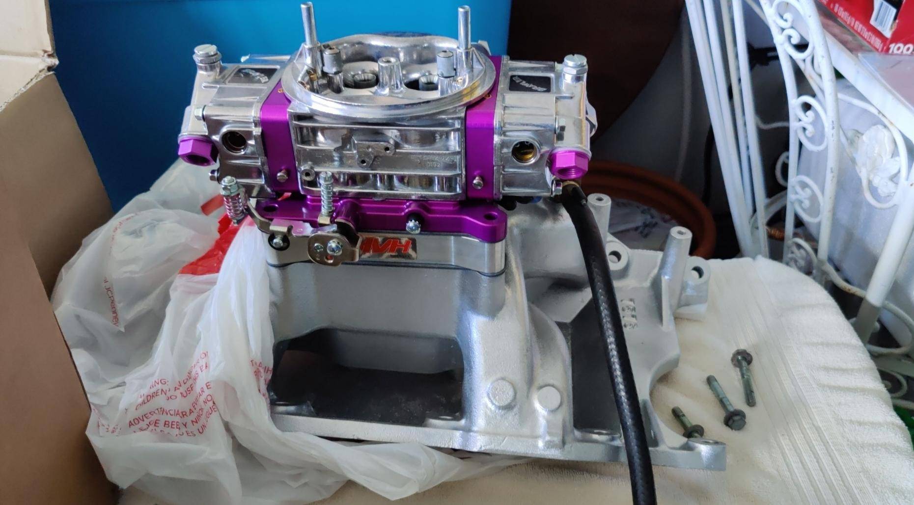

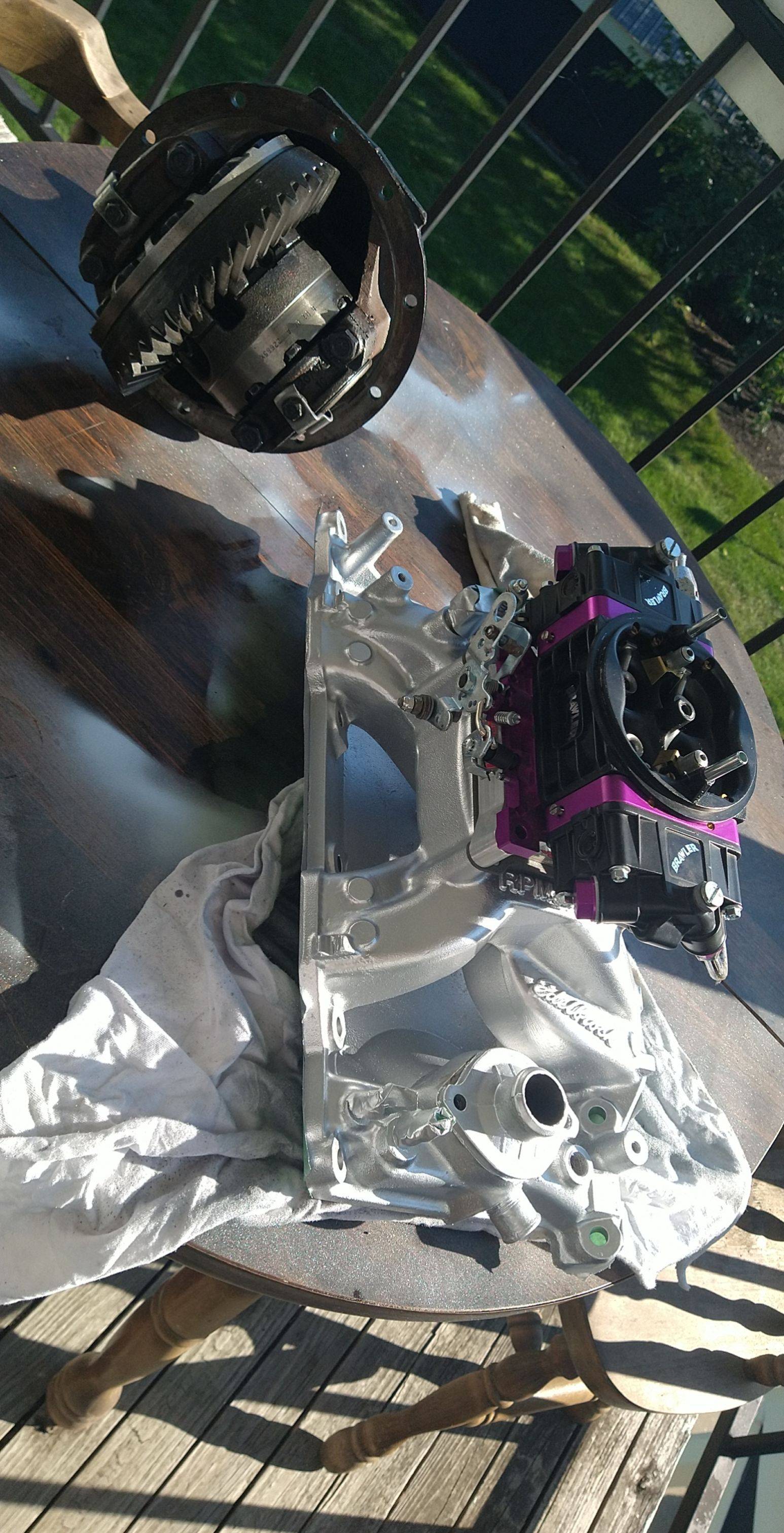

So I just rebuilt a 73 340 my goal was to have some drivability but still make some good power 450hp is my goal. I really don't want to add nitrous or any type of boosted application looking for a naturally aspirated option.
My current build
New eagle crank ( stock stroke )
Sealed power Pistons 10 to 1 compression
Ignition system is an RT garage revenator with their distributor and coil currently have the rev limiter set at 6000
Intake is an Edelbrock air gap ported by huge engines

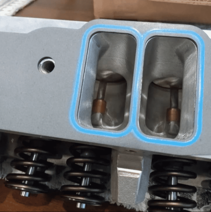

Heads are in Edelbrock RPM 63cc full CNC ported by Hughes engines they flow just under 300 CFM at 500 left
1.6 prw rockers
750 ProForm racing carburetor mechanical secondaries no choke
HVH 1 in spacer
Cam is .539 intake and 549 exhaust duration at 50 is 236
Lobe separation 107
cope racing transmissions 904
Ptc torque converter with a 3000 RPM stall
The rear is an 8 and 3/4 I have two center sections 2.76 and 3.91 both are sure grips Dana power lock. 3.91 currently in the car
I know that I would benefit from a much larger cam and I know that I would also benefit from a higher compression ... I just wanted to stay away from race fuel and keep a camshaft that's somewhat streetable. Do you think this combination is good enough for a 450hp horsepower goal? Without milling the head or a larger cam ?

They could actually get my heads to flow over 300 CFM but they required offset rockers and I already had brand new 1.6 prw rockers they sell the offset ones there would have been an extra $800 it was hard to justify because I just spent $1,400 in head work with the 208 valves I could have them milled down further to gain compression ( at extra cost) but I'd really like to avoid race fuel... Hoping it would be enough for my hp goals ... Maybe throw the 276 center section in for cruising then pop in the 391s for when I go to the track.

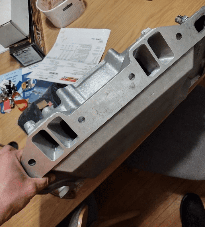

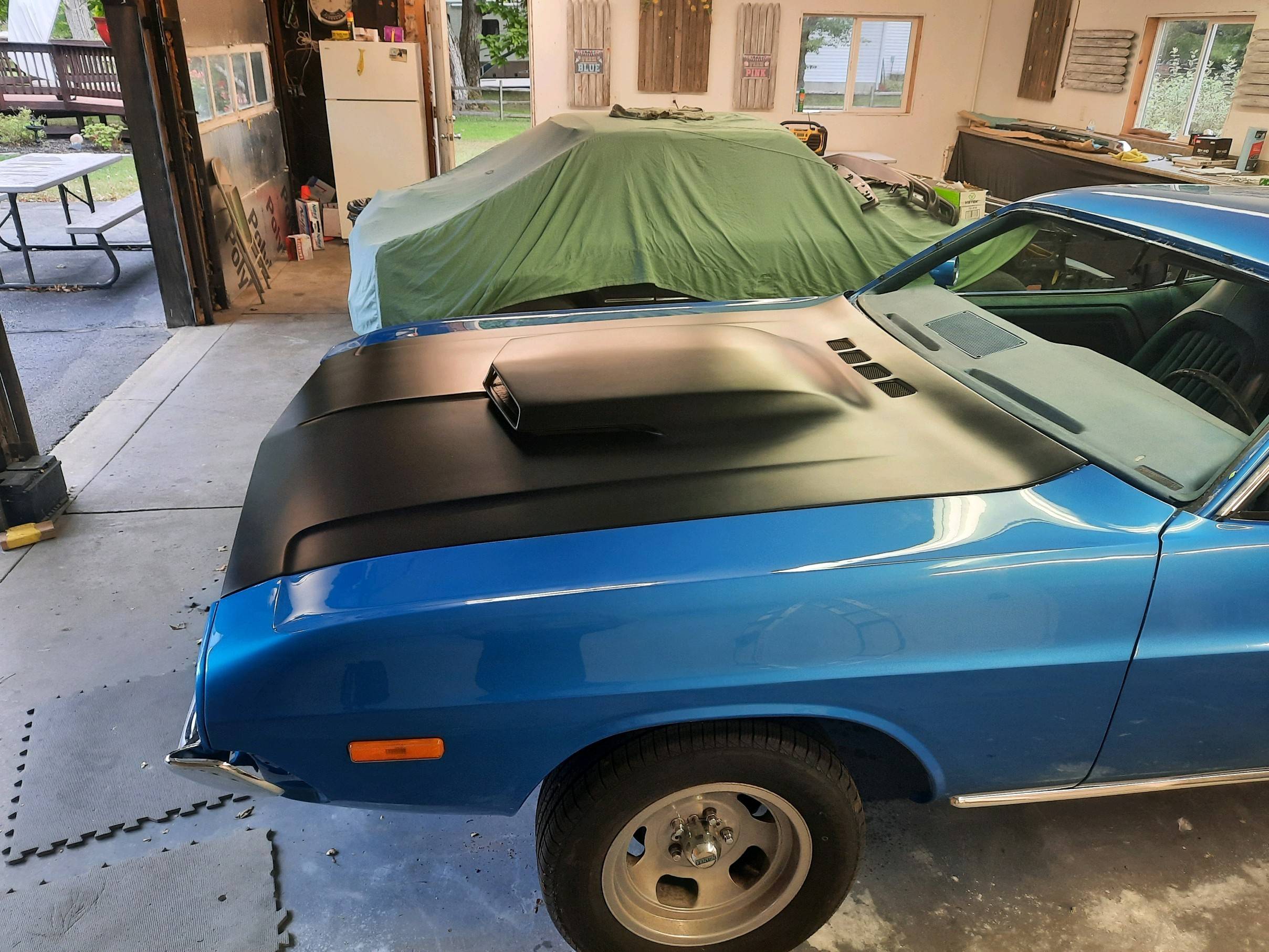

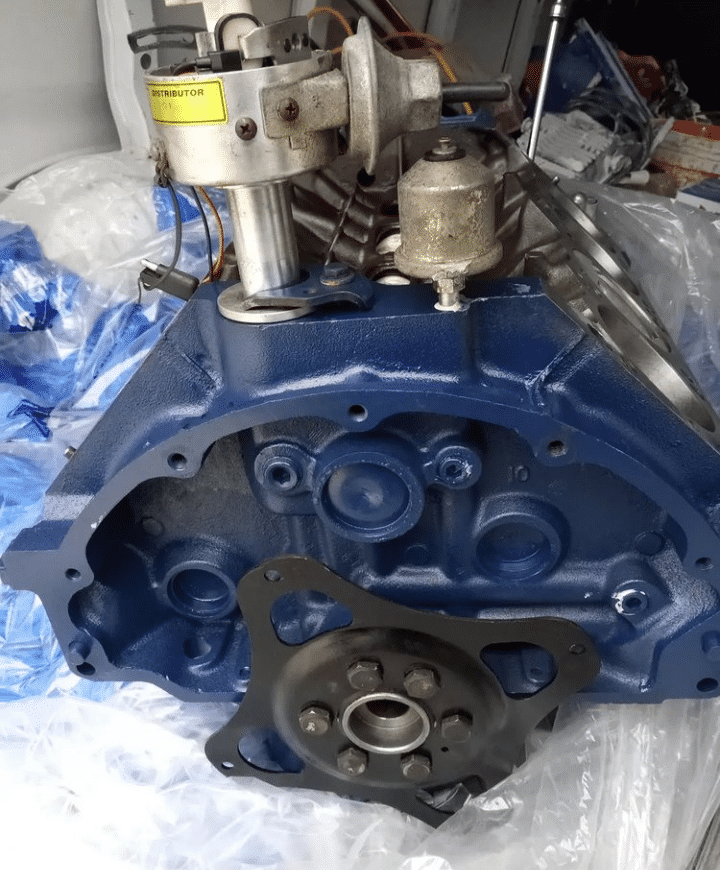

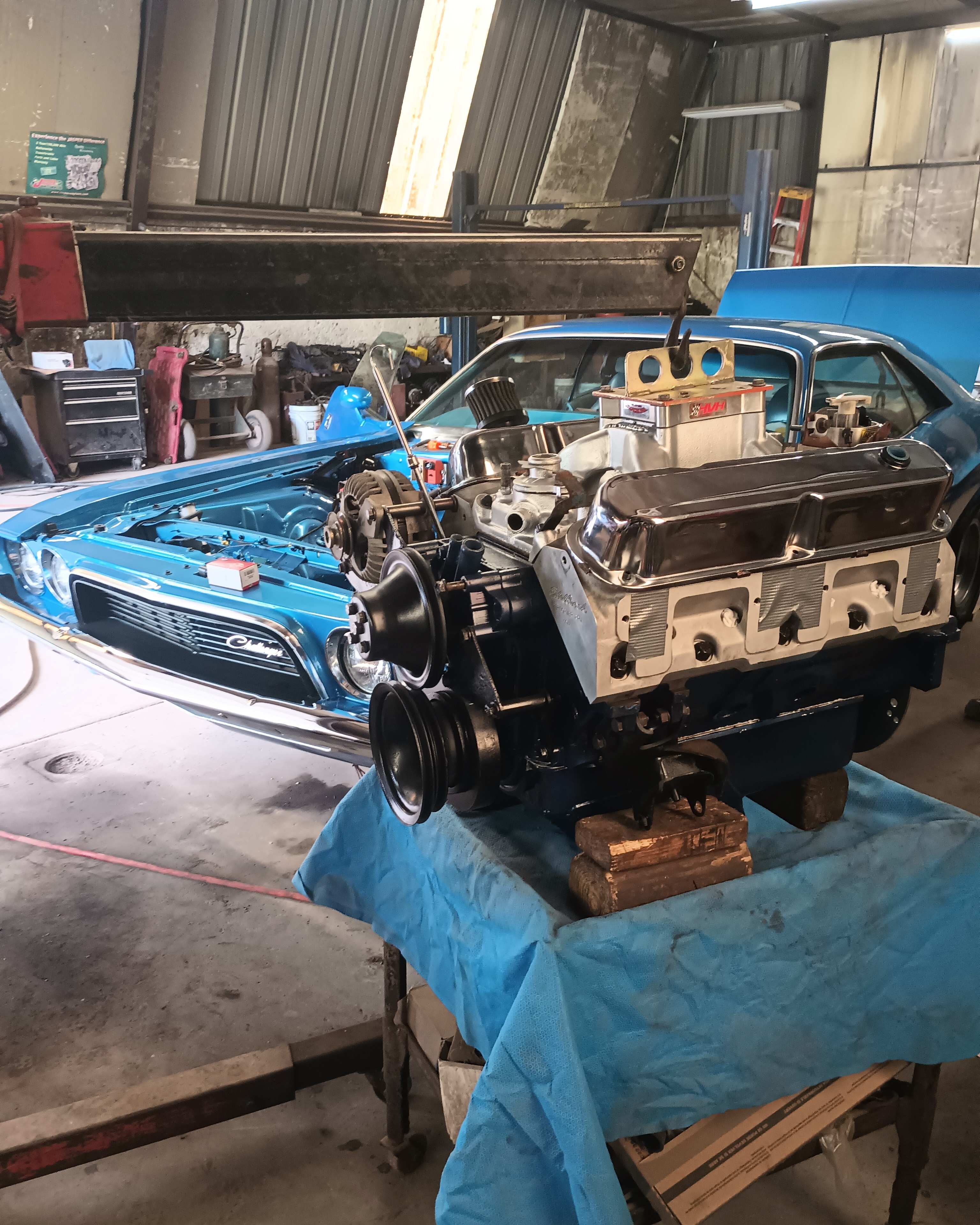

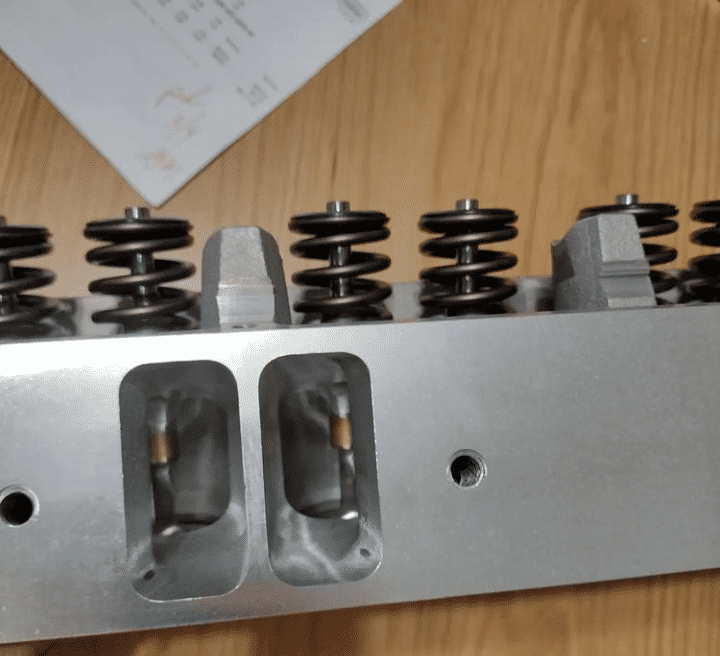

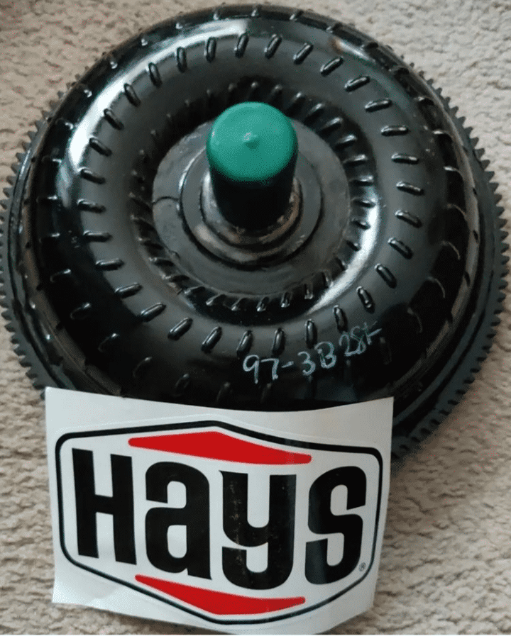

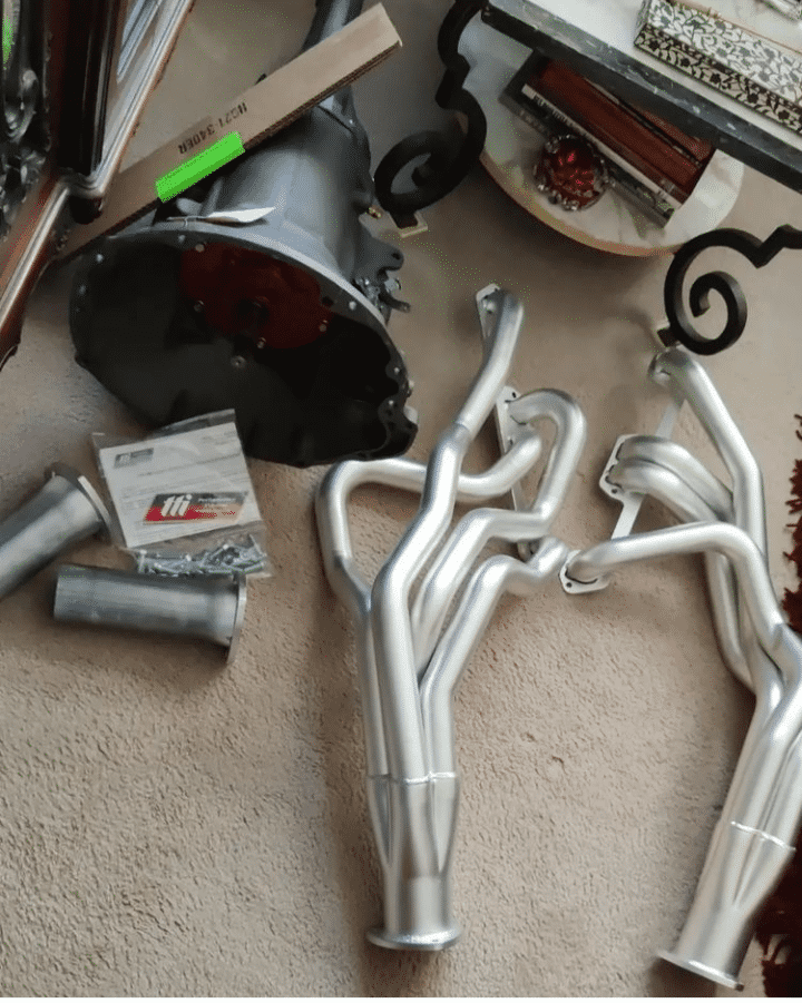

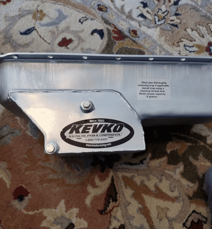

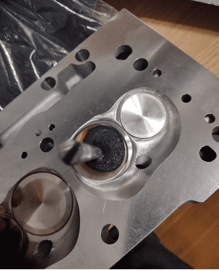

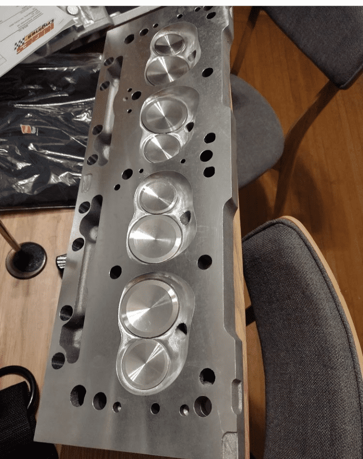

Figured I give some updates with my 340 build the head work from Hughes engine ( new 2.08 valves) new oil pan, I know not the right shade of blue ( i committed a small mopar sin) I did it at home just the blue i had 904 torque flight built by John Cope Hays torque converter 3000 RPM stall. Getting ready to throw the heads on and intake ... Just pulled the hood off the car for the engine 1 7/8 TTI headers
74340
Sep 19, 2021
31
10
Toledo
Looking good. Looking forward to some Dyno numbers.
Same here it's going to be at a chassis Dyno so the numbers will be at the tires . I'll be fascinating how much horsepower it will make and how much I ho I will free up going with the 904 ( still have my original 727) finished porting my intake today. Honestly be happy with anything close to 350 at the tires.
