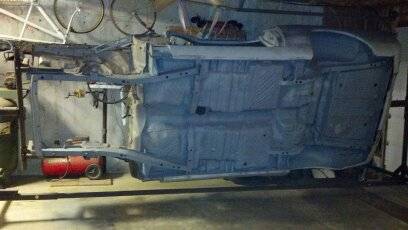

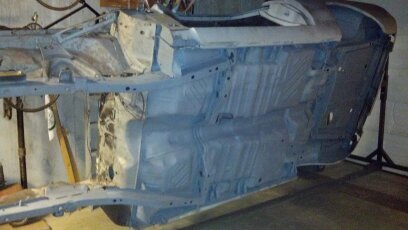

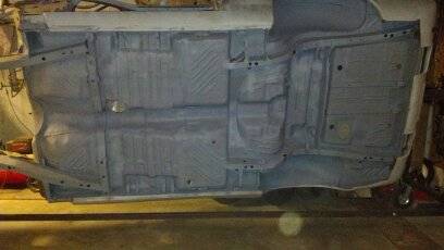

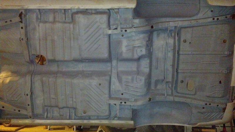

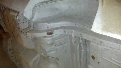

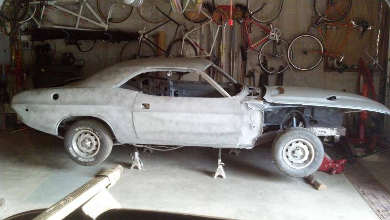

Hello. I purchased a 73 Challenger Rallye with a 340 4 speed. I have a question about conecting the frame rails. I purchased a couple of 1-1/2 x 3" steel to make up some frame rail connectors. The car is currently on a rotisserie that I built a few months ago. I'm not going to drag this car or beef up the motor. Do you think it is worth it to build a set of frame rails for the car even though I am not going to have a 500 HP motor in it? I may want to light the tires up every now and then but I am not going to have a big HP motor. I know not to install the frame rails until the car is back on its wheels. Any thoughts? 061.jpg001.jpg025.jpg020.jpg013.jpg

Anything you can do to stiffen up the chassis is a plus. The car will ride and handle better. Eliminate creeks and popping sounds. The uni-body is now over 40 years old and the original spot welds were never intended to work that long.
Do it.
Oh and welcome to the site!:icon_thumleft:

WOW... An answer already. I have a feeling I am going to be spending a lot of time at these forums. Thanks for the reply! I am thinking of cutting a slot in the rear floor and "flanging" it to the connector. Don't really know if anyone will ever, ever sit in the rear seats and if they do they will just have to deal with the bar in the floor. I think this way will give me better grouind clearance vs. having them "hug" the floor under the car??
The car spent it's life in New Hampshire so there is not much metal left in the frame rails in some places either. Can't wait to get that pistol grip in my hand again after I sold my B body back in 1979.

IMO if the car never had any rust issues and is a hardtop and is being rebuilt to stock or close to stock specs, the frame connectors shouldn't be necessary. That being said, Leo is on the money about the advantages you will gain from them. If you didn't put them on I would say you would probably never wonder why you didn't if you are truely just cruising the streets for pleasure.

Matt and Leo are both right. Street driven the connectors aren't necessary, but you'll notice a dramatic improvement in the way the car handles, stops, rides. It's an inexpensive improvement, worth it in my opinion, especially since you have the car prepped to put 'em in already.
Do it and don't look back.

Thank you Robert. I will start on them ASAP. I think I will cut the floor and weld to the "new" floor pan to help make things stiffer instead of "hugging" the floor pan then angeling up to the crossmember.
