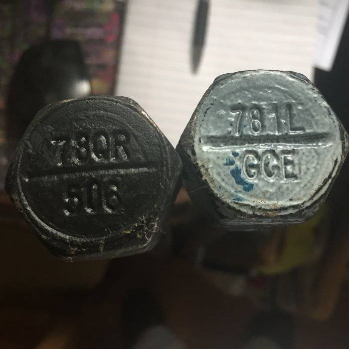

I picked up the Mopar Performance .92 bars for an upgrade on my 340 Challenger from JEGS. Paid 240.99 for the pair with free shipping. (P5249157) These were the factory 440/426 torsion bars.
My A66 Challenger had the factory HD .90 bars (factory size for the 340 and 383-4 cars) I was looking for a reasonable upgrade (ride and handling). You could go larger if desired.
