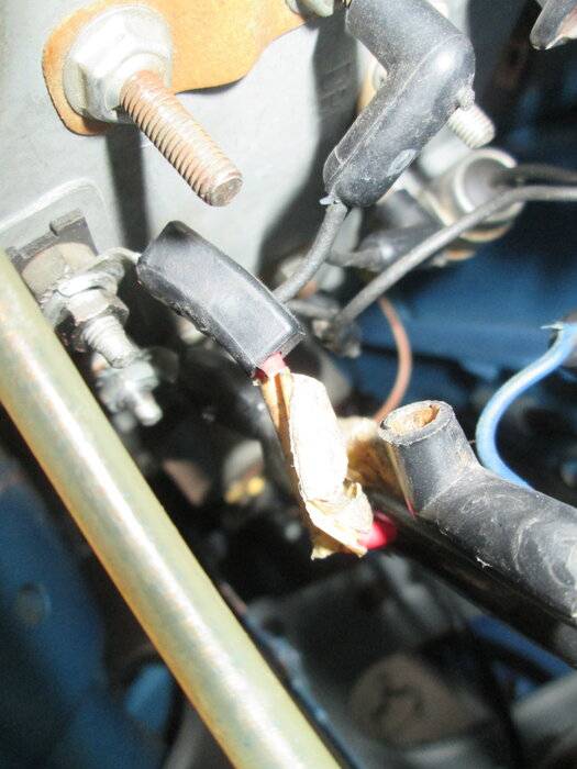

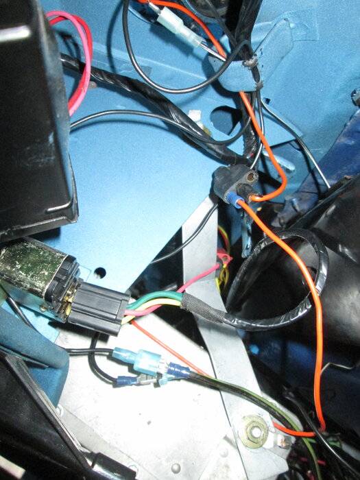

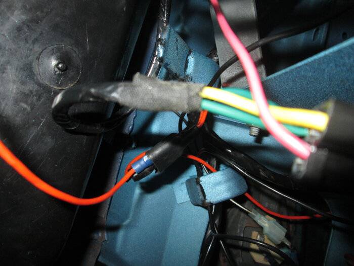

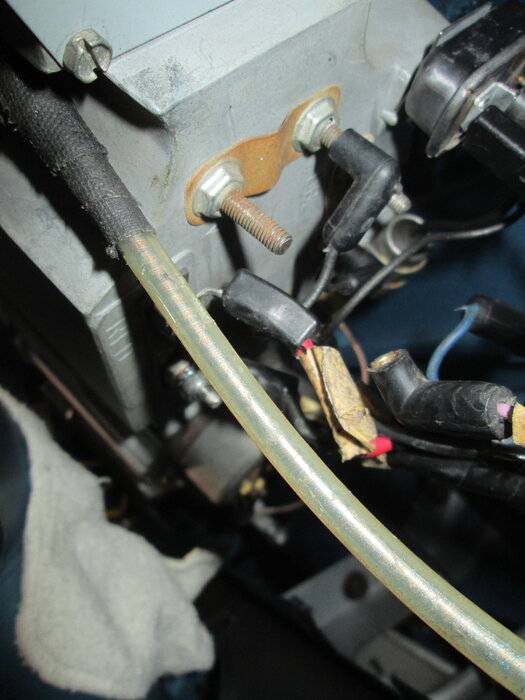

This is where my orange wire goes to that black receptacle then it looks like it comes back out. Also the back of the cluster worked on it today and no luck

The black tri plug has an orange wire going into it so it is plugged into the right place , maybe the other end is not connected to the correct terminal on the dimmer switch.
the black wire that feeds 3 gauges should be feeding a pulsing 5v to the gauges & then it grounds through the sender so you can also test for the pulsing 5 v atthe sender .
