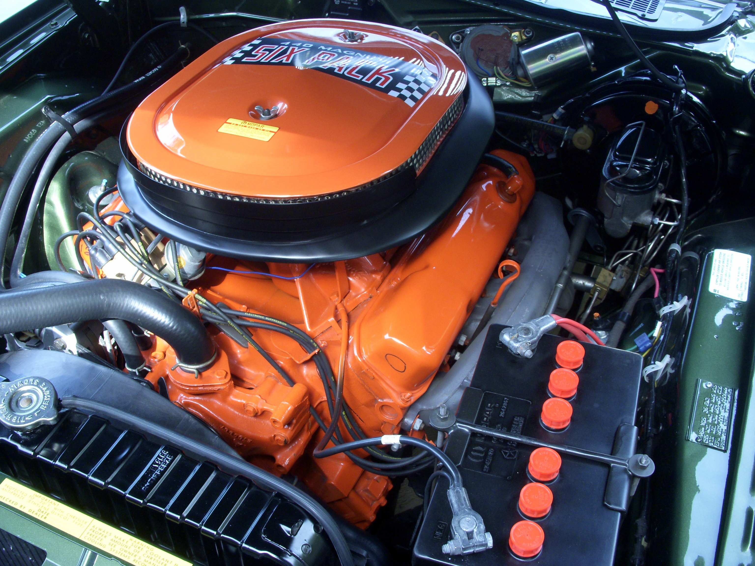

how do you check for wear on the rockers and shafts? (on a 50 year old motor)
I see Mancie make new arms and shafts. just running a sixpack cam nothing big. not sure of the wear in the arms and shafts.
Chryco Psycho
4,894
2,516
Panama
Where the rocker rides on the shaft generally you only see wear on the shaft , the tip of the rocker can have ridges from the valve tip riding in one spot .
If you go to a higher lift cam with used rockers you can get a clicking as the ridge rides onto the valve tip .
