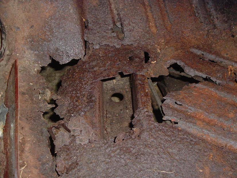

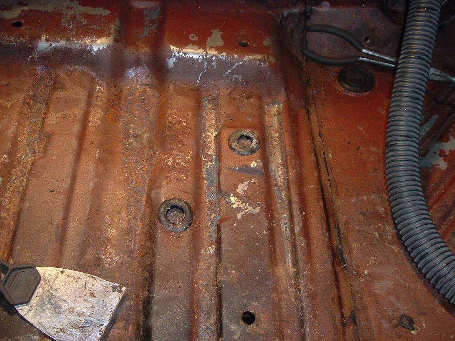

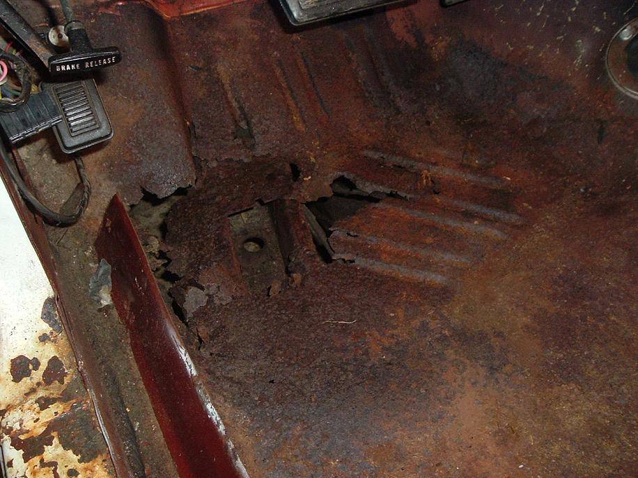

Just pulled the challenger in last night and will be pulling the carpet, seats console shiter, rear seats out in the next couple of days....I hope I find a build sheet of somesort in there...To get a look at the floors to see what it will take to fix them....me and the hobart 140 have been having a talk to make sure we are on the same page when it comes time....HE agrees with me.....
i was thinking of doing that but i have a $800 welder sitting in the corner ready to go....and don't really have the extra cash for the bonding material and the million dollar gun..right now...with buying the floor pan, gallon of chassis saver, etching primer, weld through primer for the seams and 5 tubes of new seam sealer for the conplete floor I am about spent, .....so I guess I have to weld it in...which will work.... I would love to try this some time but.....
