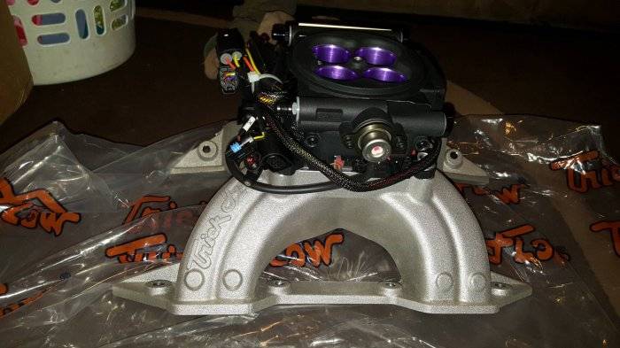

So just an Update. I went with Molnar on the Crank(4.15) and Rods(6.760). Icon Pistons(-23cc), King Bearings, Trick Flow 240 heads, Fi Tech Mean Street EFI. Still waiting for the machine work to get finished so I can pick the block up and assembly. And I haven't chose a Cam quite yet. I cant make up my mind. lol Trying to make myself buy TTI Headers, but dang they get expensive. But anyways, You all have a great April. Hopefully I will get a block done this month.

I went with the Mean Street , up to 800hp. Doesn't have provisions for power adders, however my motor will only ever be NA. They said they 600HP would work just fine, but I figured the 800HP would make me feel better.

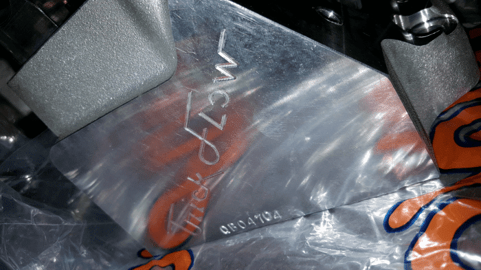

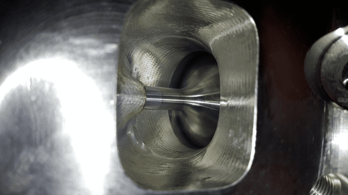

Just some pics of some parts
