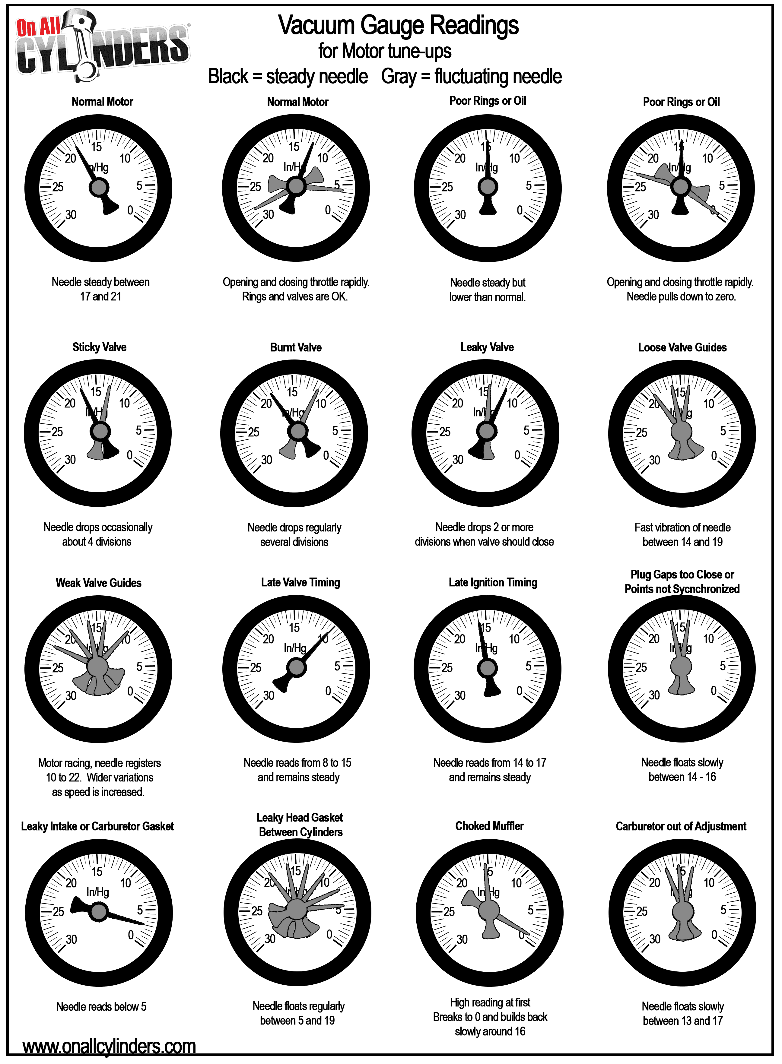

One of my favorite go to tools for a running engine is a vacuum gauge. It can tell you a lot.
cuda joe
Dec 26, 2021
359
121
nj
keep the 340 if it;s numbers matching . thats a real good chart xcuda

First, Thanks XCUDAME for the chart. I went and found it on the internet with some added information.
Question for anyone who has used vacuum gauge to tune of diagnose problems.
I have a 340 Block, Stroked and bored to about a 416. Comp cams Hyd roller cam, Edelbrock RPM heads, Milodon oil pump and so on.
The vacuum chart show a normal engine running with a steady 17 to 21 gauge pressure. Mine is not steady at all running at idle. Is that normal for a modified motor?

It should be "relatively" steady. The wilder the cam the more messed up the vacuum signal in the inlet gets.
That chart is for standard camshafts your vacuum will probably be a lot lower.
What readings do you get? And is your gauge damped?

Just got some numbers from my engine. Ran engine for a few minutes, not fully up to temp.
850 to 900 rpm 5 to 15 fast fluctuating
1000 rpm 10 to 12 fairly steady
1200 rpm 13.5 very steady
1500 rpm 15.0 very steady
Challenger RTA
Oct 28, 2018
3,588
1,894
PA Flood city
Mike73Dodge Just a suggestion:
Any time you see a rapidly bouncing gauge the first place to look is for a leaking intake valve for whatever reason be it the valve or spring.
Also, cams with a lot of overlap make the gauge bounce as well as read low.
You can remove the bouncing by putting a small orifice in the gauge line to make it more steady to see what the actual reading is.
Normal, What is?
This reading between 17 and 22 inches of Hg is normal. Remember that this figure is optimum for engines running at sea level with factory cams.
Readings may be a little bit lower at higher elevations. The reading should be around one inch lower for every 1,000 feet above sea level. Additionally, for cams with greater aggression, you should anticipate lower readings.

A leak down test will probably point you towards the problem at this point. Looking at the vacuum gage chart, it points to worn valve guides which will cause a leak between the valves and seats.
