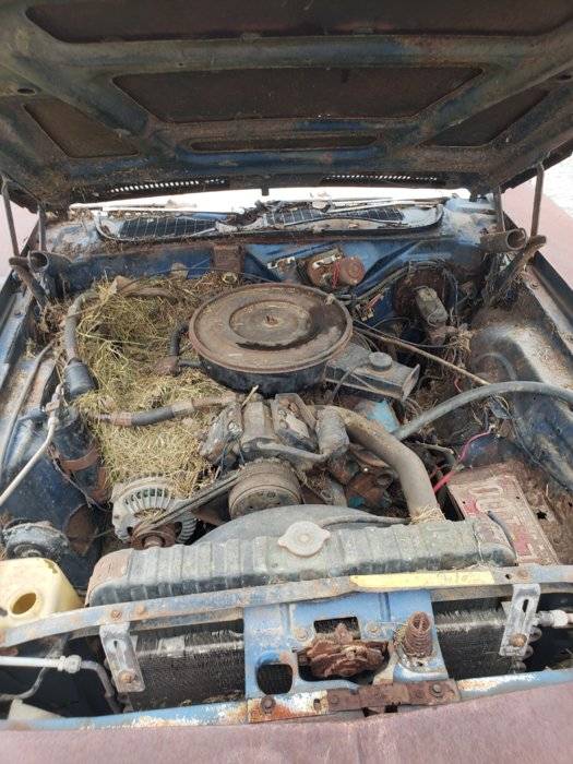

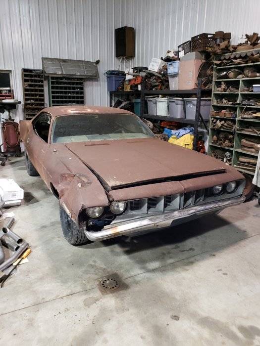

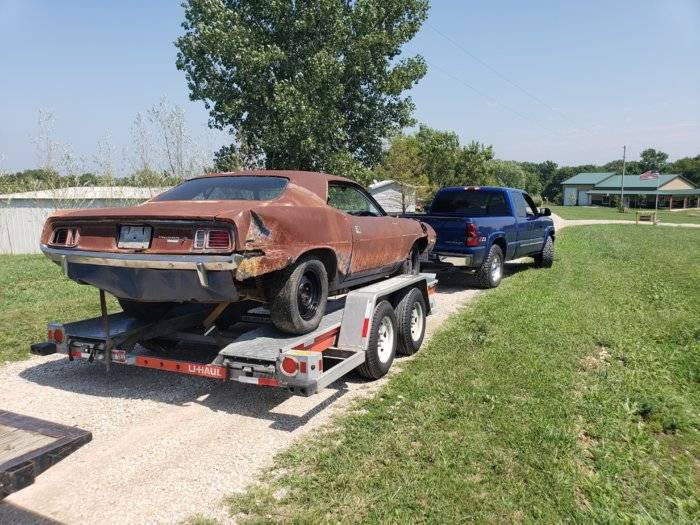

Not new to projects but this is my first mopar and lets say by the time I'm done with this one I'll have the confidence to take any project on.
I've had the car for a little over a year now but this is when I first brought it home.

Welcome Aboard, yes you have your work cut out for you. Best of luck with the resto. Looks like you had to evict a tenant from the engine bay

What do you mean it doesn’t look that bad, you can see all of them from the topside!:lol:

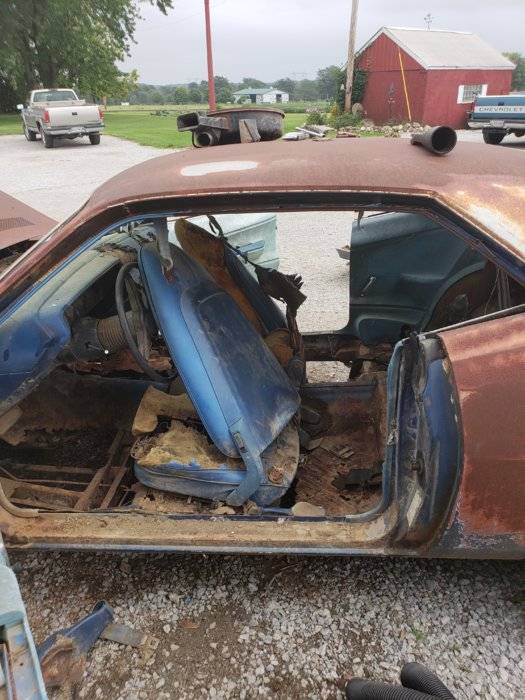

Matt you should have seen the one I did this one looks like a show car compared to it. As long as the frame rails are solid, the firewall looks ok from what I can see, floor pans are easy to do and rear quarters aren't too hard to do once they are done this thing will look a lot better.
Agreed, sheet metal is easy, especially now days with everything available, you don't even have to form the panels anymore. If the rear understructure is straight and in good shape you are way ahead.

I remember it being for sale. Kansas wasn't it. It changed hands once or twice as well.

I did find the build sheet under the rear seat. The mice found it too. Its still legible enough to make out the vin and options on the car and it all matches the fender tag. As far as the underside of the car hardy any of it was saveable. Frame rails, rockers, pans, and cross members where all easier to just replace than try to fix.

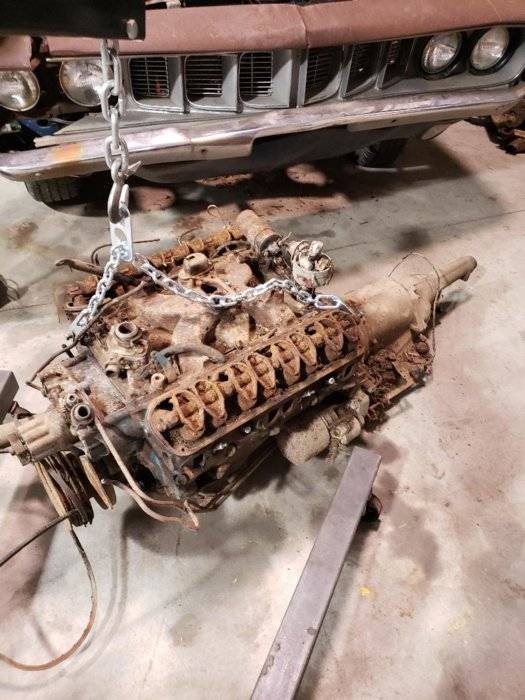

The car is B7 318 a/c but the 318 wasn't saveable either but a 440 was going in the car regardless. Id like to find a hemi but you know.. reasons haha

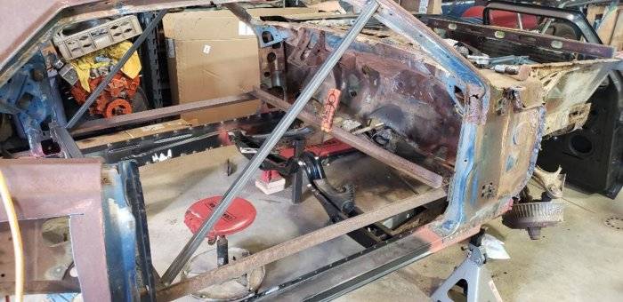

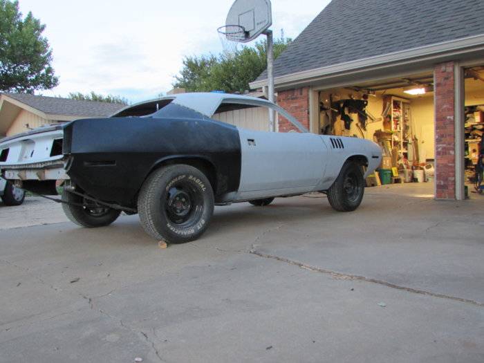

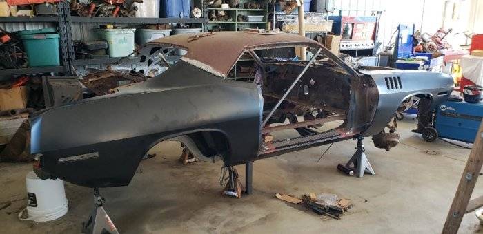

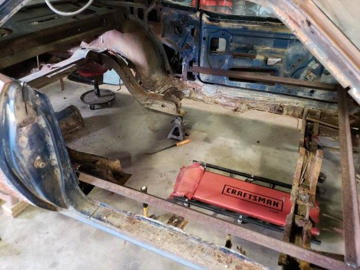

Here's the current state of the car way worse than anticipated, but starting to head in the right direction. The hardest part of the whole project is just trying to get the replacement parts here without looking like they where run over in transit.
So far I have new rockers, torsion cross member and rear rails in and still working the alignment of the panels. Some of AMD's parts leave a lot to be desired in terms of fitting.

Looks like you know what you are doing.

The fenders and quarter panels are beautiful. That is when FedEx doesn't smash them to bits. The issues are more evident on the rear wheel houses and the trunk pan extensions. All considered i've seen way worse when it comes to aftermarket panels. Where just lucky AMD does make decent products.

I was having this discussion yesterday with a co worker who had just done a couple of Barracudas. He said the first one he put a amd floor pan in and the fit was horrible. He said the car was never wrecked etc and all his factory measurements were correct both before and after the install. He said there was bolt holes that were 6 inches off. The next one he done, he went with Sherman and all the panels fit like factory and he was very impressed with them. I've heard a longer story on why all these panels dont fit right. Good luck with the build.
