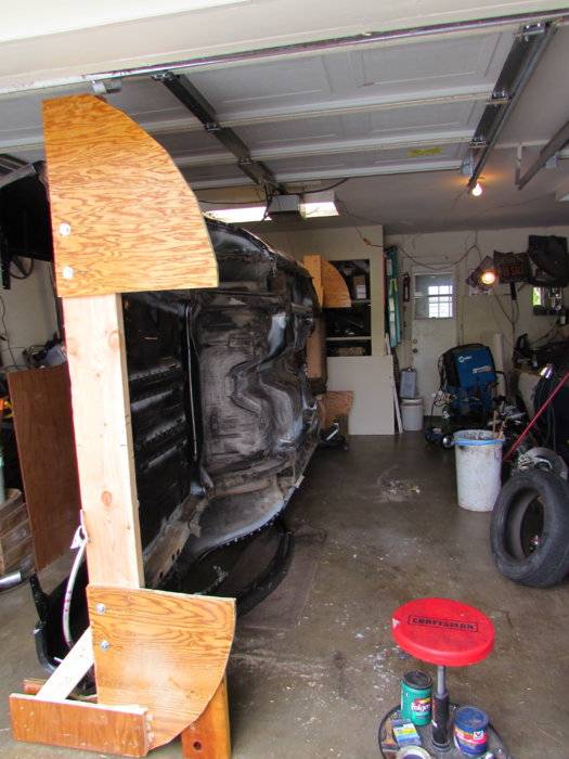

I'm largely self taught Kind of a learn as I go situation. I've done a little metal work on my chevelle but this is a whole new animal.
I'd rather block sand for days than try to fit these panels but it's all part of the experience right.
I have grown very weary of block sanding, and would rather fit the panels these days... Sometimes you have to cut a relief with a jigsaw or body saw and weld it back up; also the new body panel structural adhesive is amazing stuff and you can use it in places where heat might cause warpage or heat damage. Is that your Miller mig welder in the background?

Keep the progress pics coming, looks great. Looks like you aren't using a jig of any sort, just supporting on the torque boxes and frame rails? I need to do passenger side rockers so if you had any in process pics of that I'd love to see them
