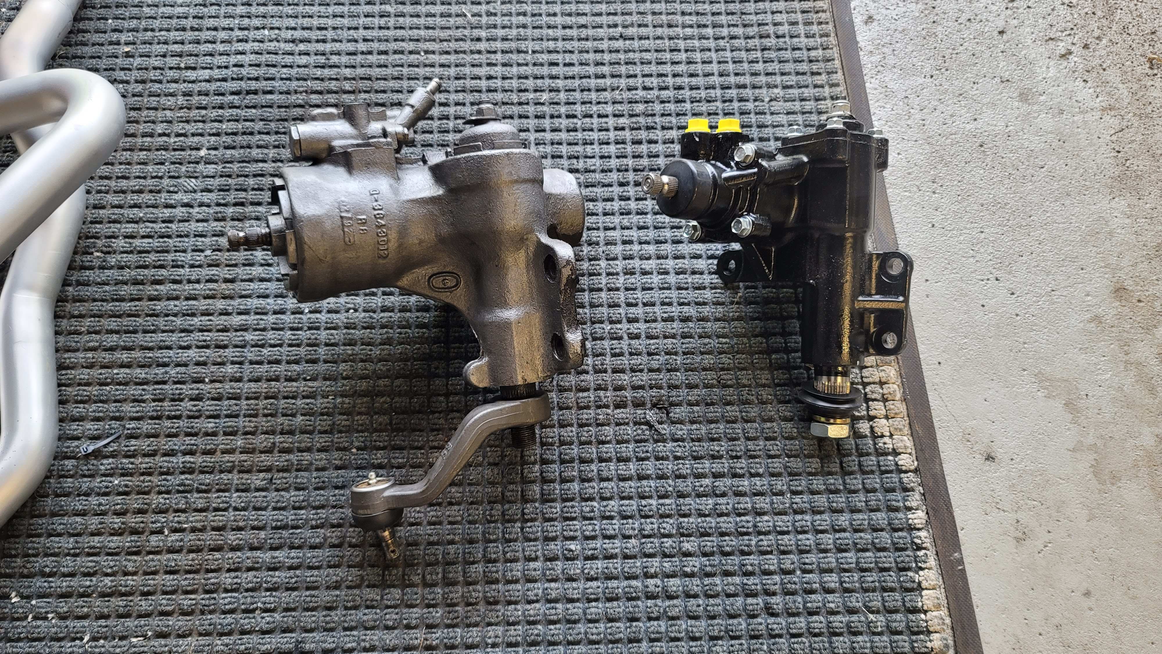

Borgeson, best upgrade. Half the size and weight, installation was a breeze...
Lars unit looks interesting, basically same as Borgenson.
It looks like you have to buy some extra parts separately though?
I have the Borg box, not as impressed with it as others here.
I have an original one that needs restored, just clean up and paint, was planning on using it, but after the last post its got me thinking that would work alot better especially in front of the radiator

Thanks RayCuda, got the Borgeson Box, Pump and cooler installed, I'm thrilled with it !!!
I am so happy you are thrilled with your install. As I said, my brother did it and he loves it. I drove his car, and the feel is fantastic, nice and tight, not sloppy like mine feels. Time to bite the bullet and do mine next.
