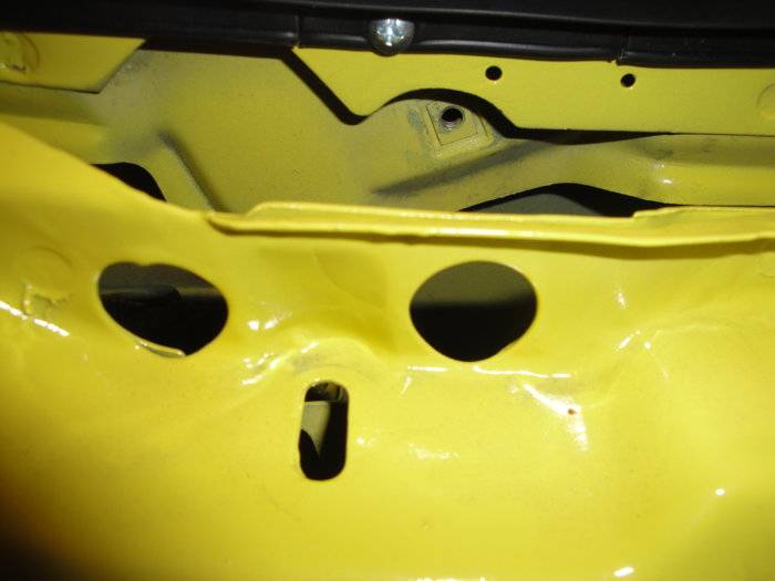

Thanks for the welcome. I have a 72 rallye car that I'm finally putting back together after several years of restoration. Issue I have is that I see no holes for front door up stop brackets ? attached photo, any help is greatly
appreciated.

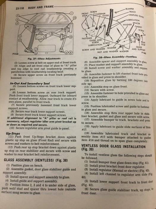

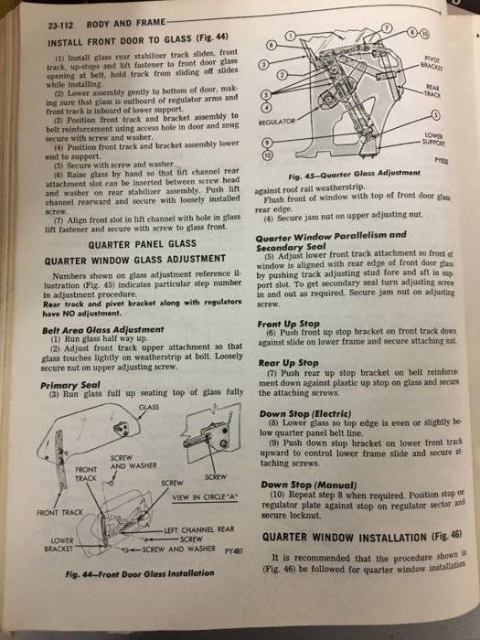

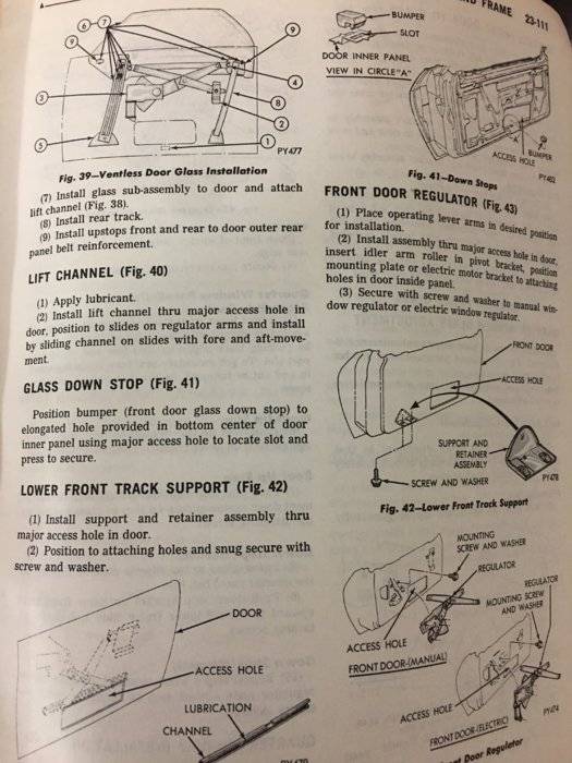

I thought I’d throw this in from the FM for what it’s worth.
