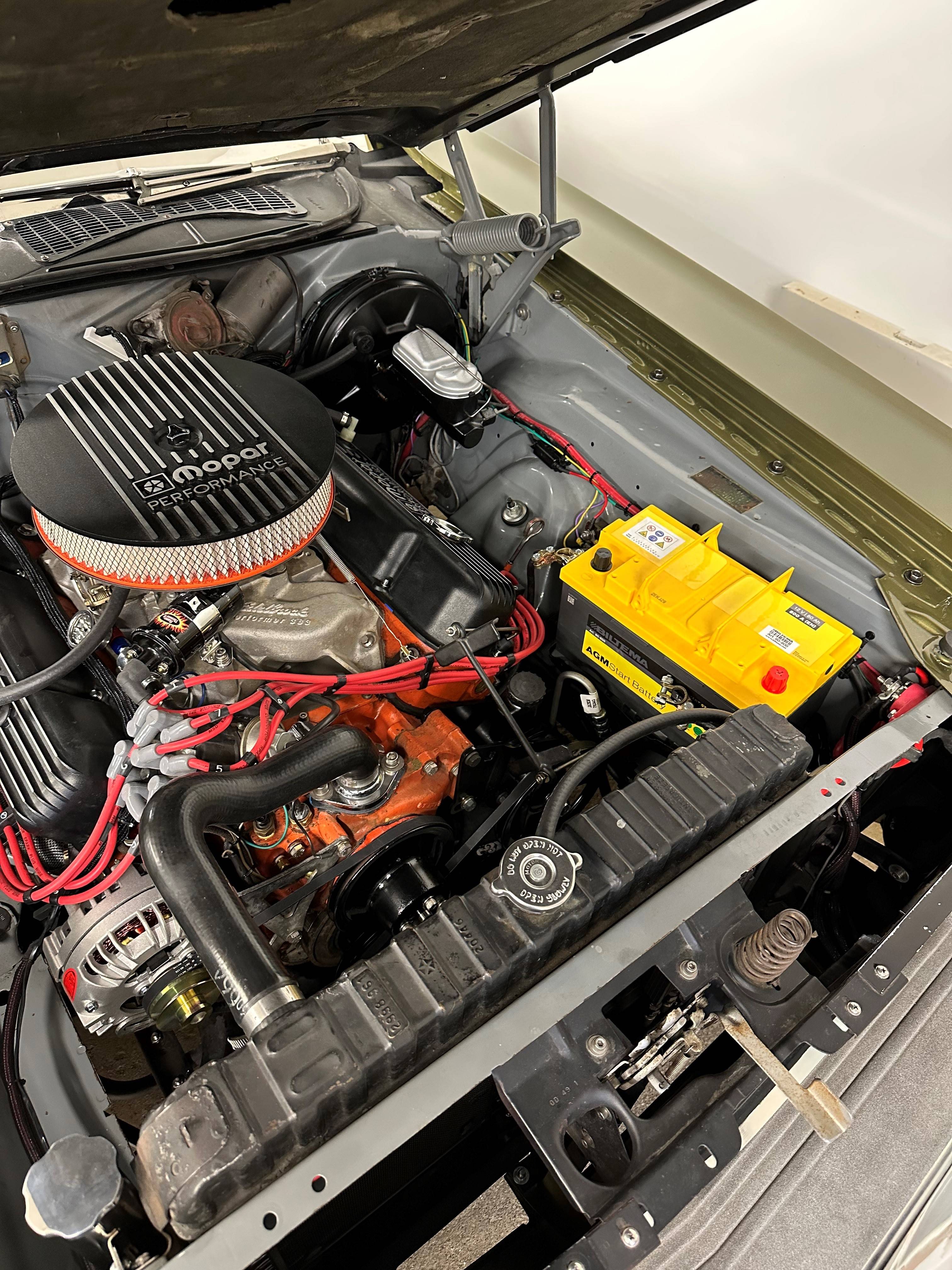

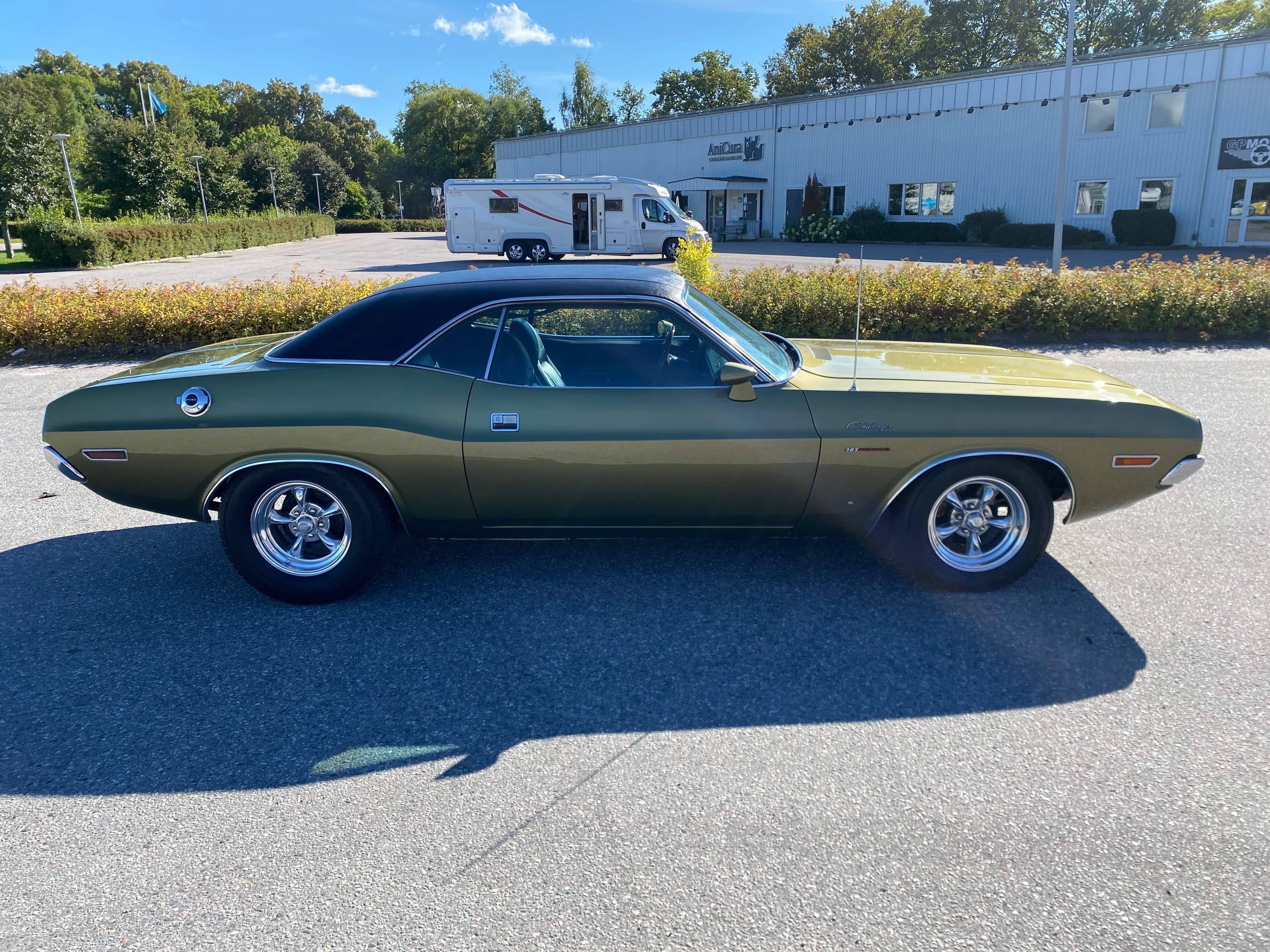

Hello!
We bought a 70 Challenger SE 383 HP Four Barell ( 3-speed 727 with slap-stick! ) last summer!
The car runs very good and is a true joy to drive!
This winter my dad did some upgrades:
*Borgeson power steering was mounted.
*Every bushing in front was changed.
*A new 2,5" magnaflow exhaust
*Cleaning up some electric wiring that was not so good.
*New sparkplugs with new wiring.
*New differential and new 3,55 ratio instead of 3,90.
*R/T stripes a long the sides are now mounted, not on this picture.
* 95 amps alternator.
*New battery ( the emblem on battery is now removed )
*Carpet in the trunk and we also mounted a breather for the gas tank.
* Custom autosound retrolook stereo instead of an old pioneer.

1st question, what emblem should we buy on the new R/T hood? We have the 383 four barell on the sides of the car. And we have the 383 magnum on the dual snorkel.
Should we buy the 383 magnum emblem for the hood? Or what is the correct way to do it?

Welcome to the site from the Motor City! Nice Challenger.
if it were me I couldn’t have 2 sets of engine callout emblems facing the same way on the front of the car. It would be redundant. If you can’t get rid of the ones on the fenders without body and paint work I’d leave them on for now and don’t put any on the new hood.

You are making a good point! Maybe its better to leave the hood with nothing! Or maybe put the same " 383 four barell" on the hood as well as on the side... But maybe it will be too much..

the hood emblems are up to you want you want to advertise !
Be careful with the 95 Amp alternator , I highly recommend a 10 ga wire bypass directly to the start relay / battery , the car was never designed for a 95 amp alt & could start a fire at the ammeter gauge in the dash or firewall connection

My dad has Done exactly this! So he knew about the ”issue”.

Looks like the battery has the terminals reversed. The Negative is normally near the radiator support.
You should replace the battery cables with factory type, not the "temporary" repair type ends you have shown.

I'd suggest cutting off the studs on the hood emblems and using double back tape to install. That way you don't have to drill the hood and you can see if you like the look.
