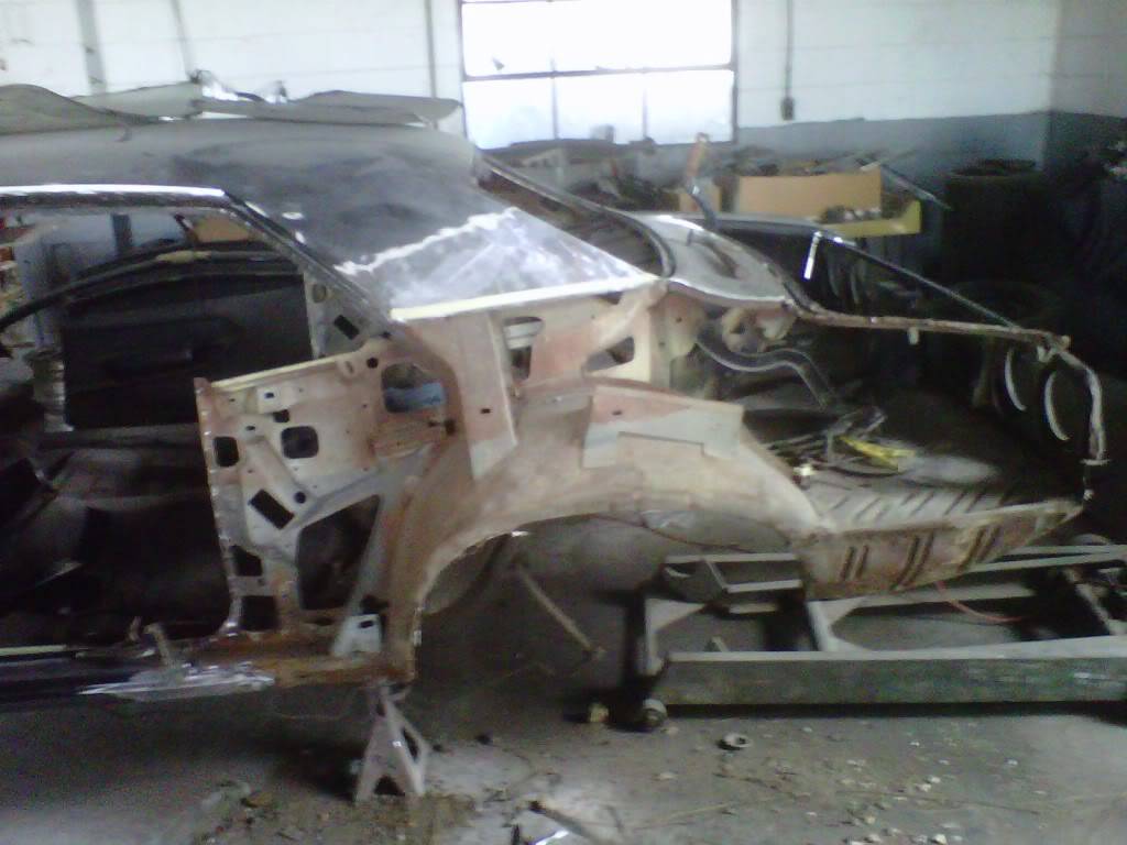

Okay here we go pics from me getting started. A little info on the car it is a matching number 340 pistol Grip 4 speed car. I got it when I was in high school and its time for a restoration! I ended up having to put a door jam in the car because they put the old quarter on with a torch and brass warped alot of stuff up.

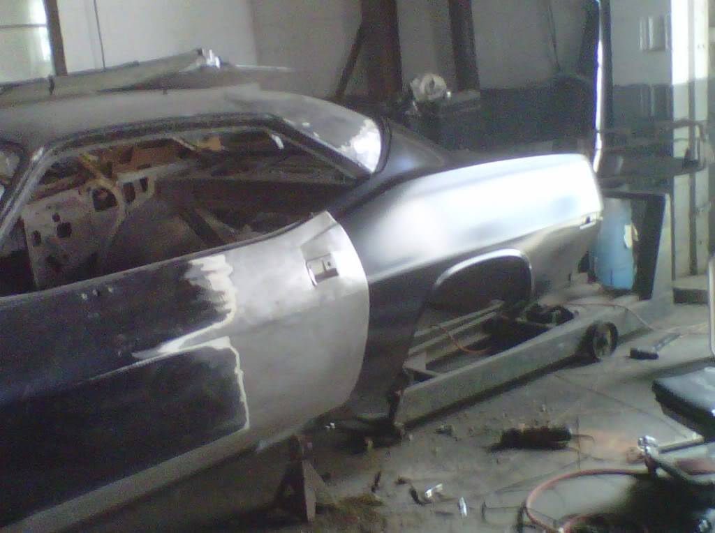

Here is a pic of the mess I am having to fix from someone doing bad panel swaps

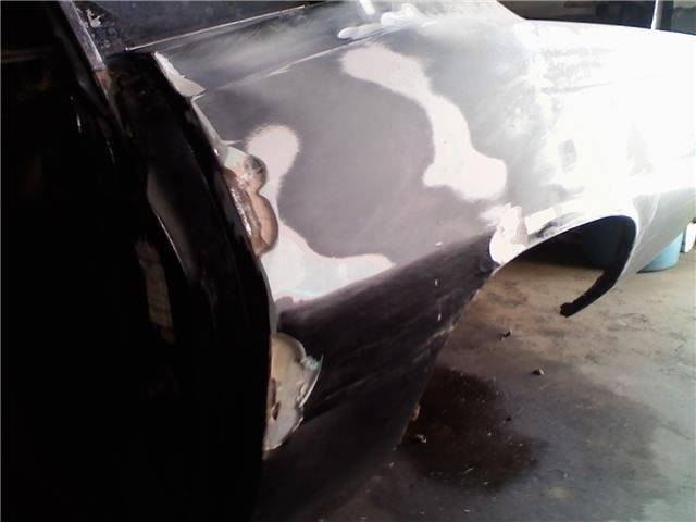

It was 1/4 to 1/2 depending on location. They wiped it over the door to bring it out to match and it went all the way down to the front fender and feathered to make it all line up. You can kinda see the light bondo on the door in the pic.
