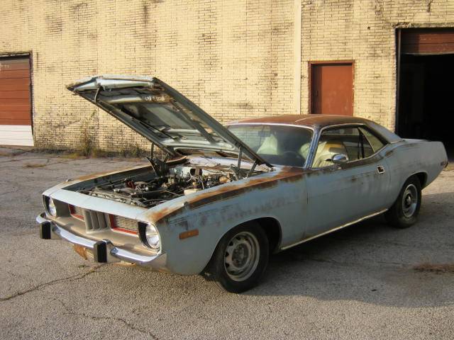

Hello fellow E-Body brotherin,
New Cuda owner located in Woodstock, GA here. Some of you may remember my post I had listed looking for a 73/74 Cuda. I would like to say thank you to those who had shared information with me about the cars they were selling.
I found a KB1, 1974 360, Automatic matching numbers car that was waiting for me to find it. Some options include: 26" Radiator, LH & RH Chrome Racing Mirrors, Tachometer, Factory Ac and Floor Console. It was manufactured 2 days before I was born, so I got about as close to my birth date as I could.

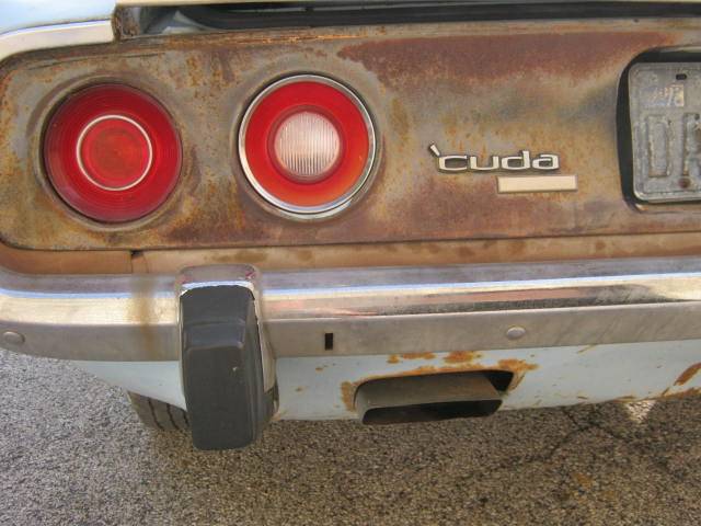

The Cuda had a white vinyl top that caused rust issues as most vinyl tops I've found do, So I need to replace the Roof Skin.
I'm looking forward to making new contacts in the E-Body world as the Cuda and I venture down the restoration path.
Please post pictures of Powder Blue E-Bodies if you have them. I'm not sure I want to stick with this color or not.

Congrats. I don't think that powder blue was a factory color. I know that the equivalent of Petty Blue was and faded very quickly. My 72 that I bought in 78 looked like powder blue. With a little polish and wax she gleamed like new. Came with a blue interior and white vinyl top. Got a build sheet or fender tag ? Remember that any thing that you can bolt on can be unbolted. So do it the way you want and save the old stuff for the next owner if they want to put it back to stock.

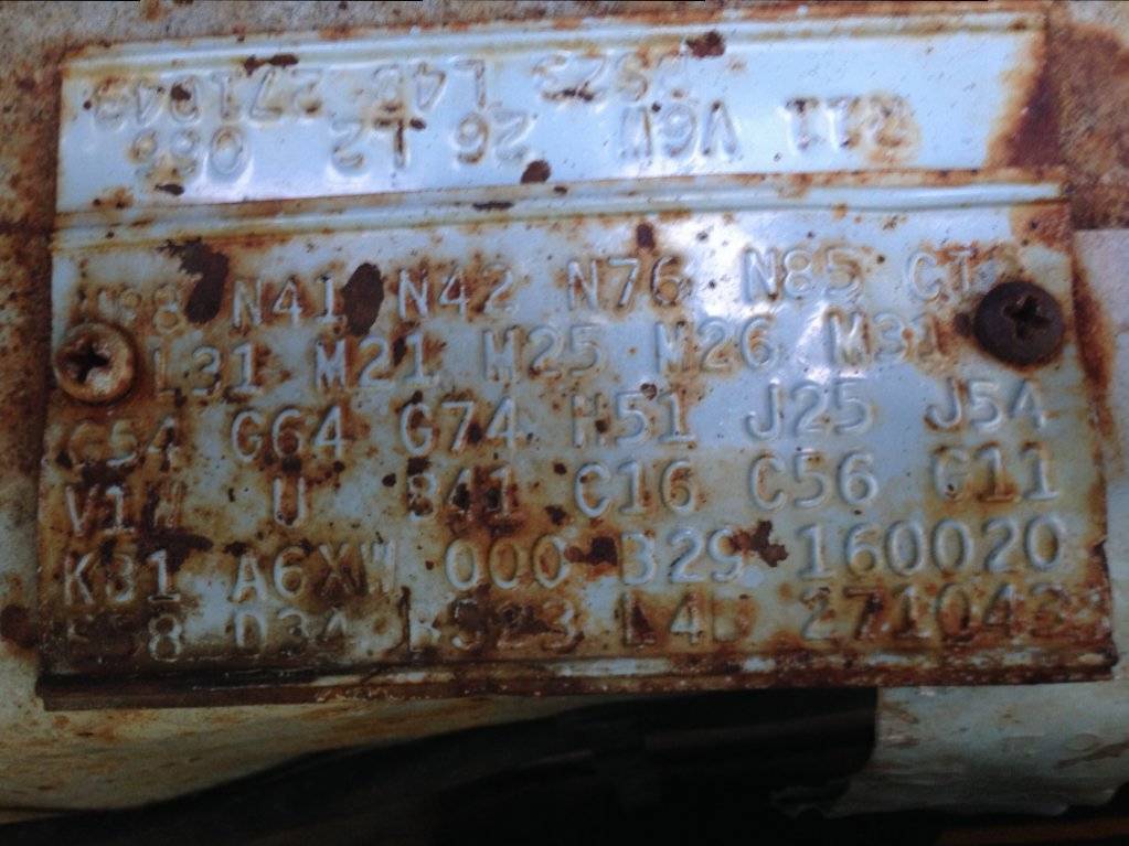

From what I've found Powder Blue and Lucerine Blue were both available in 74. It has 2 Fender Tags (and a long thin tag attached to the data plate screw, not sure what that is supposed to be) but I have not found a build sheet yet.

I've seen a few powder blue ones over the years. The extra tag hanging off the fender tag screw is thought to be where the inspectors left their punch mark as they signed off on the car on the line. You should post up some pics of the tags.

Always fun to decode the tags
It is pretty loaded
A lot of molding treatments
Color has to be pretty rare, with a white top and interior
BS23:
Plymouth Barracuda
Special, 'Cuda
2 Door Hardtop
L4B: 360 245HP(net) 1-4BBL 8 CYL HP
1974
Dodge Main, Hamtramck, MI, USA
271043: Sequence number
E58: 360 cid 4 barrel V8 245hp
D34: Light Duty Automatic Transmission
KB1: Powder Blue Exterior Color
A6XW: Trim - Basic, Vinyl Bucket Seats, Black/White
000: Full Door Panels
B29: Build Date: November 29
160020: Order number
V1W: Full Vinyl Top, White
U: USA Specifications
B41: Front Disc Brakes w/Standard 10in RR Drum
C16: Console w/Woodgrain Panel
C56: Bucket Seats
G11: Tinted Glass (all)
G54: Outside LH Remote Chrome Racing Mirror
G64: Outside RH Manual Chrome Racing Mirror
G74: Dual Chrome Racing Mirrors
H51: Air Conditioning with Heater
J25: 3 Speed Wipers
J54: Sport Hood
L31: Hood/Fender Mounted Turn Signals
M21: Roof drip rail moldings
M25: Wide sill moldings
M26: Wheel Lip Moldings
M31: Belt Moldings
M88: Decklid Moldings Treatment
N41: Dual Exhaust
N42: Chrome Exhaust Tips
N76: Coolant Recovery System
N85: Tachometer
R11: Radio Solid State AM (2 Watts)
V6W: Longitudinal Stripes, White

After the 26 (26" radiator) there is L2. One decoding site pulled this up as Secnd build date.
The door sticker says Manufactured 01/1974 is this what the L2 is referencing?
