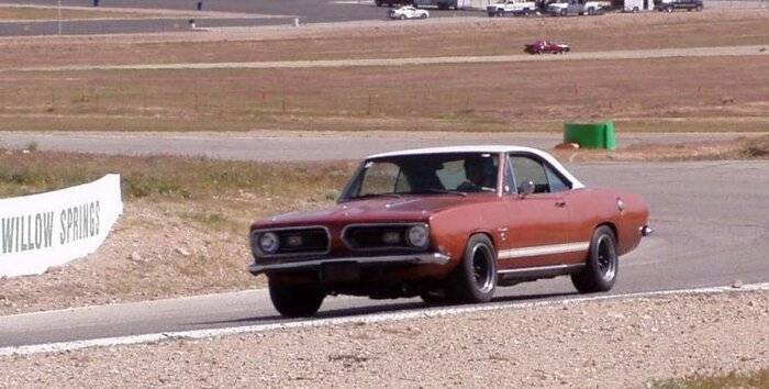

If you are rebuilding the 340 or a 360 I’d go with a 4” stroke kit.
Just a simple way to get HP and TQ while being easy on valvetrain.
For engine building at the higher end look into QMP in Chatsworth. Brad started out working for Lambeck many years ago.
Hope to see you out at Willow Springs...:steering:

Most aluminum aftermarket heads will get you quench. Air Flow Research seems to the latest and greatest in terms of quality and value in street like head.
What HP/TQ are you looking for?
It will be easy to build a 475-525 HP/TQ stroker with more power than your tires and chassis put down at Willow Springs.
I was able to dial in my quench with an off the shelf Scat stroker kit and simple Edelbrock heads. Mechanical cam with comp steel rocker for longevity and reliability.

I still run a BG Silver Claw 750 double pumper carb. They are reliable. These FI setups have issues and hiccups and seam to need special tuning and programming and... I don’t put 12K miles on the car anymore so gas mileage deal doesn’t mean much to me. That’s on my 416 (340 stroker) -ported edelbrock heads, comp 274-S, M-1 single plane, 1 3/4 TTI’s
Here’s a setup IMM in Indio, CA did a 408 stroker with the comp XE295HL cam and was 480/480 HP/TQ
Small-Block Mopar Stroker Dyno Test - Car Craft Magazine
That’s with not ported RHS heads. With a just a quasi bowl cut/blend.
I’m thinking better AFR heads, 11 more cubic inches, more bore to un-shroud valves.... would put you around 500+ hp. Maybe you could run a little smaller little more streetable cam and still get 500HP.
Here’s the same short block witH 600HP with ported edelbrock heads and more cam...
How To Build A Pump-Gas 620hp Small-Block Mopar - Car Craft Magazine
