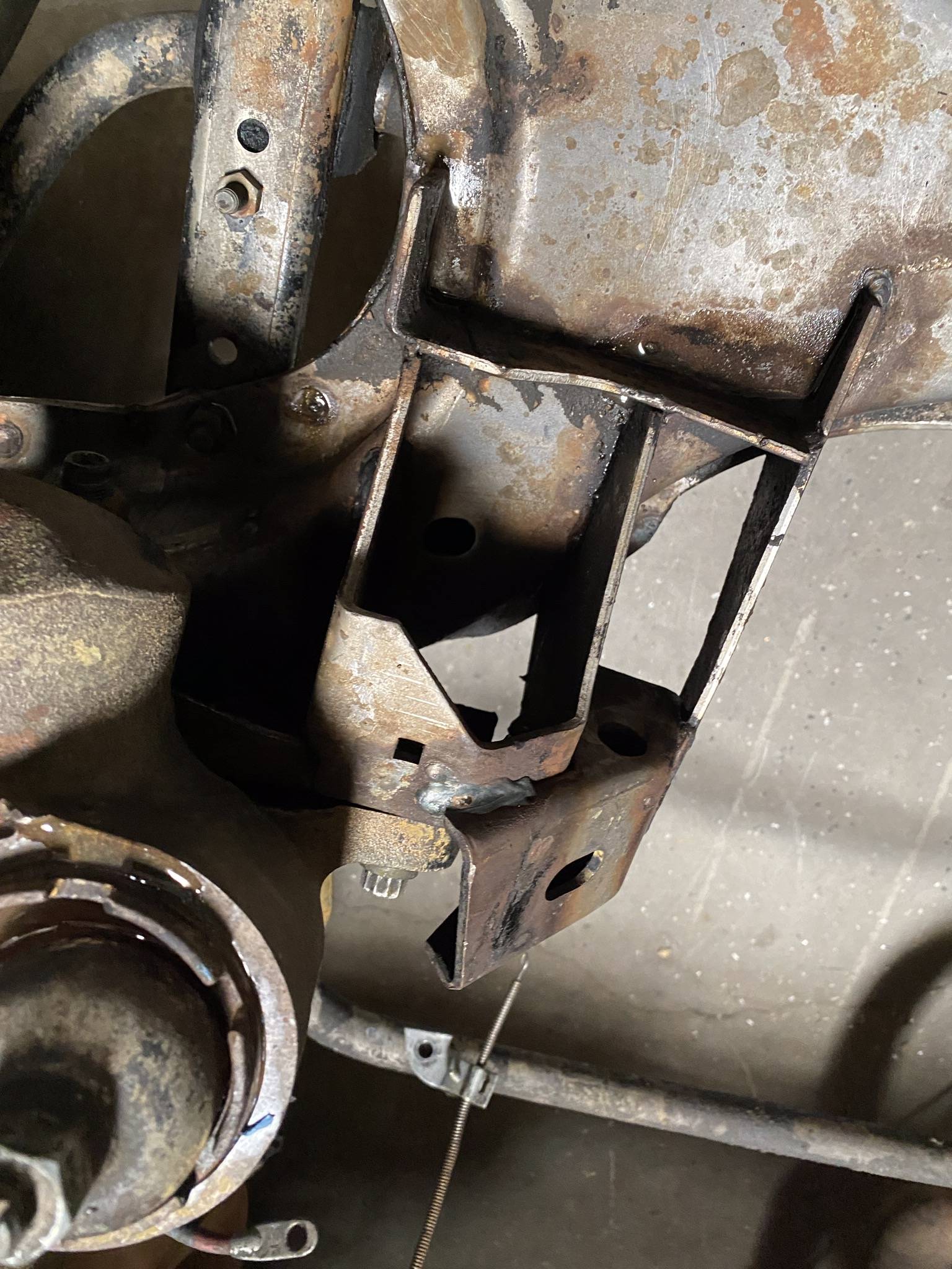

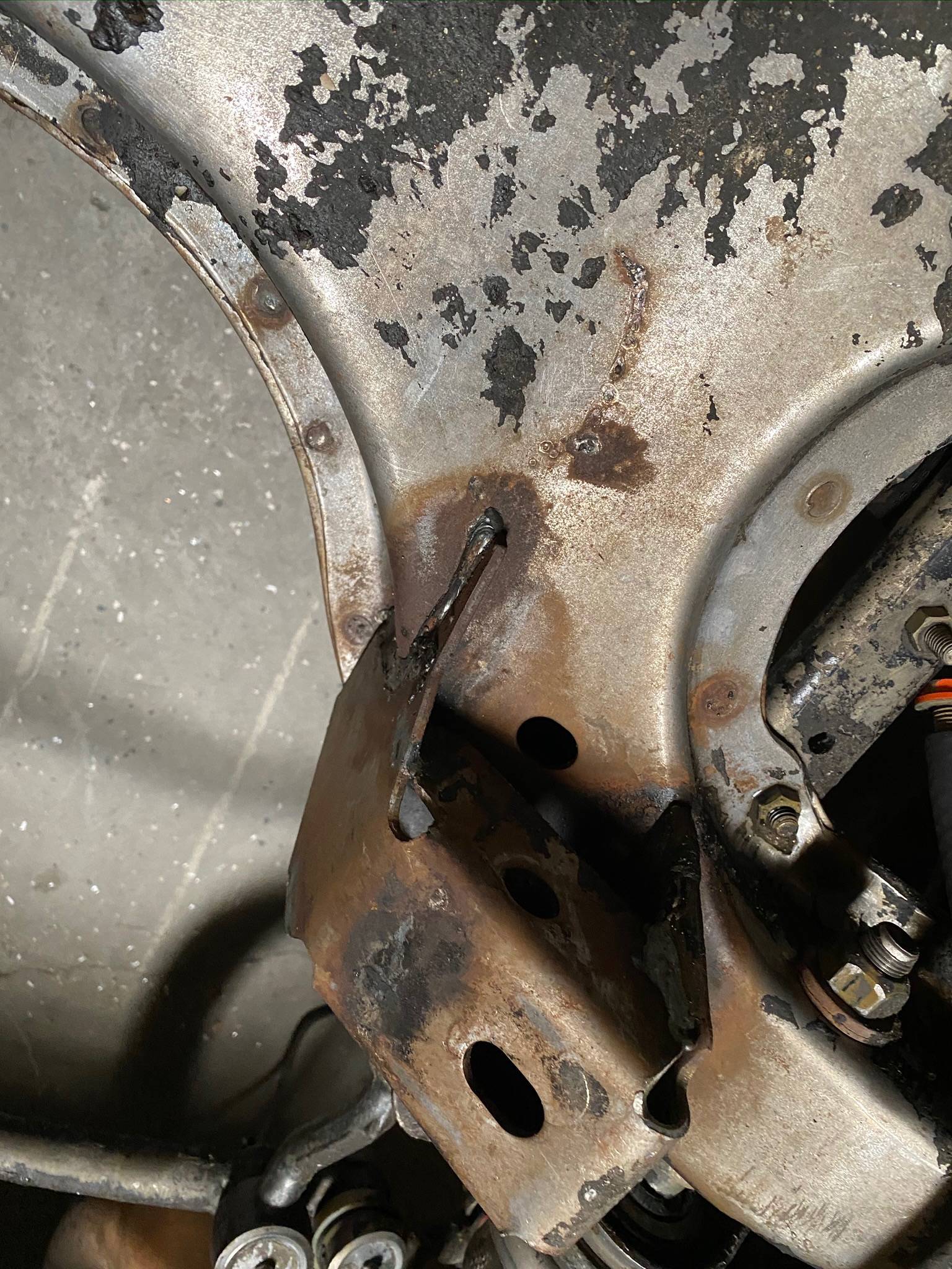

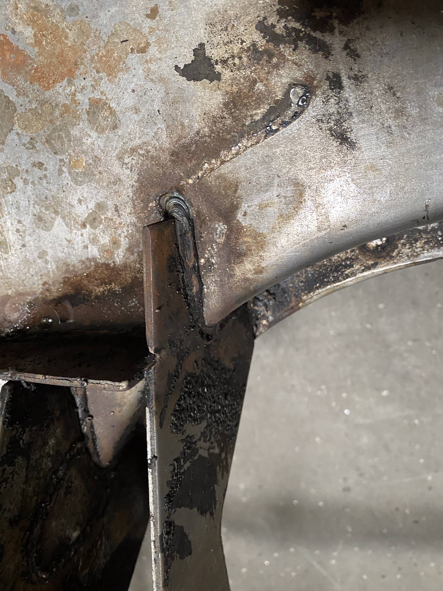

What do you make of this? This is the “K” member n my 70 cuda.

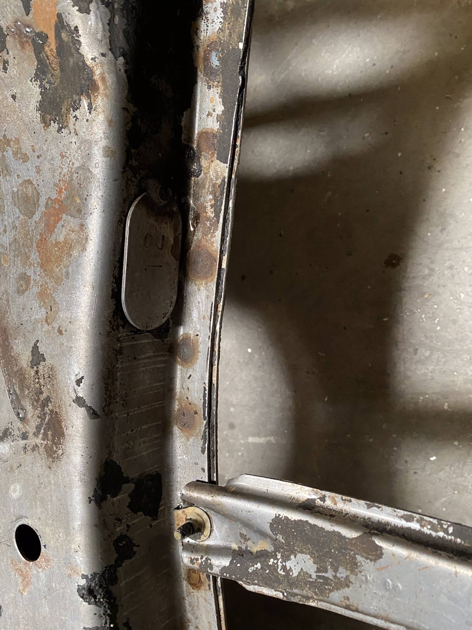

I pressure washed the motor compartment and discovered this. It looks like work has been done. What is the tag with the number 12 I wonder?
That k member is stock. They were not pretty from the factory. The 12 coin, as it’s called, is the last 2 digits of the part no of the k member. They started that in 70 but did not go past 71 years.
