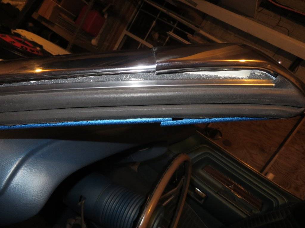

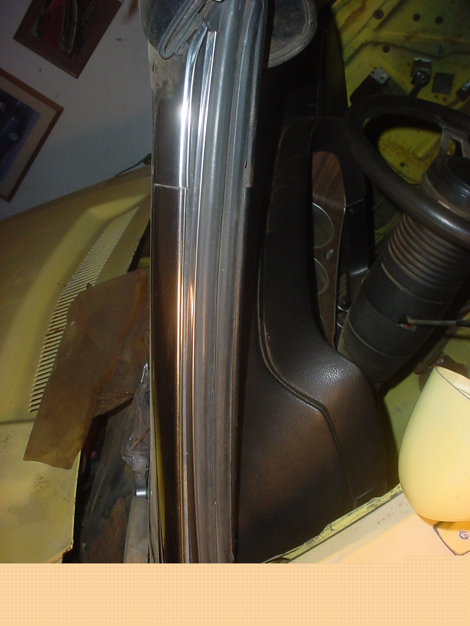

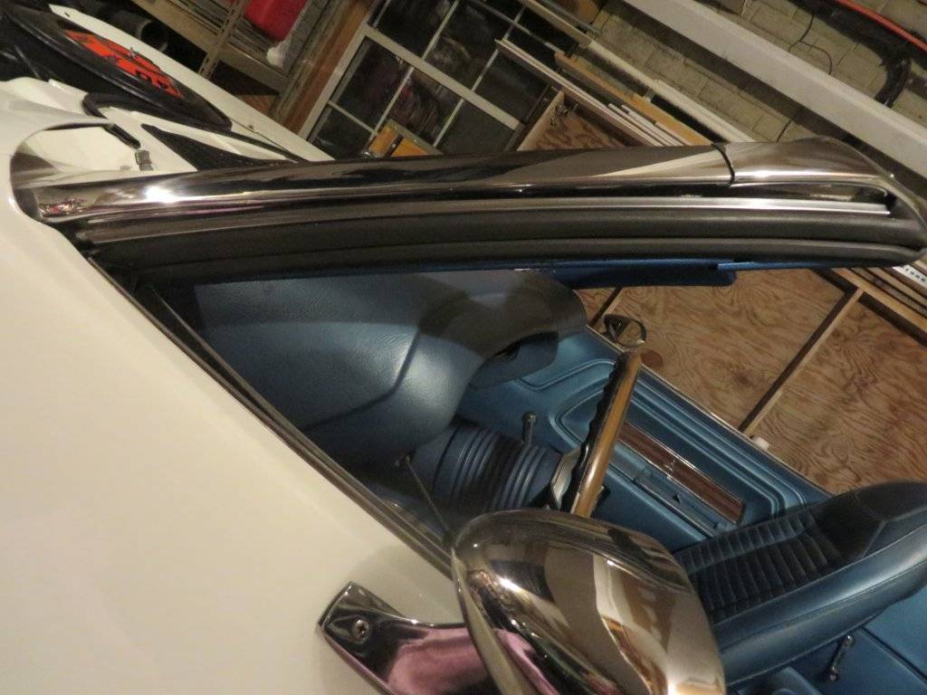

I disassembled the windshield trim and removed the windshield to cure some rust in the lower corners about a year ago, and I'm reassembling the windshield trim in preparation for installing the windshield. Something doesn't seem right about the A-pillar trim. The stainless piece that surrounds the a-pillar has a gap between it and the piece that hold the rubber for the door window seal. This gap allows the painted frame to show through. The gap is widest at the top of the a-pillar, then narrows in the middle and widens slightly at the bottom. I've attached a picture.
Is this correct or am I missing another seal or something

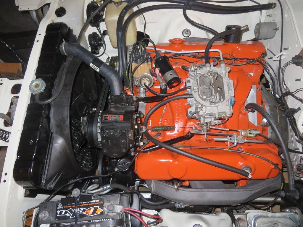

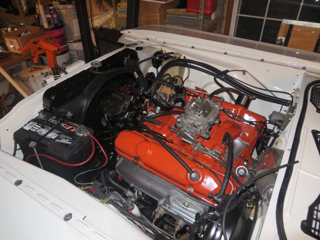

I started the rebuild of this engine in late 2011. Had the block machined and bored 40 over. Had the heads and valves done with the springs for the new cam I installed (specs close to HP 440 of that era). I assembled the engine and bought the Challenger in 2012. Started the engine swap in July of 2014. The 727 transmission was sitting in my garage since being pulled in 1985 (original to the 440). I drained the fluid and cleaned the outside of the trans, bolted it up to the finished motor and hooked everything up. The engine runs great and the tranny works (at least it will move the car forward and backward).

HooToTheCore

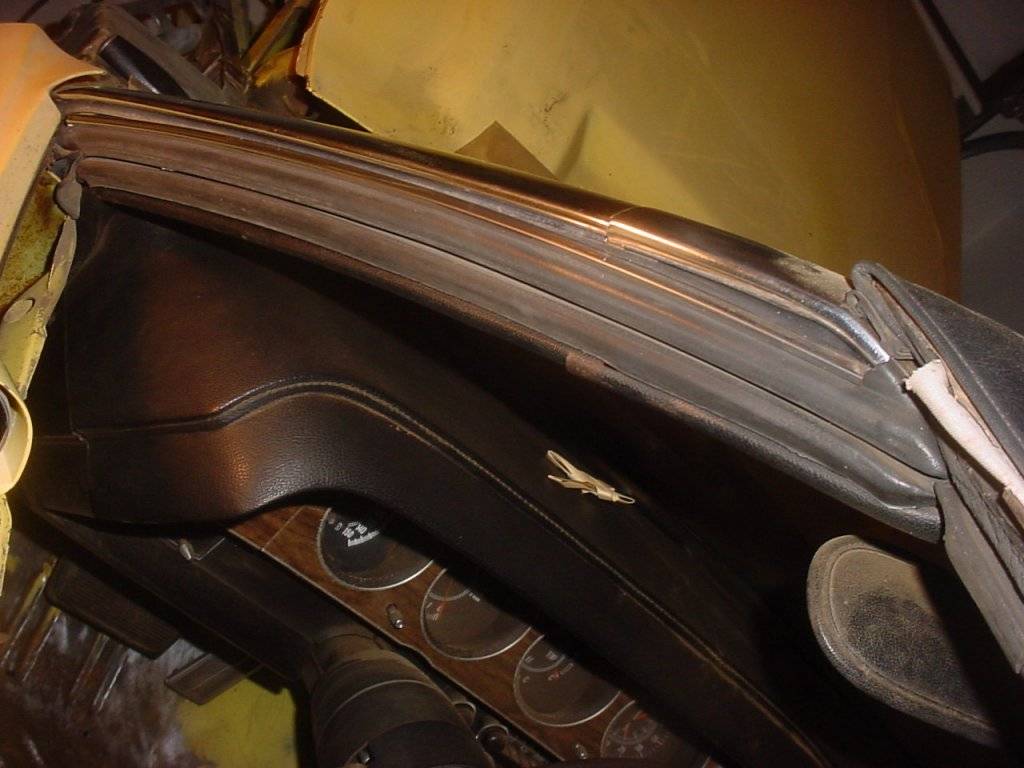

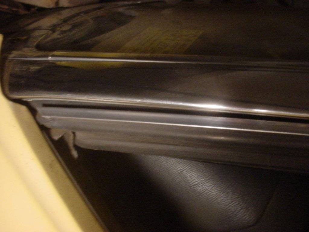

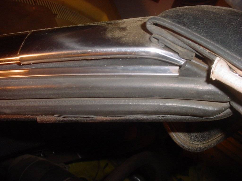

Some pics of my 70 Challenger A66 vert moldings
Car never apart
Hope they help!

HooToTheCore
Car never apart
Hope they help!
Thank you, thank you! Your pictures confirm that I have reassembled the trim correctly. Only difference is that my windshield frame was painted across the top when the body shop cleaned it up and some white shows through along with some flat black.
Do you (or anyone) know what type of screws attach the stainless trim on top of the windshield frame? I bought some stainless #8 3/4 inch oval head screws, but the heads seem a little big for the counter sunk holes in the trim. I could try #6 screws. Are the correct ones the screws with a shank between the threads and head?

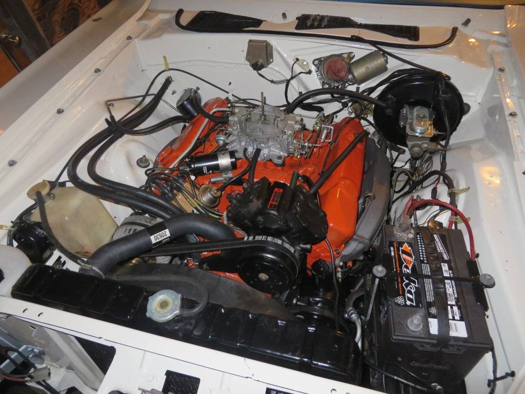

The engine room looks great btw.
