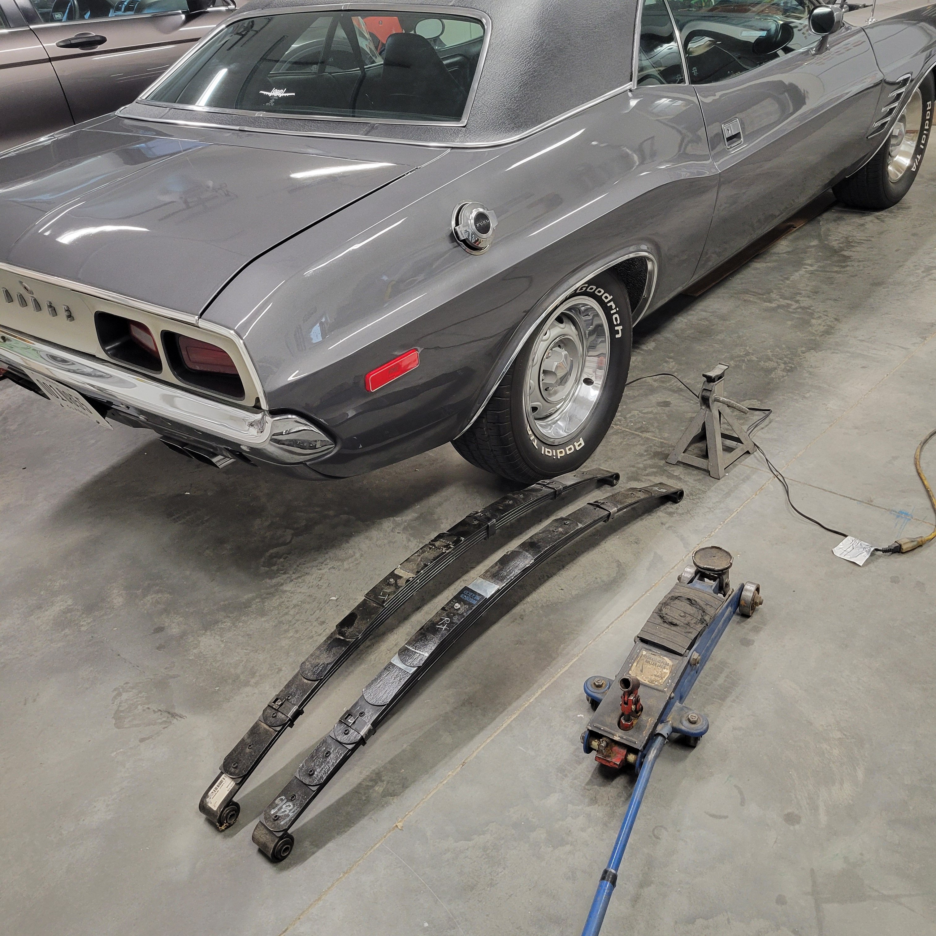

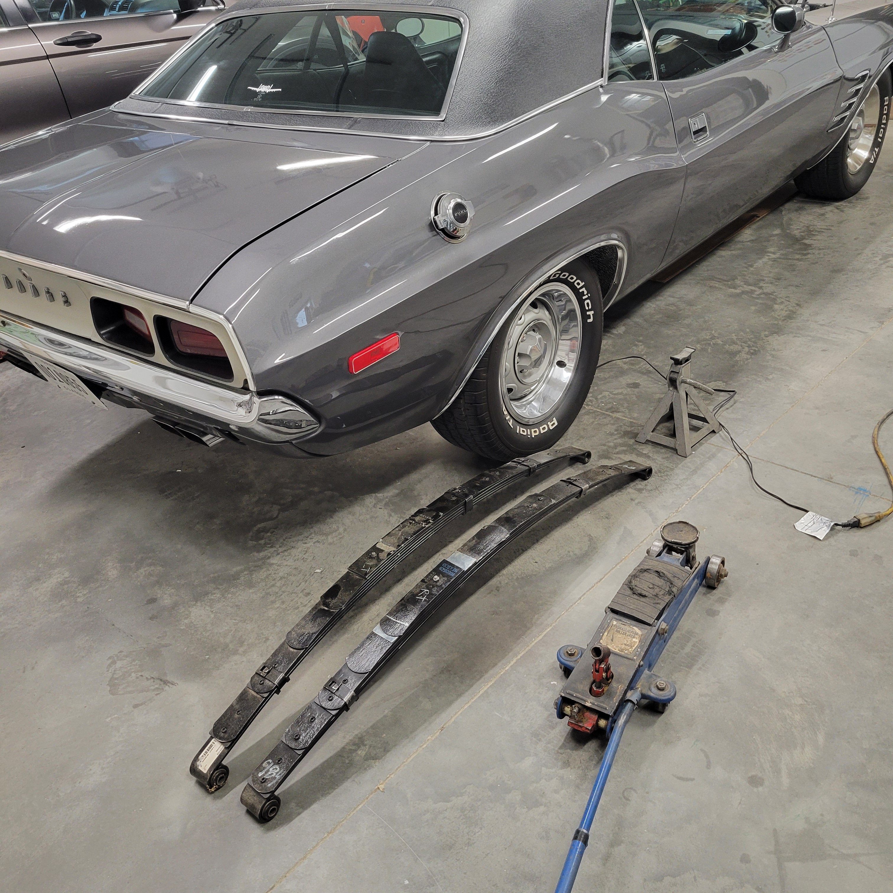

Picked up a set of Mancini Racing HD springs for 2 hundred bones - never installed. Going on tonight. Should pick up the girls rear about 3/4". Photos to follow. RearSprings.jpg

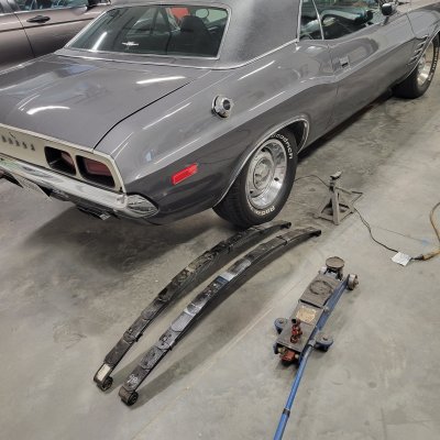

Found them on Facebook a few weeks ago. Guy selling them is the Chrysler district manager from our area and is happy not to gouge folks in the Mopar community. They were to go on another guys E-Body but Owner went another direction. Anyway, not much difference in ride height, and I really do not notice any difference in the ride. I might try and find someone that re-arches leaf springs and reinstall the original ones?

Agree with you in regards to the Mancini HD springs. No difference from my original leaf springs. Ugh.
Add 1 full leaf under the main leaf , clamp the front section & add a couple of 1/2 leafs forward & you will see a difference !!
I took off a set of custom rear springs that I had made 10 years ago for the roller/ported/stroked 360 in my 72 Challenger. With the new 512/aluminum headed/solid roller/ N2O motor I figured I needed the big block super stock ones. The old ones allowed the small block to run mid 11s thru the muffs, driven in from the street back then.
