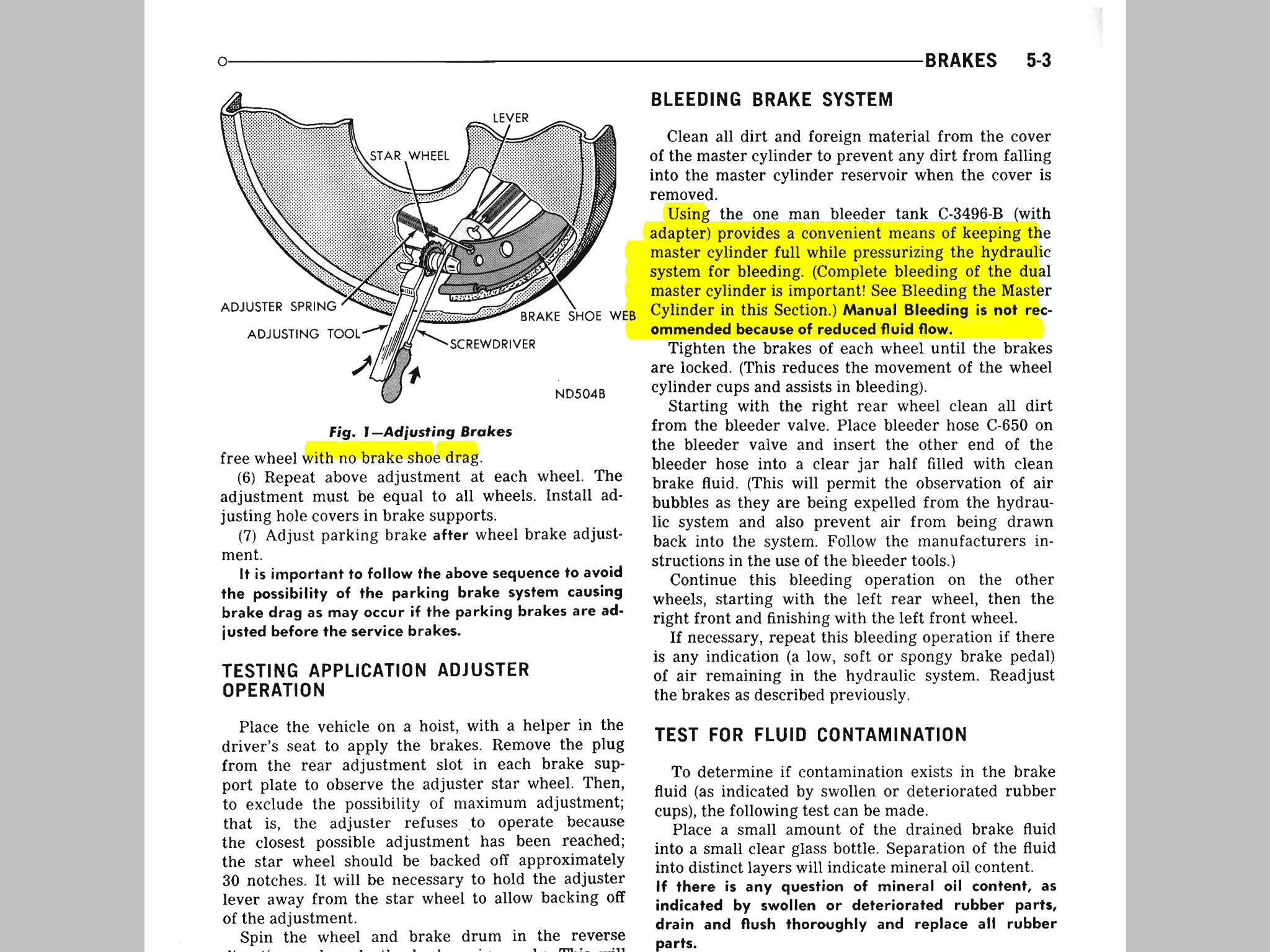

If the master is bled, safety switch is centered and the rubber brake lines are good internally the FSM recommends pressure bleeding because manual bleeding has reduced fluid flow. I’ve had excellent results with the Motive pressure bleeder. Hope this helps.

@70chall440 What issue of Mopar Action is that in? Is that tool available from somewhere? I replaced all of my brake lines in my car and I have been looking for a way that I can bleed the system by myself. I fear I may have the same problem as the OP.
bc3j
Oct 17, 2013
101
53
Cleveland, Ohio
I found the C-4121 tool on E Bay. Believe it was made by Miller Tools. Easy and simple to bleed with the tool.
