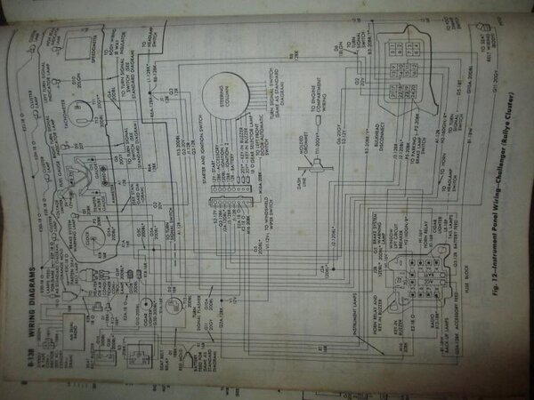

Thanks Tod ,yearone sent me a 20% off so I broke down and bought a new harness. Had a drain on the battery before this happened. I do have a diagram just thought it would be better since the harness is 40 years old. Thank you to all who chimed in to help. I Asked slotts first on the harness but he was to busy.

well a year later and I have the dash harness by yearone/mh. FINALLY INSTALLED and put key in and set at accessories and the starter kicks on. So called M and H and they say it has something to do with the yellow wire.Yellow wire??? ok so he looks it up and they dont even have a 74 service manual.He looking in a 72 service manual. So how do the make the harness??? All plugs are super tight so be careful. Hoping to get it figured out this weekend.

so they reversed 2 wires on the ignition switch connector. yellow and brown. Switch them around and now the car works.

Glad you found the problem and got it fixed. You should let Year One know this so that they can pass it along to M&H to correct it. I doubt that you were the only one who had this problem.
