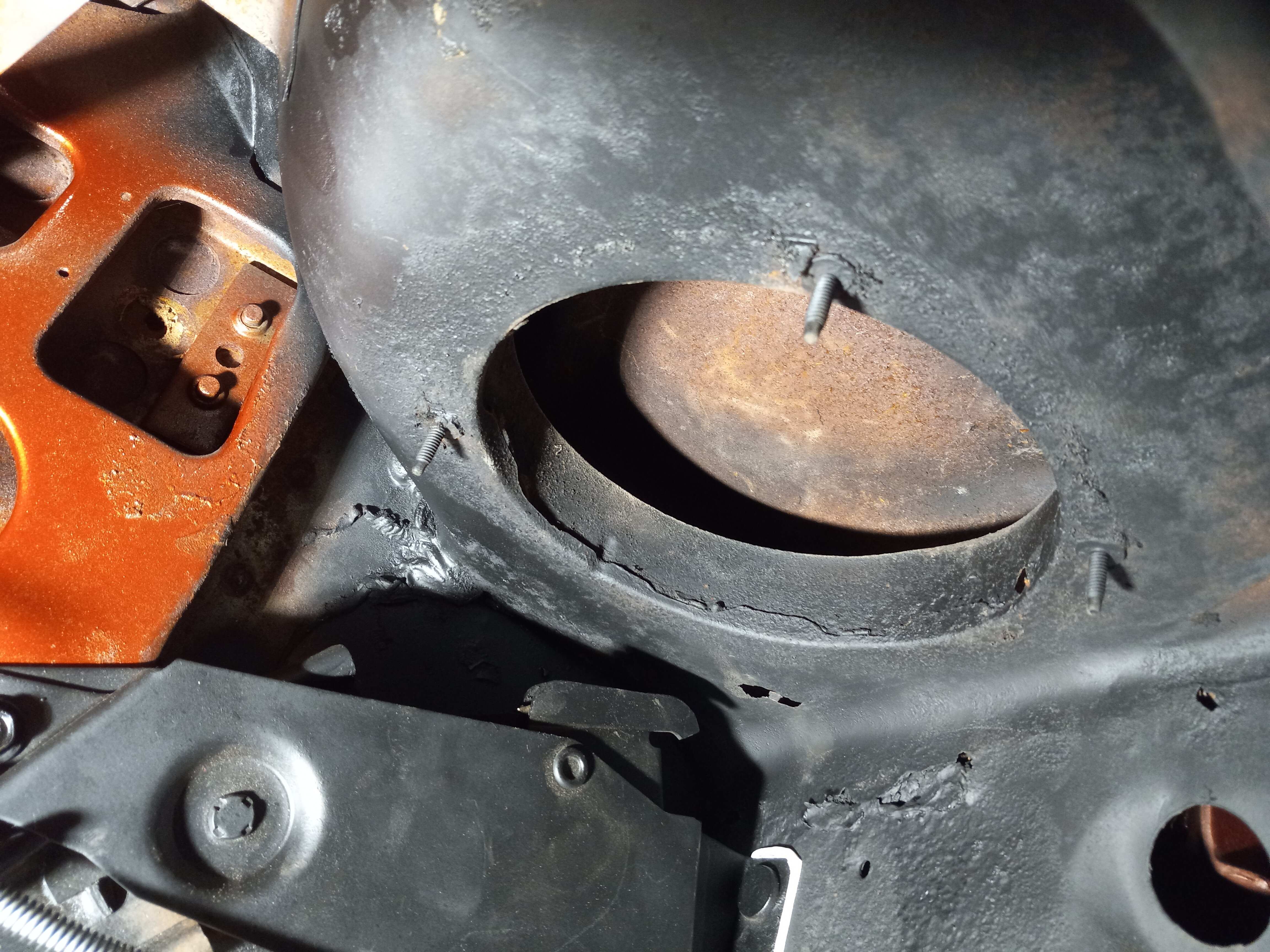

Give me a minute, I will send a pic. I am at the same point getting ready tomount the dash

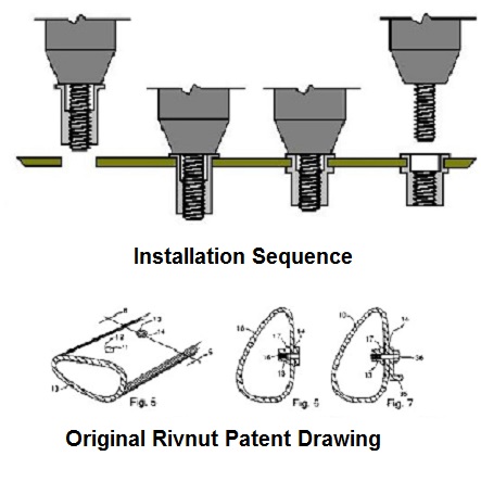

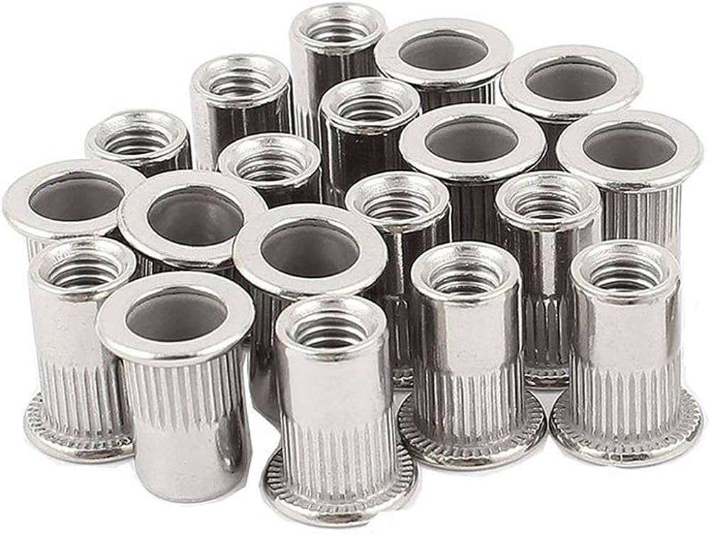

Originally 3 studs were tack welded to the bottom of the cowl so there are no holes for water to leak in.
you could use rivnuts & seal the threads
The whole is 7in. With 3 bolts to hold the fresh air box.

Of you don't have the ability to weld the three studs on, you can certainly drill holes and use rivnuts like Chryco Physco suggested. These actually work very well.
