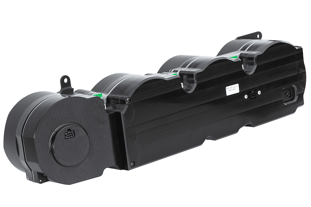

Dakota only includes the gauges. I still need the housing that holds the gauges and switch bezel I think. I found this but not sure if i need anything else. Seems expensive to me.
Not sure what else i would need.

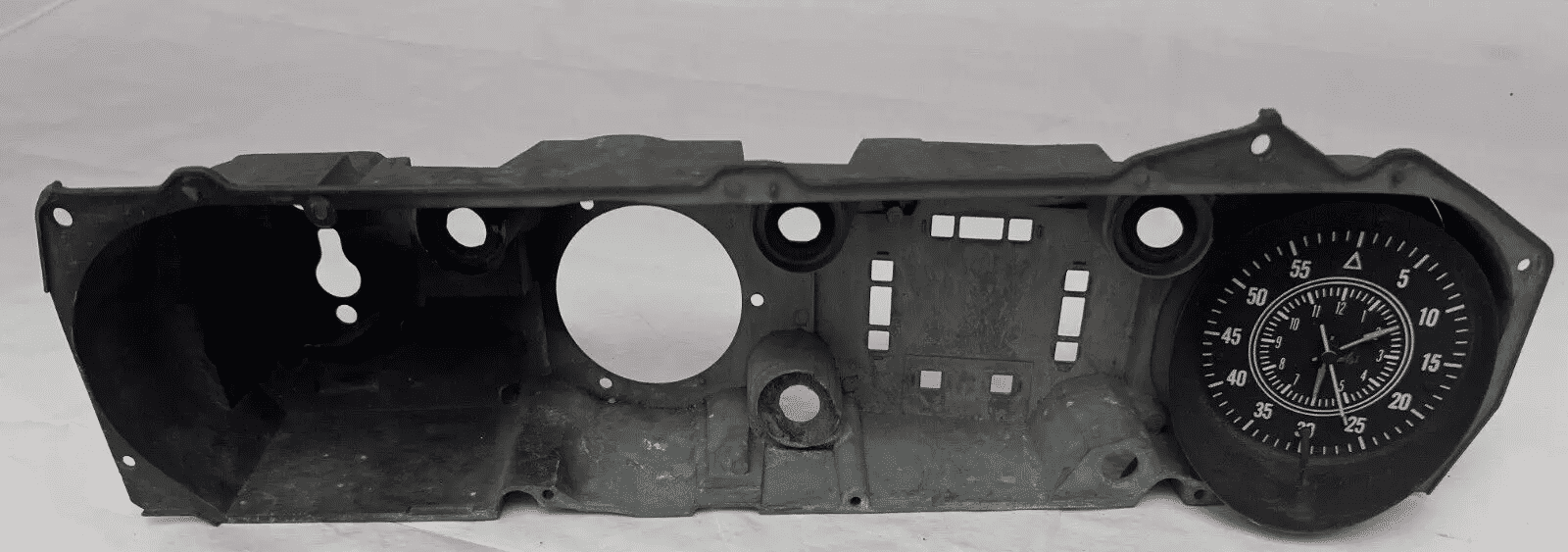

Maybe they sell a gauge-only kit, good to know. The RTX shows a cluster housing. If you need the OEM cluster housing, ebay may be an alternative, since the housing doesn't show, you can buy a crummy-looking one for less. But vintage rallye cluster parts are in demand and not cheap.

When I called them, I was told they only show the wood grain bezel for display. When you purchase the gauges you only get what is pictured above. I need the housing any any additional trim pieces.

Bingo. Now I understand. I was presuming the housing was this (shown with clock gauge):

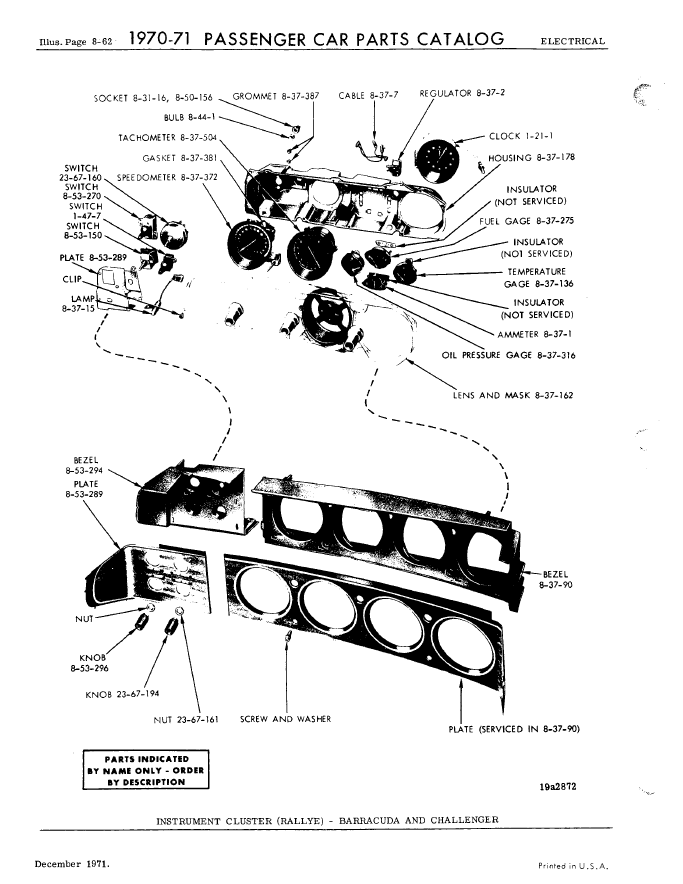

Here is a breakout from the Dealer Parts Book. So, you're looking for the parts in the foreground, the Bezel (8-37-90) with Plate (often paired with 8-37-90), and likely the left-side Bezel and Plate? Do you want and have the left-side switches behind Bezel 8-53-294?
Not shown by the image above, is the light bar above the gauges under the lip of the dash pad, but you may not need that since the gauges are self-illuminating. You still may want it so the assembly looks complete.
Just my 2¢. I refer to that as the surround. 8-37-90. And the surround wood plate. As far as the gauge housing. I refer to it as the gauge cluster with all the gauges. That could be wrong.

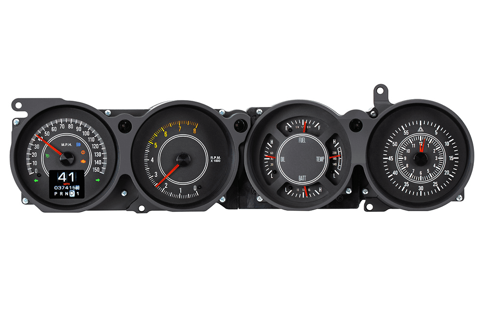

Dakota digital Rallye gauges look great and function properly. I went with white facings. If I had to do it all over again, I woul've waited for the black facings but they were 9+ months out for delivery. Classic Industries have replacement gauge/switch panels. I changed them all so fitment issues didn't arise. Everything went back together well. I had a custom shop install the wiring to convert on my 72 Barracuda.

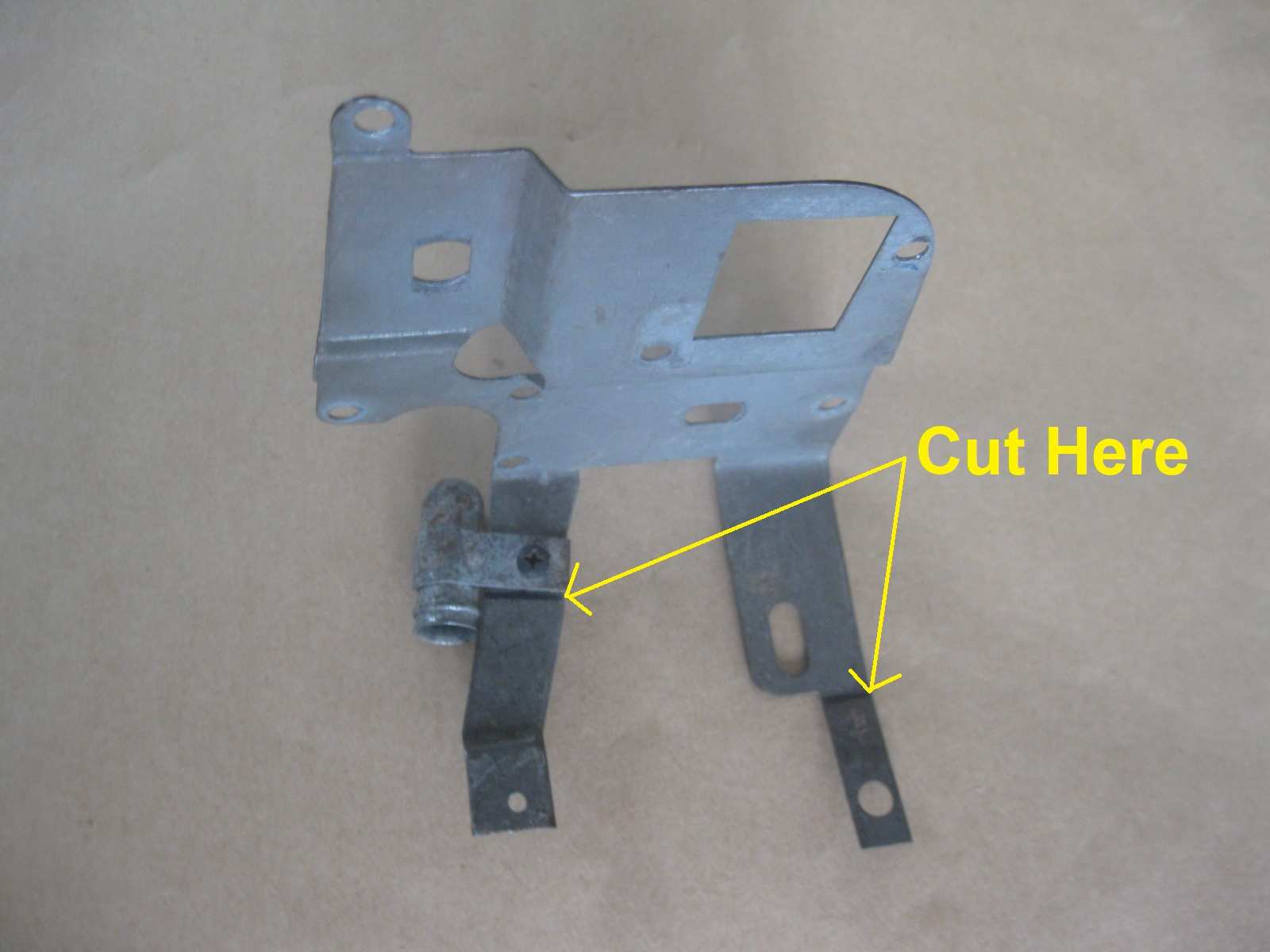

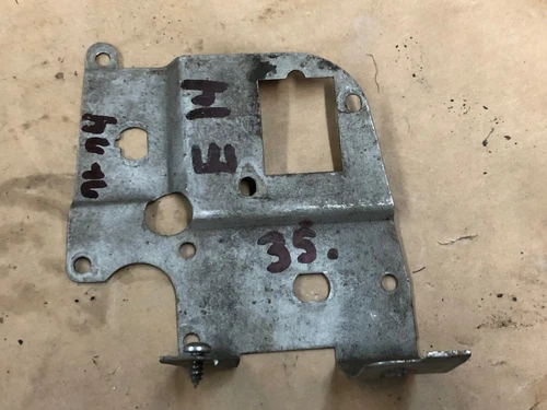

I did it awhile back and another piece you'll need is the metal backplate that holds the switches in place on the rallye bezel as the standard one won't work. I picked up a used one from eBay.
I used my light bar from the standard gauges but will most likely not put any lights in it as the gauges from Dakota Digital are well lit already.
I think it is well worth doing.
