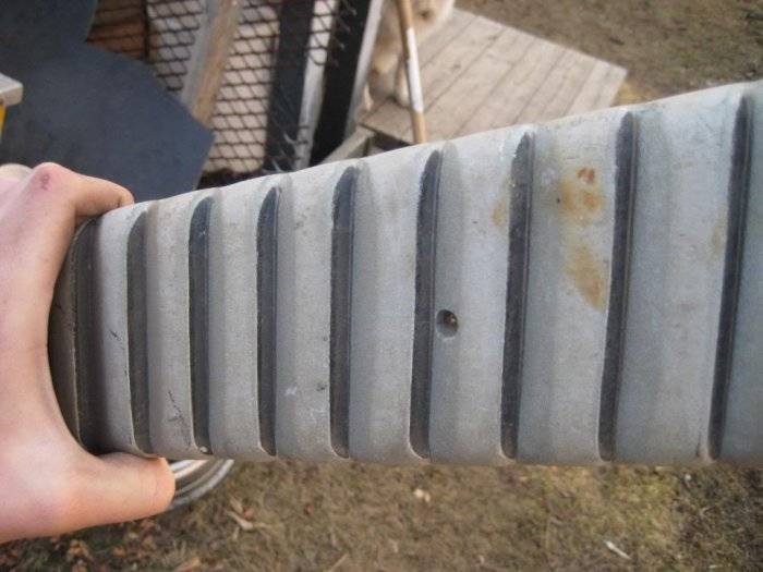

Can someone post a closeup photo showing paint details of an original unrestored but not abused '70 CUDA rocker molding?
My rocker gill molding on my convertible has what I would call "old school" rocker paint. It is a medium silver but with little black speckles in it. I contacted one paint shop to get some of the dark argent paint and they said it is supposed to be a flat semi-textured dark argent on the gills, but black on the back side of the gills. Any comments or suggestions on that subject?
quapman
878
225
There was a good thread on this recently, maybe on Moparts? If I recall, the texture is molded into the moldings, so no need for textured paint. I think the black speckles are just overspray from the gilled side.
challenger6pak
Feb 27, 2011
4,037
897
The mouldings are textured. They are silver and black. Here is a pic I saved in the past from the thread quapman was referring to.
