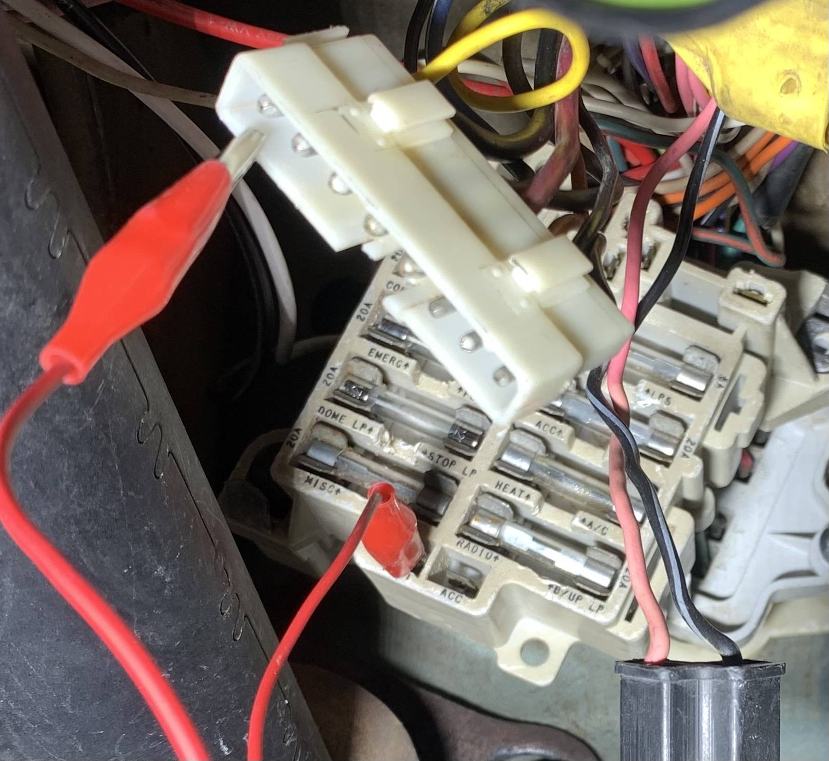

I didn’t see your edit on the last post until now. I jumped the red and brown wires and started getting smoke. Aborted that mission.

Yes, by the jumping the brown to red I get smoke. Same happens when I jump the red to blue/white. That photo was just to illustrate the small gauge wire I’m using…sorry.

Okay. Tried with a heavier gauge jumper and no smoke. Jumped 12R to IGN2 and it started. Continued to run when I disconnected the jumper to the yellow. Tried the same by jumpering 12R to IGN1 and same result. However, I realized that the turn signal was engaged for both tests. I tried each test again with the turn signal disengaged, no start.
I suspect I have multiple problems, because now, when I jumper the yellow to the fuse box, I get nothing. My test light says there's juice going to the battery terminal on the fuse box, so I'm thinking bad connection on the starter wire (yellow).

Snap fuse box out of place and exam en the wires on the back of fuse box and bulk head connector. mostly the red wire from battery and black wire from alternator. they are the high current draw.
Pay no attention to the other battery feed red wire you don't have one.

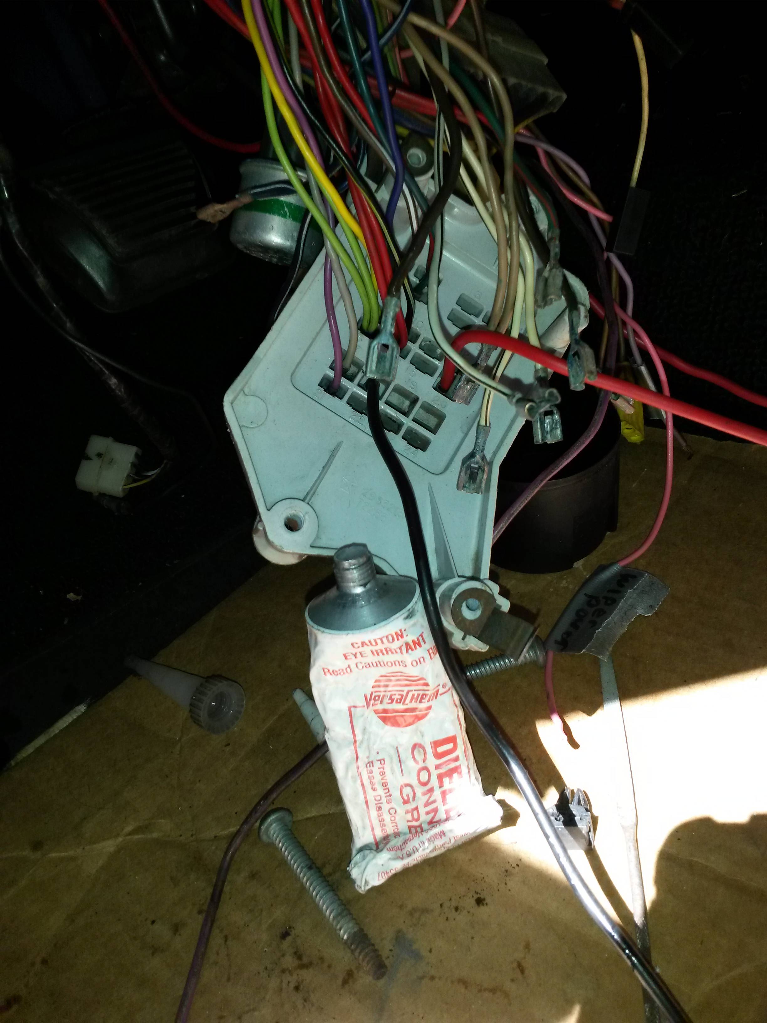

This is what happens to the brown ign start wire from constant starting.It feeds full power to the coil to start.where as the run ign goes through the ballast reduced power.

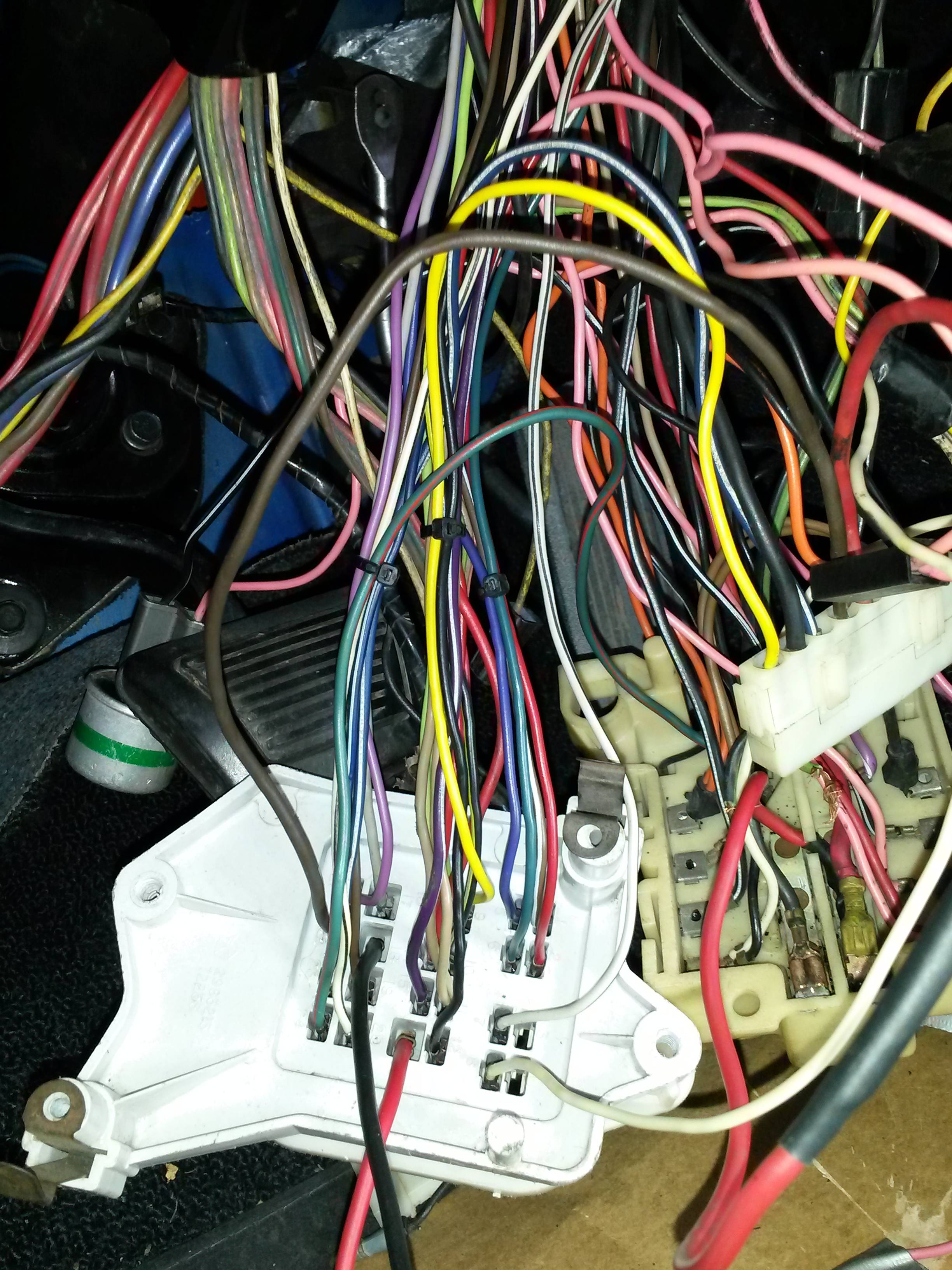

You may have to open the harnes up like this. Zip tie in groups to keep it together for re taping. I was replacing the bulk head connector.
