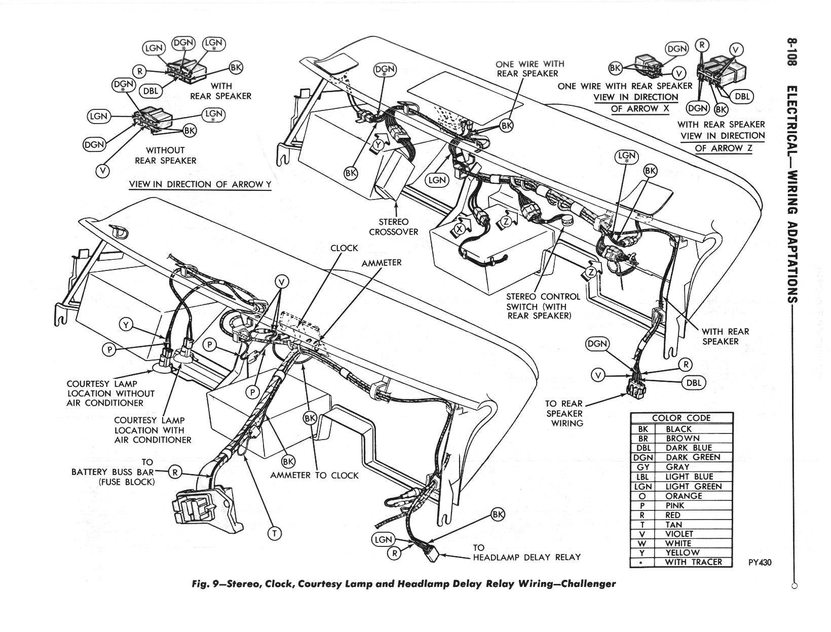

Thanks. One of the first steps I took was to open up the harness and inspect for damaged/melted wires. So far, I can't see anything obvious, but that doesn't mean it's not there.
I ran out of time yesterday, but I'll try to get back to it tomorrow.
Challenger RTA
Oct 28, 2018
4,502
2,489
PA Flood city
When you get to it. I'm thinking any wires that carry a heavy load would be suspect. Battery feed to amp gauge alternator to amp gauge,things of that sort.
