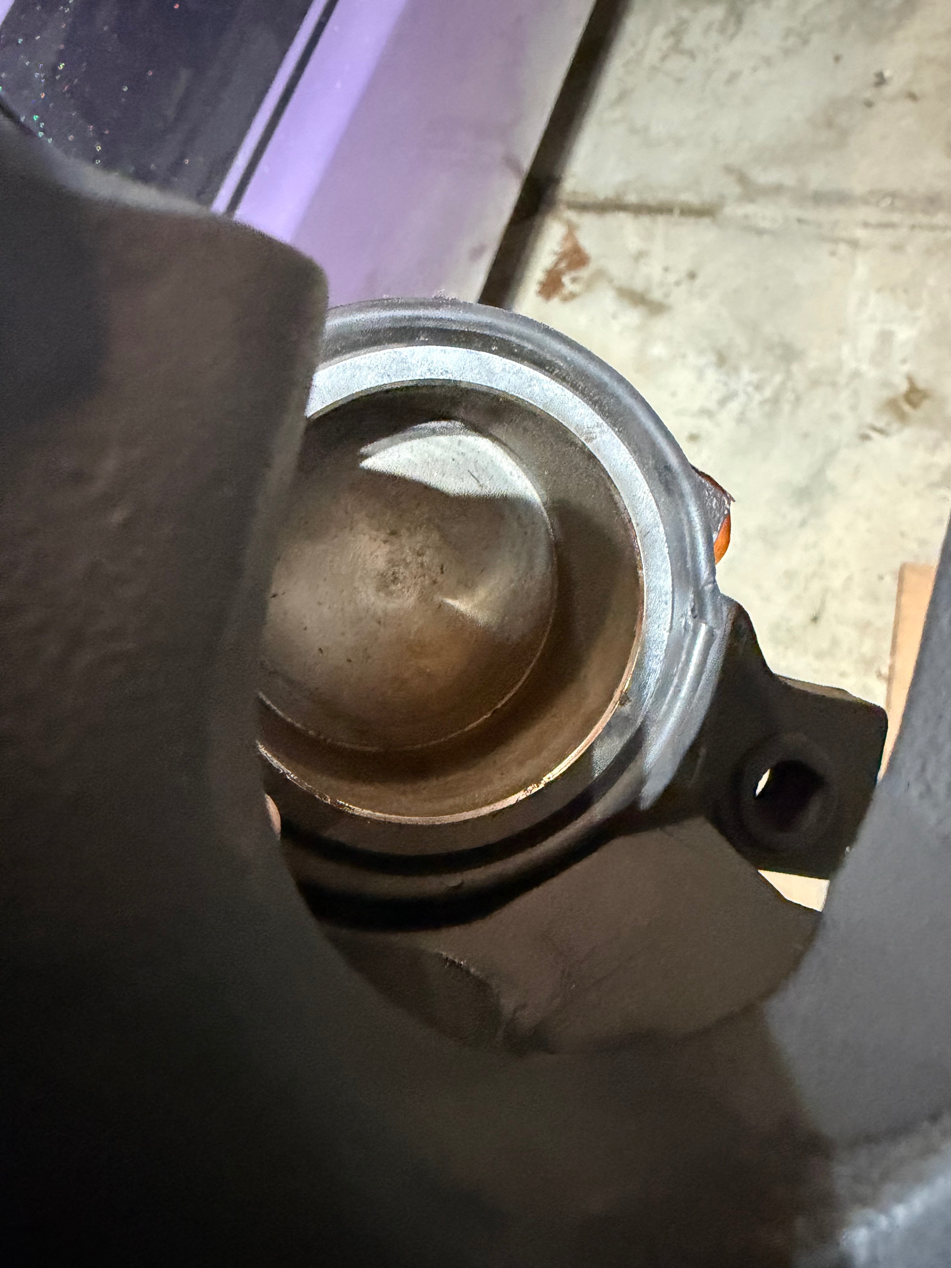

Accidentally dropped this Caliper and noticed a tear in the boot. Do you guys think it is acceptable for install, repairable as it sits, or fatal and must be replaced?
Most kind
It will work for now. To move it around and driving around until you get the a kit. That would be the time to do both. Not knowing if it was tore before. You don't know if the there is rust in there.

Thank you for your response. The tear was much worse looking once it came out, and am glad I changed it.
