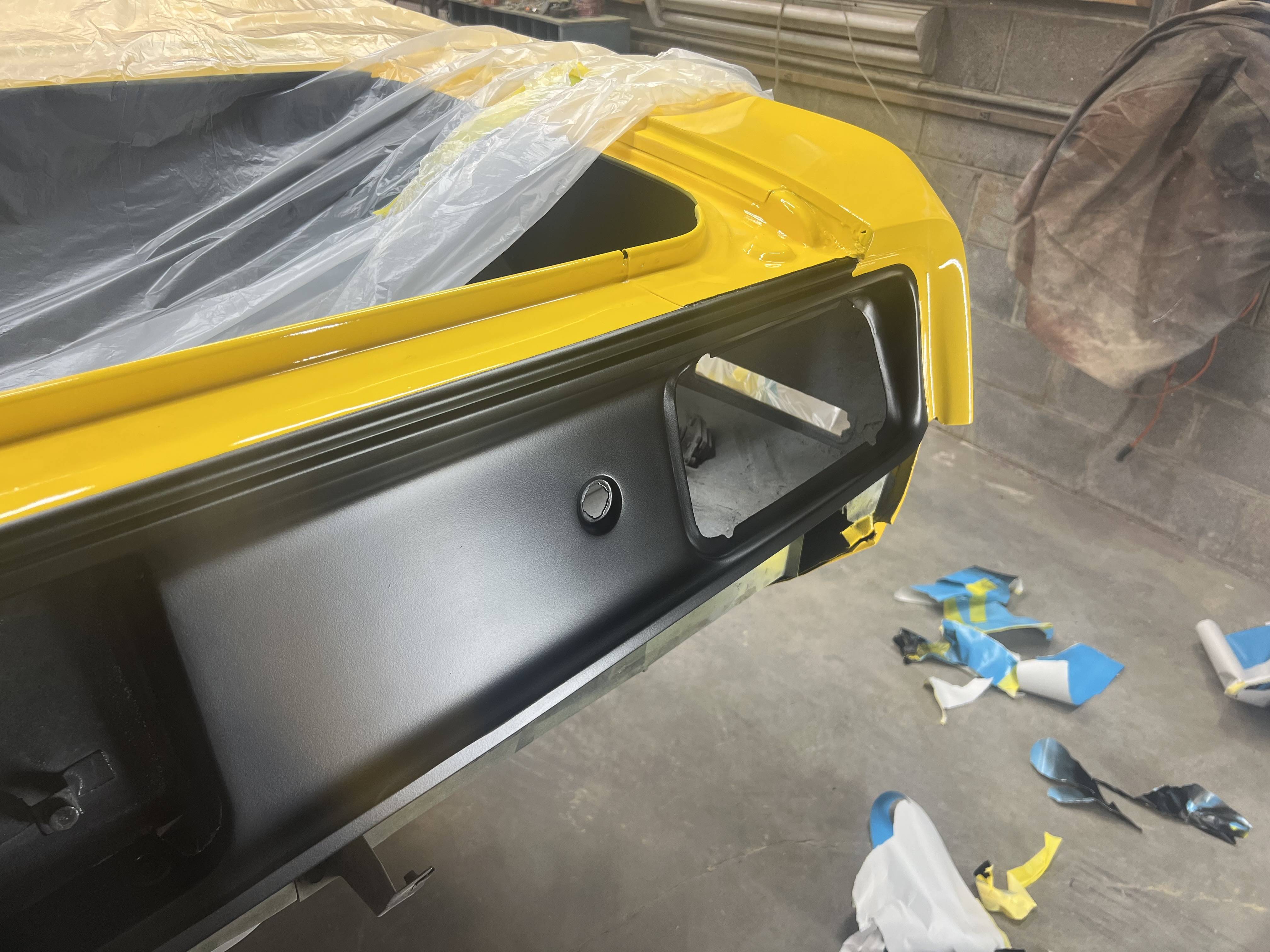

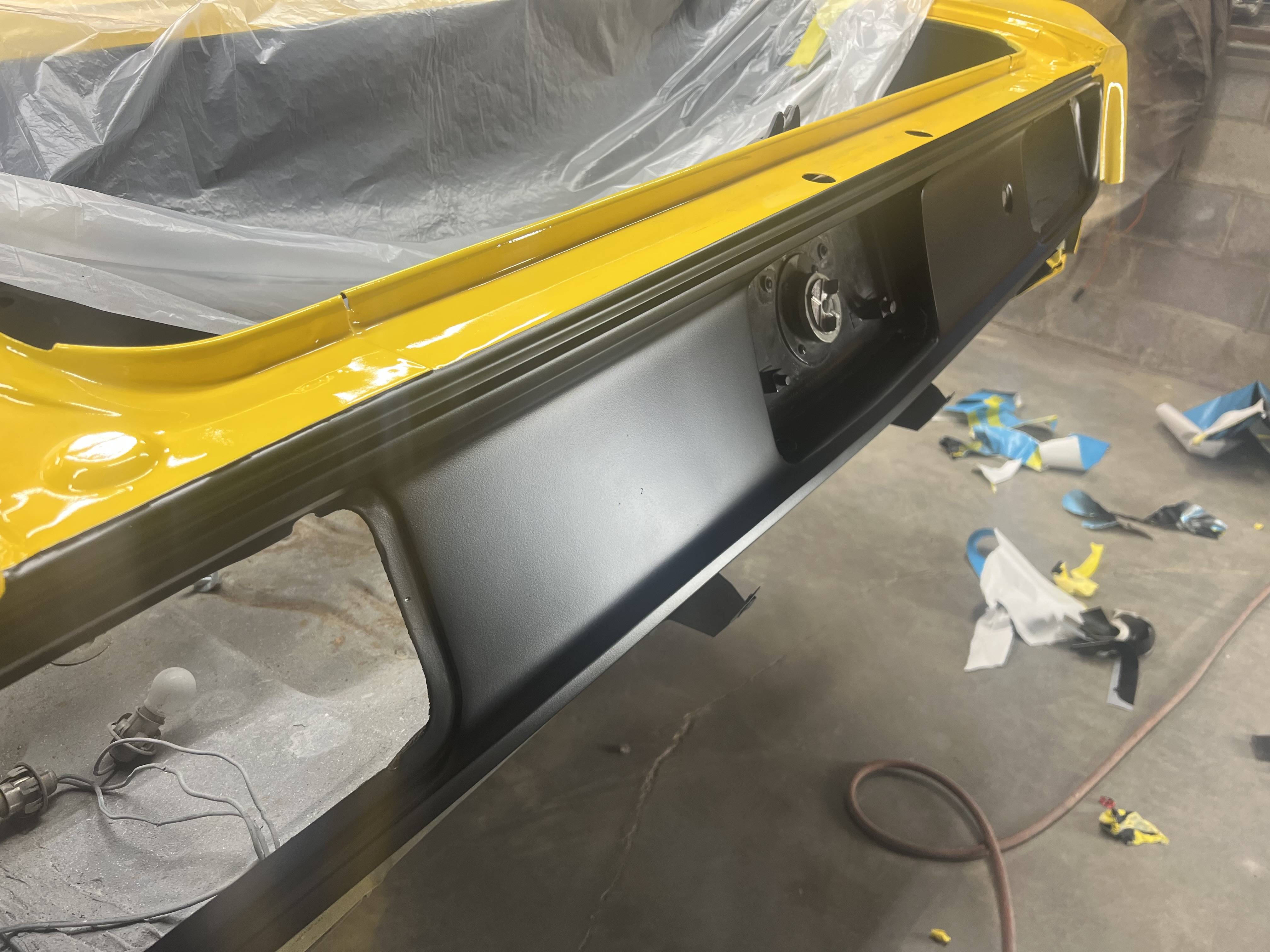

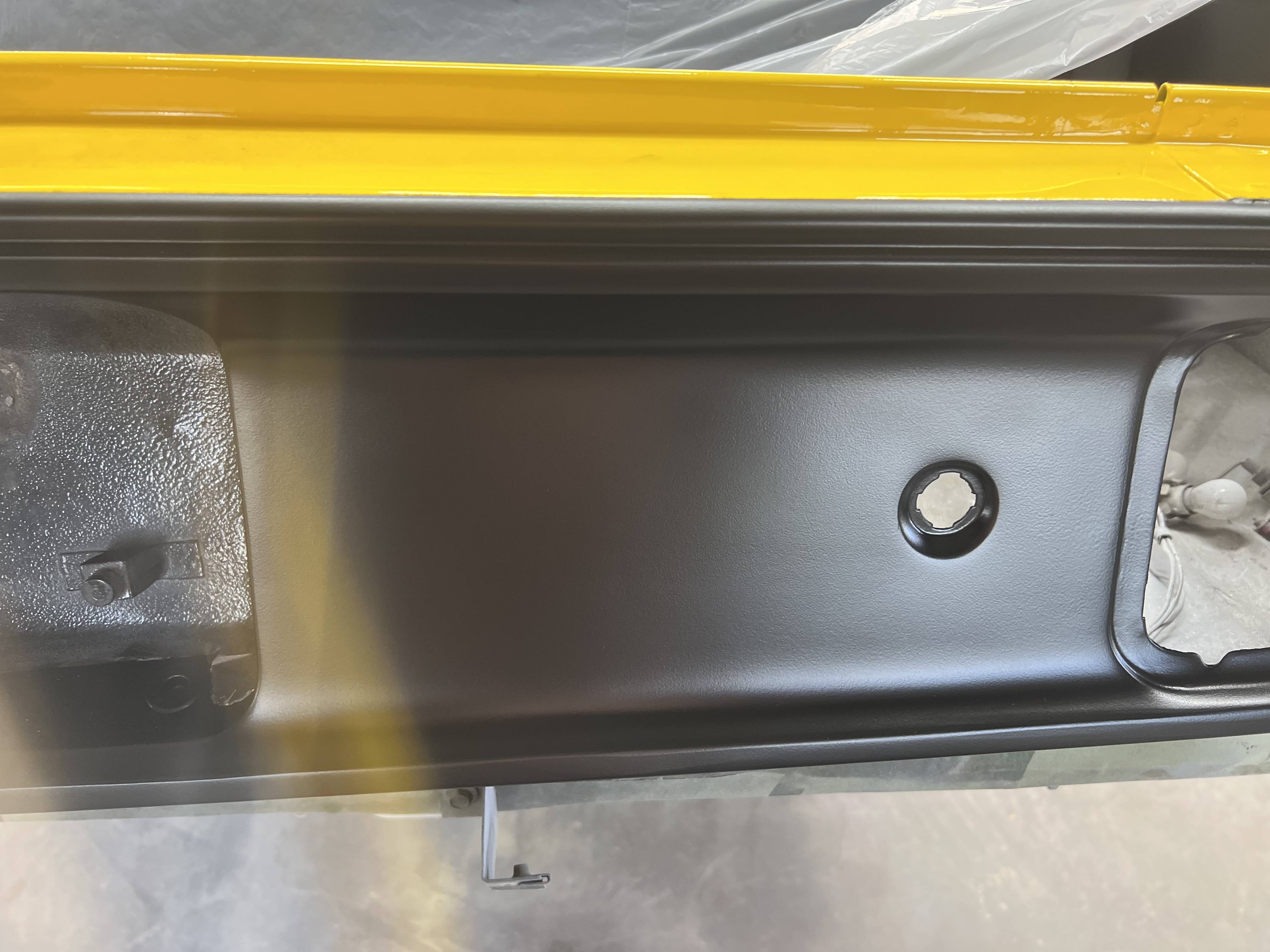

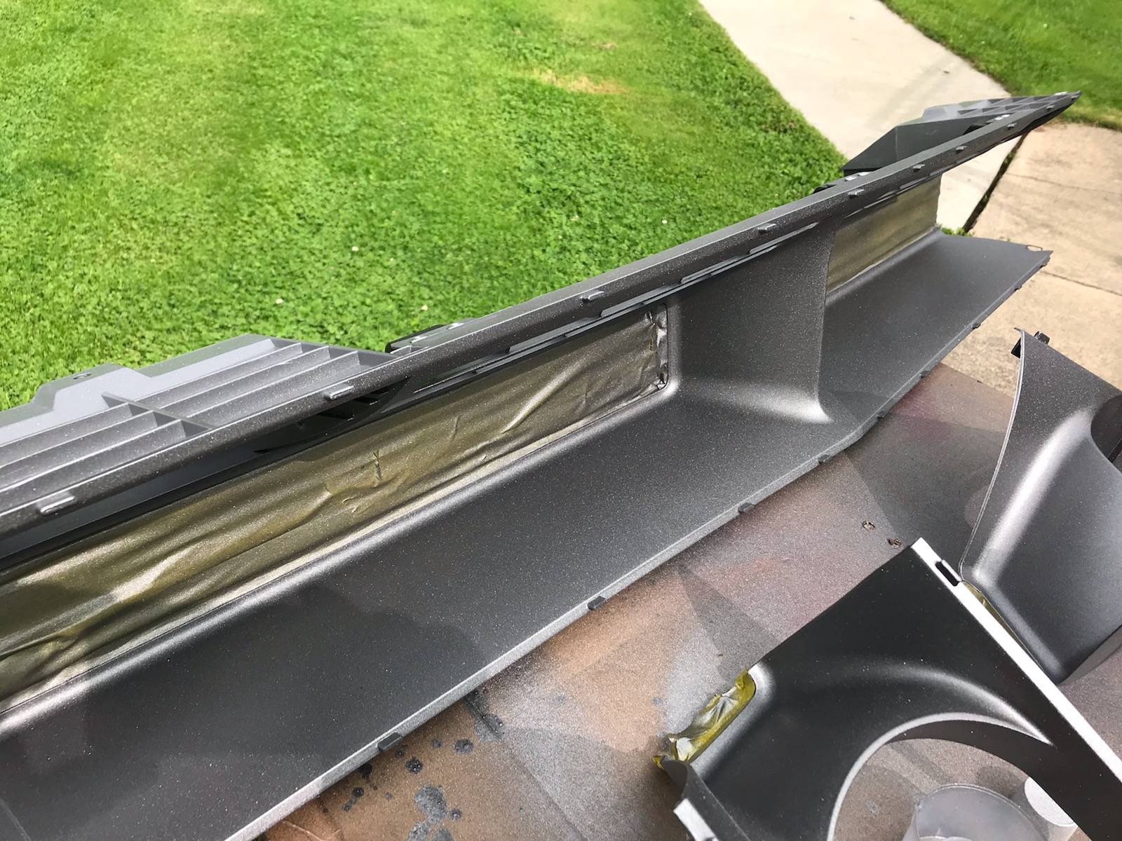

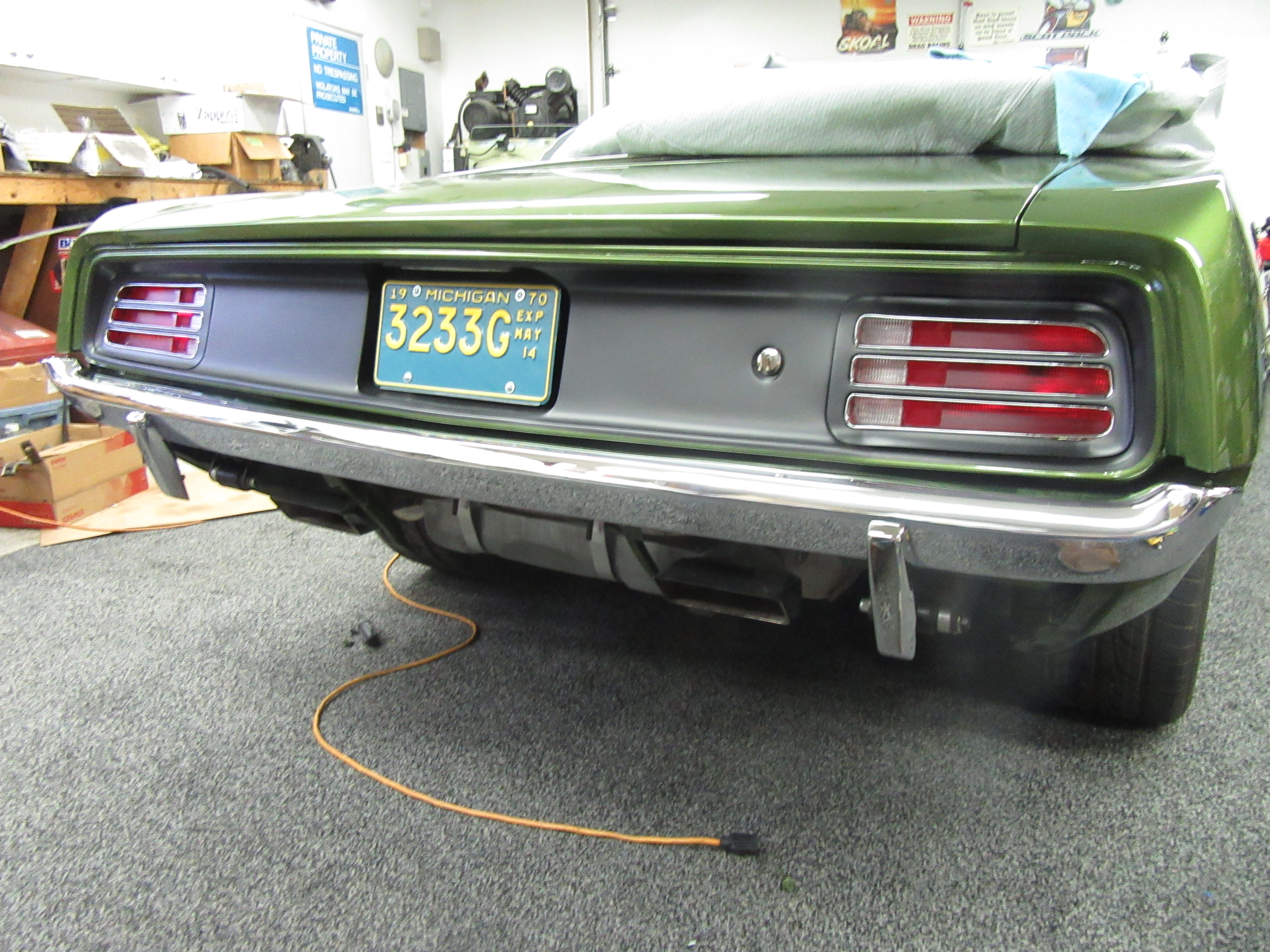

I used "OEM Paints" for Organisol, (70 Cuda Tail Panel) Light Argent, (70 Cuda Grill) Blackout, (70 Go Wing) also their EF8 single stage in rattle cans for my engine bay. All excellent products. My painter was also impressed with them. The Organisol and Argent have a very nice texture.

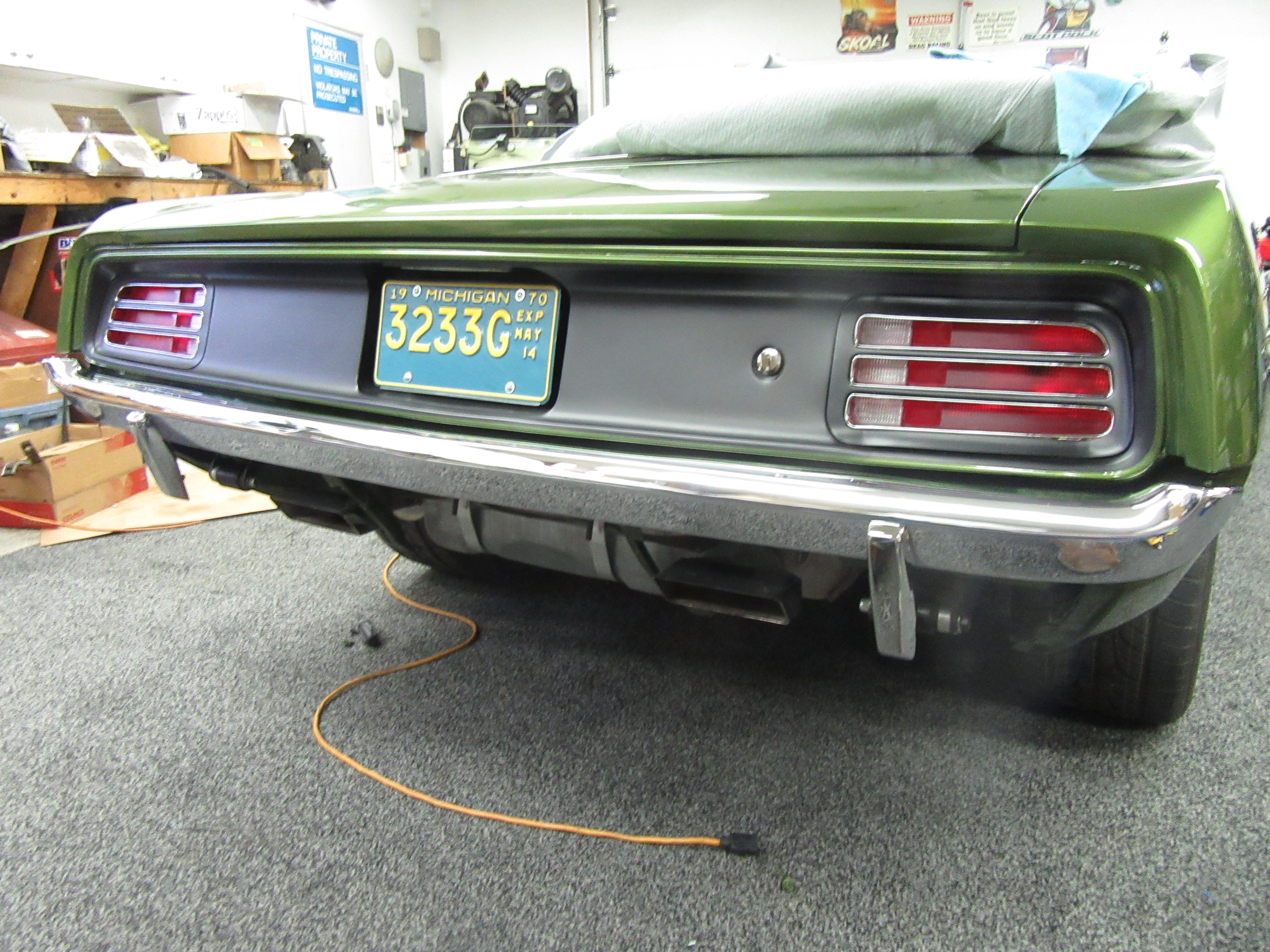

I have spray-cans of most of his products. I've used the dark-argent, with great success. I chose to use a smoother/bit glossier paint on my rear panel. It collects so much dust and dirt, back there. It cleans in a few seconds.
