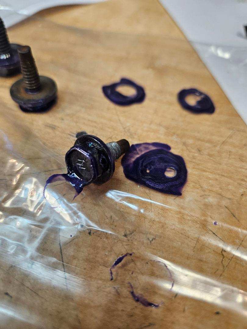

I'm trying to paint my fender screws to match the body color. As it turns out, it appears my screws are the "black oxide" type and won't take paint well. Does anyone either a) have any suggestions of what I can do to make those screws take and hold the paint? Or, b) what type of screws are better for painting? I'm using the regular enamel touch up paint for my car, Plum Crazy purple. Thanks.

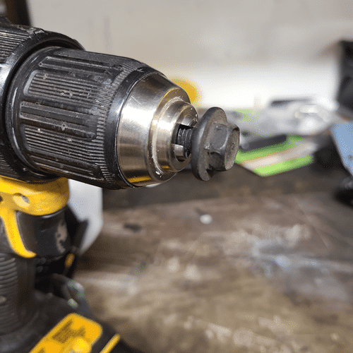

wire wheel should work but ditch the vice grips and use a battery drill with a keyless chuck. Won't harm the threads.

Thanks for all the replies and suggestions people! It turns out, very likely, that what I've got is a "touch up" can of paint, which may have been formulated only for spray guns, and could be extremely thin. This could be why I had trouble getting the coverage on the parts. Because I also used this can to cover my new door hinges when I installed them, and it did the same thing.. bad coverage!
