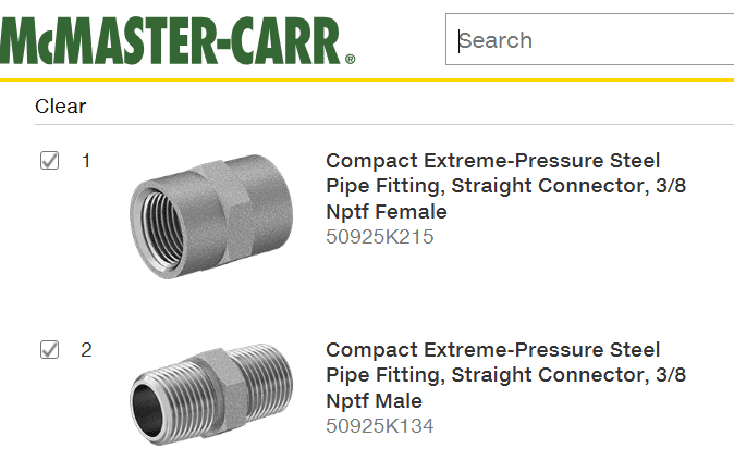

Out of the box, what if you shorten up the tube and add such as this for the necessary length?
