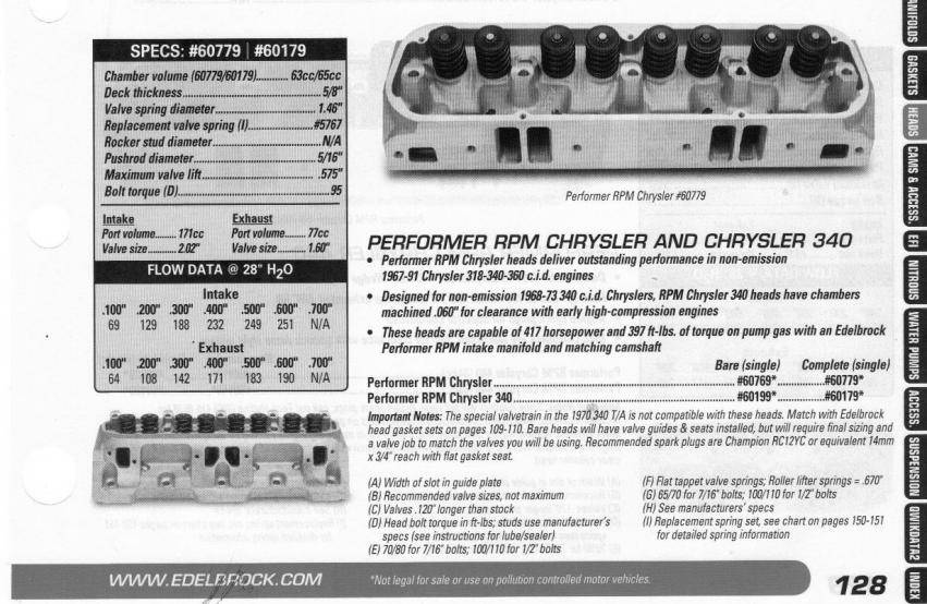

Okay, just talked to a local mopar guru and come to find out there are two different Edelbrock heads available for the 340 and I have the wrong set. I obviously need the set that has an extended chamber to capture the full piston dome. Thought I'd pass it on. So, I will now sell these aluminum heads. I'll post them for sale here first, along with the adjustable rockers & shafts from a 273.

Edelbrock mopar head i.d.
Here you go Juan.
More stuff for the scrap books guys.​

moparleo, let me know if you got my response to your PM, not sure I did it correctly. Thanks for the head info above!
