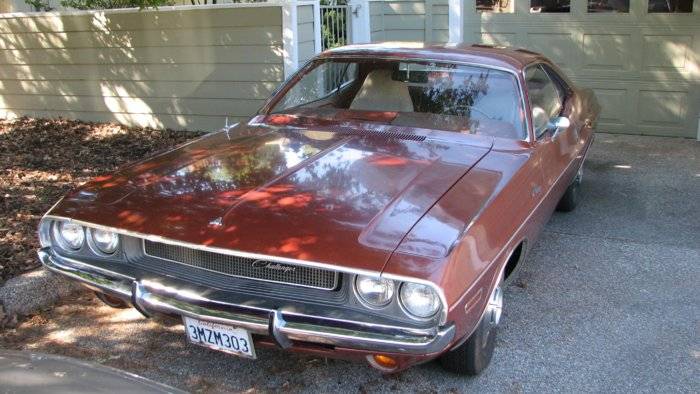

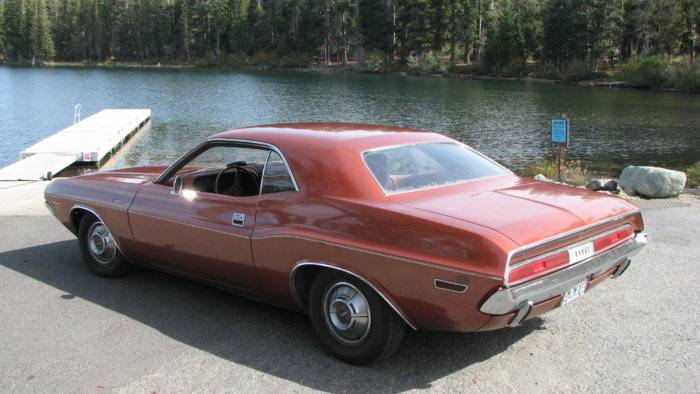

You honor me sir. I'd be glad to post some pictures of the Challenger. It still runs perfectly and always starts and drives even after months of storage.
Driving that Challenger is actually a pleasure. It handles great for what it is and it sips gas.
I'd bet most E body owners wouldn't touch it with a ten foot pole but it is interesting to see what an E body can do with a modest OE+ suspension and without a huge hunk of V8 iron in front.
People give it some odd looks and want to know what it is in gas stations. I still get thumbs up even though it is no Hemi car. I intend to keep it the way it is. Butchering it to put a big engine in it would be a crime.
