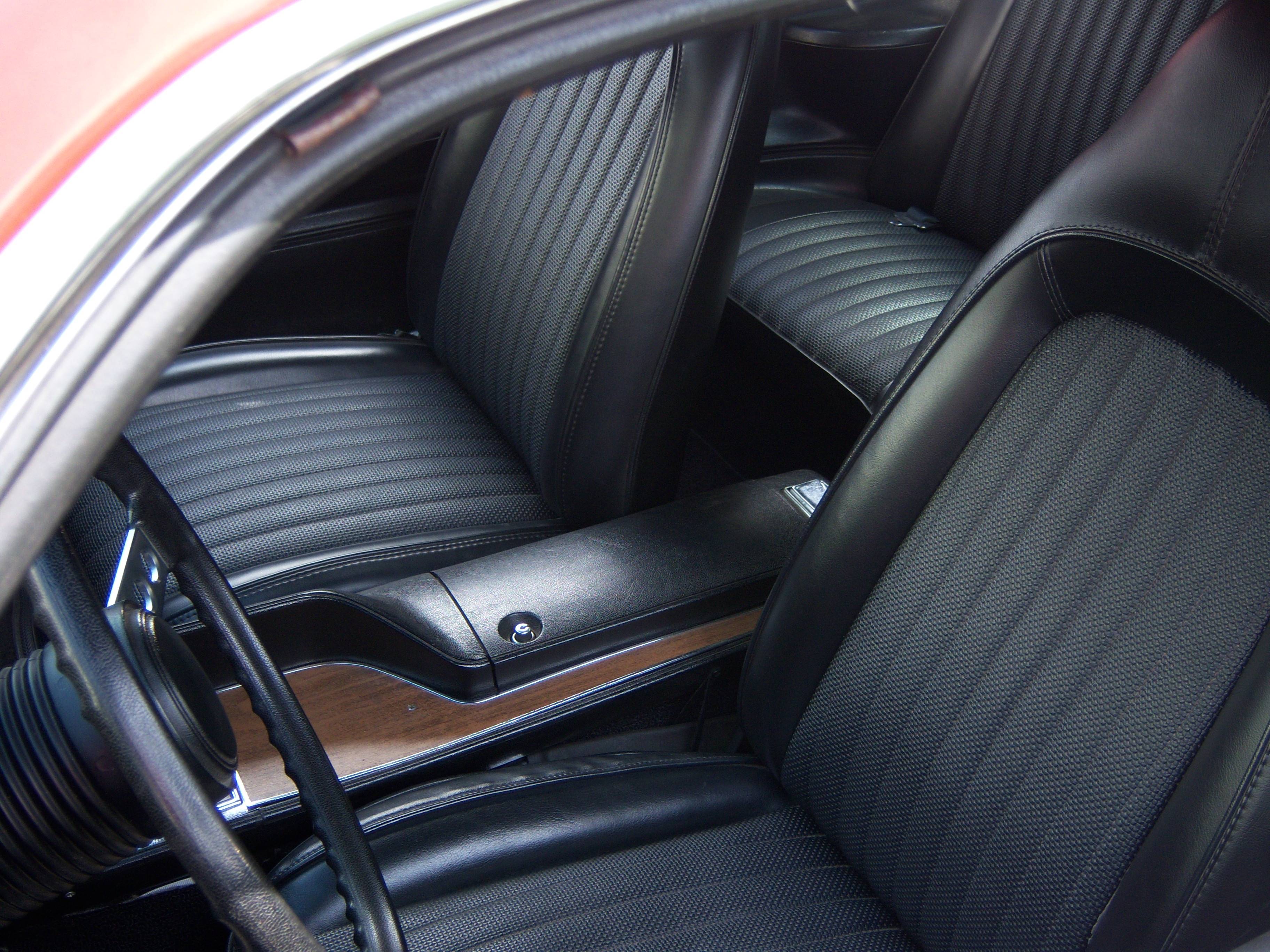

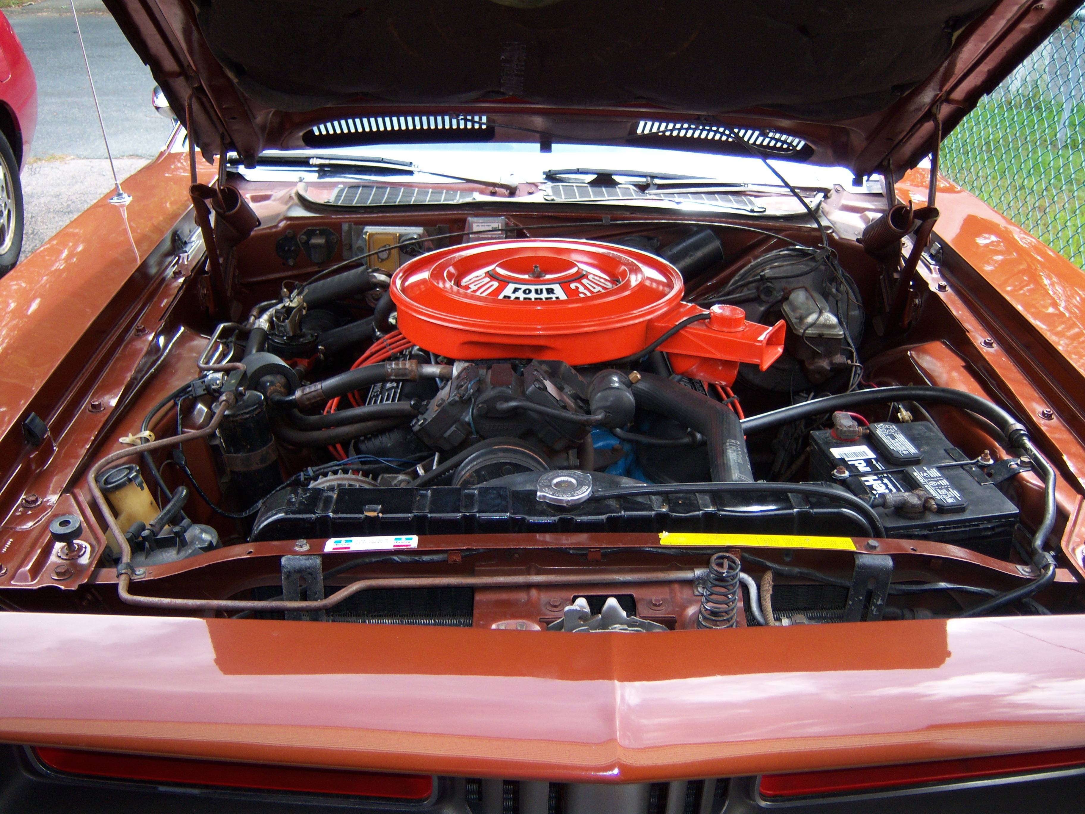

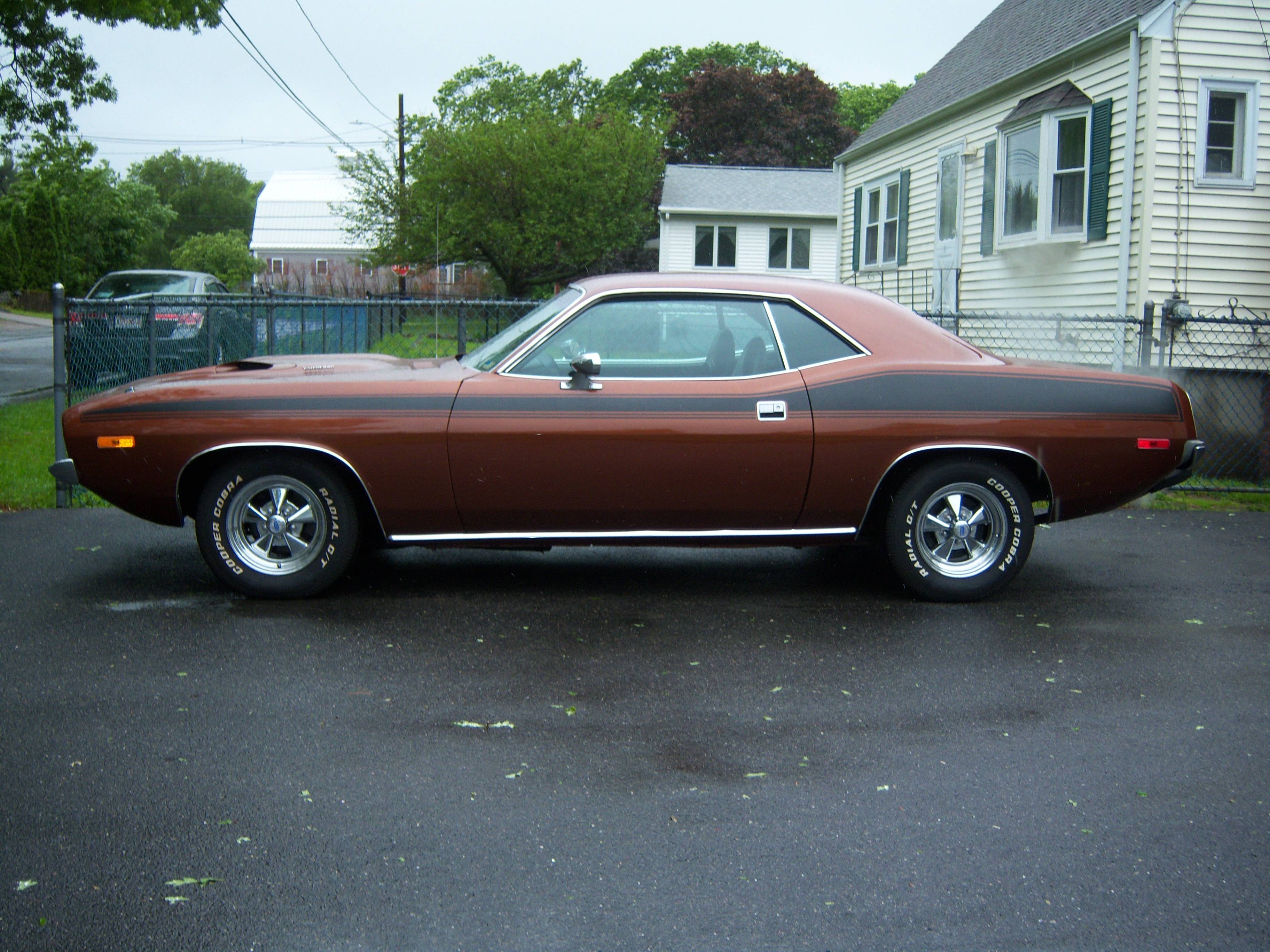

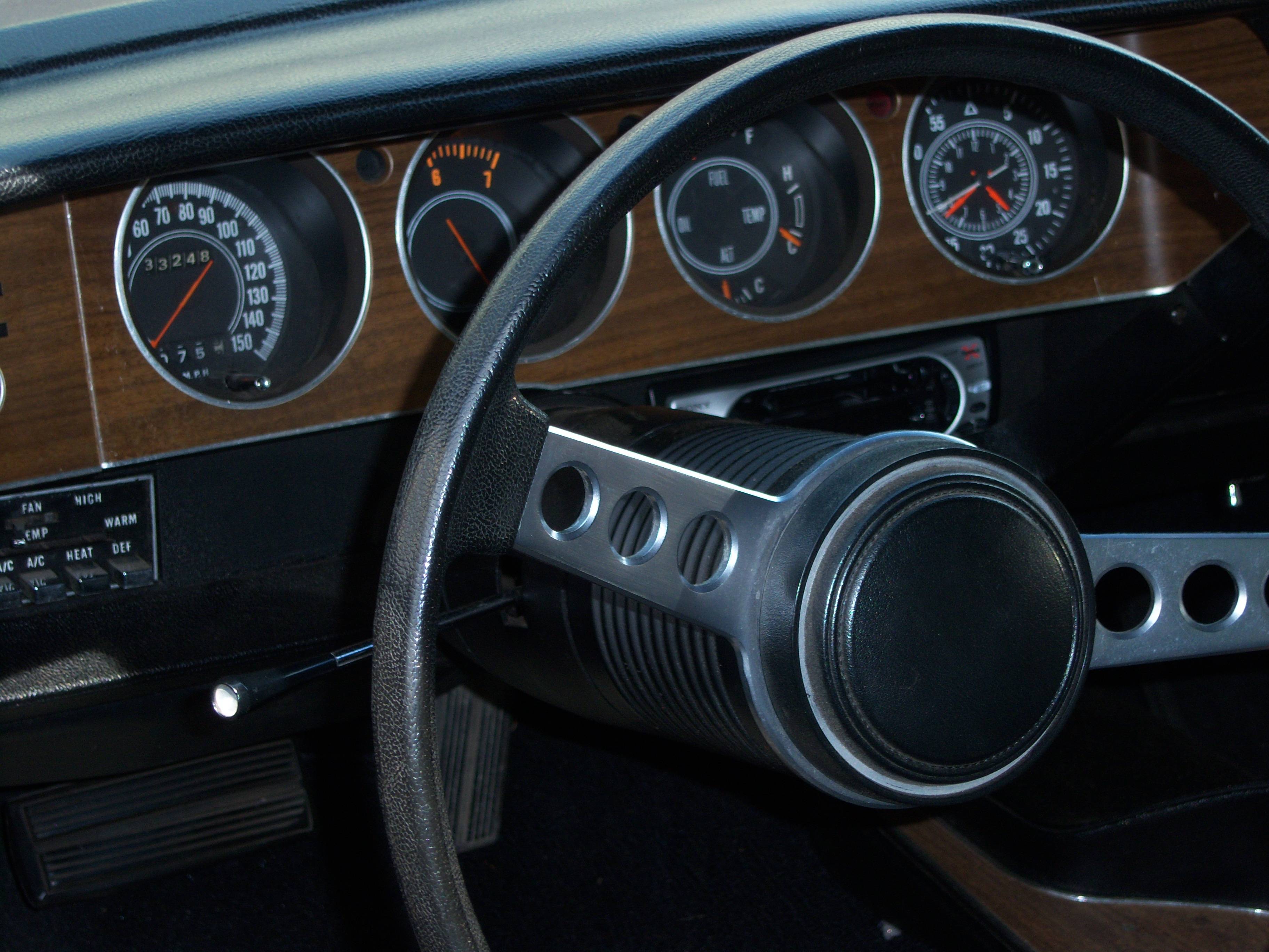

My name is Bert, I have a 1973 Cuda 340. I've had it for 30 years. I drive it a couple of times a week during the summer and to a few shows.

Welcome , Great looking Cuda !

Nice looking Cuda!!
