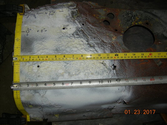

Do you have a pic from underneath where the floor sits on the front frame rail supports

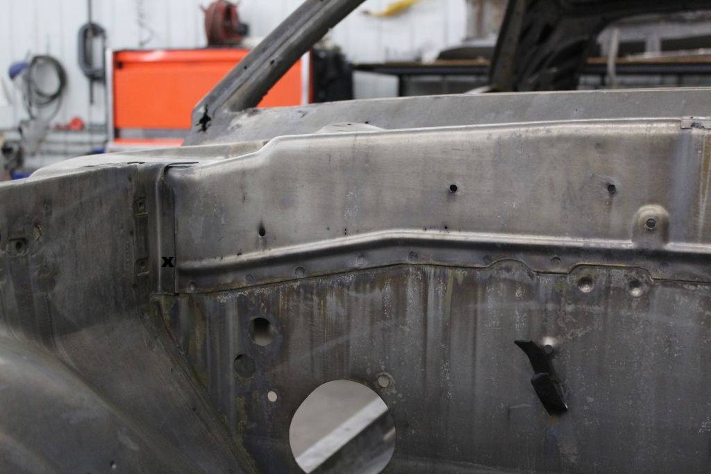

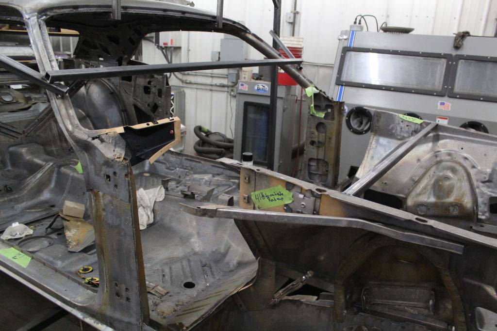

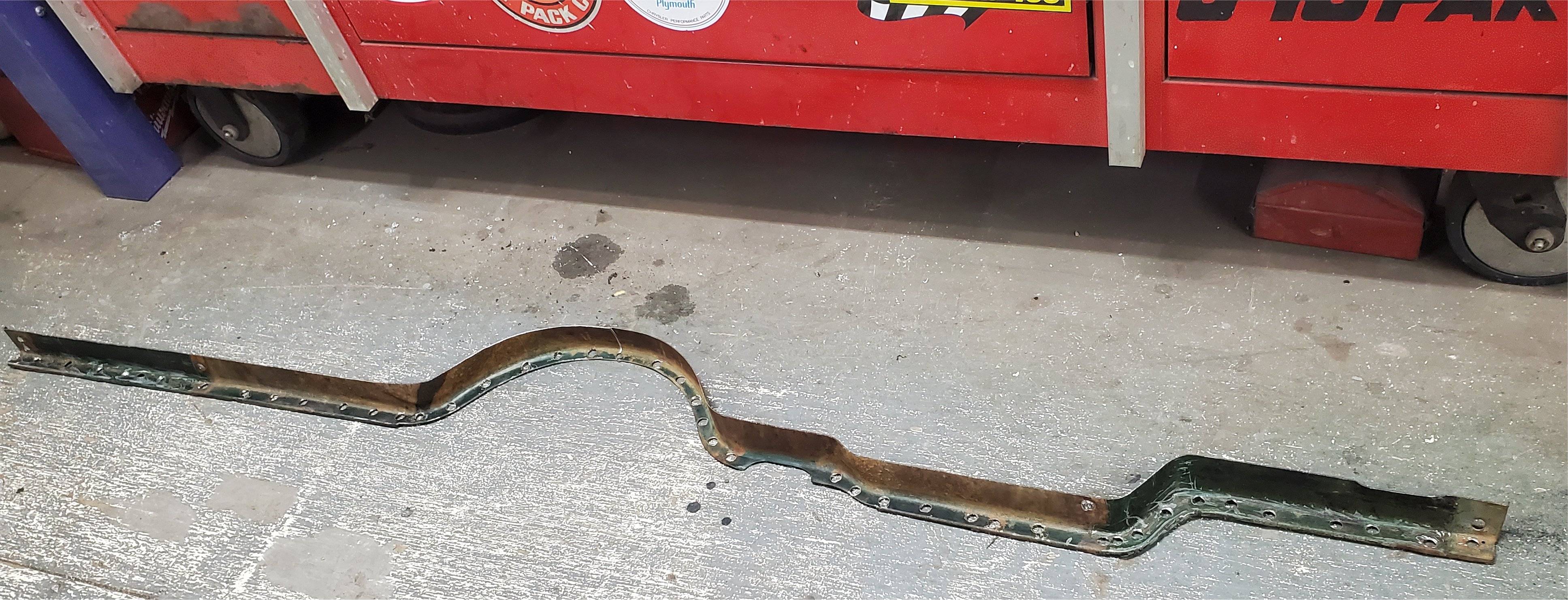

Here is one that was changed out. measure twice cut once. Has there been any work prior to the A pillars that you can detect? Measure twice cut once. If it doesn't measure right I would contact AMD.

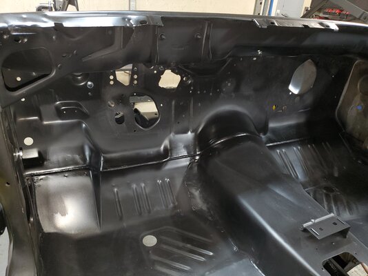

I installed an AMD firewall, it fit very well and only needed a little massage by the windshield corners.
Can you measure the old one and compare it to the new one?

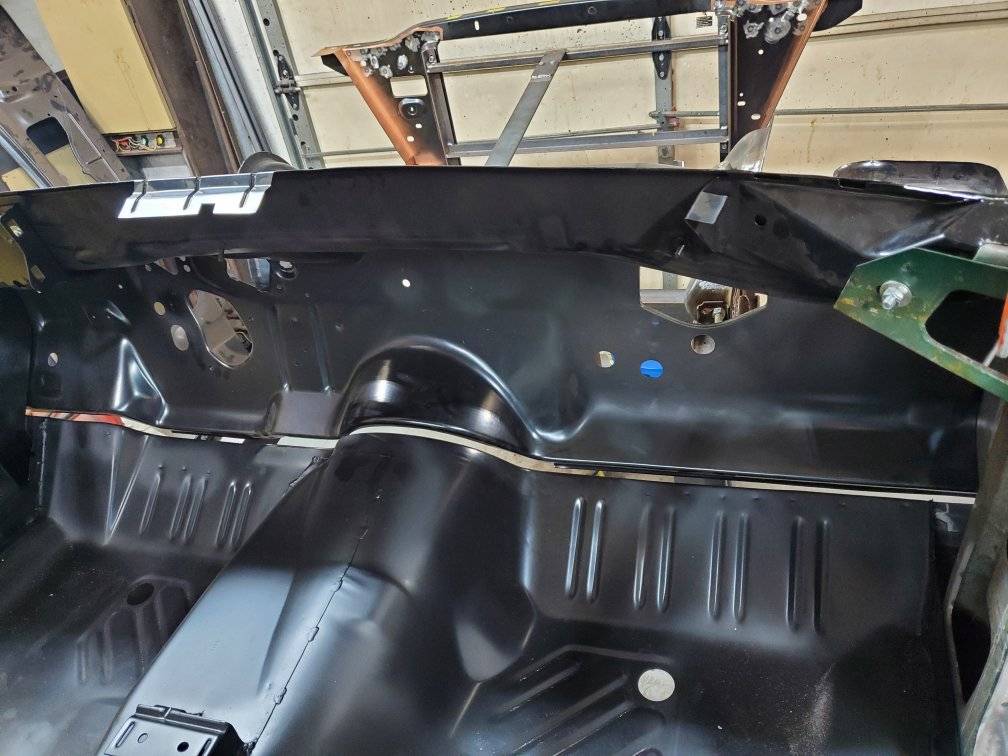

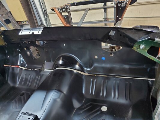

Hi Adam ,how much massaging was required ?
just a trim so the firewall sits down flat onto the windscreen pillar ? Mine seems to be high and needs to be trimmed
Just a little flattening where the diagonal portion transitions to the A-pillar area.
Here is my old photo album, look at pics 17 thru 29. Warning, too many pics😆

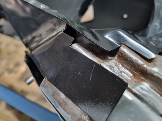

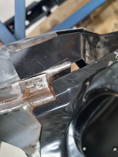

Did you figure out the problem? I too am replacing firewall, upper cowl and front floor pan on my 73 Cuda. I just tried to clamp the firewall back in place without removing old floor. Very difficult to get to align up. I had a 1/2" gap at bottom. I clamped, hammered everything all afternoon and got close with about maybe 1/4 to 3/8" to go. I'm thinking, if I cut floor out and weld as in as one unit to body, maybe it will work with 1/8" and there and much more messaging I can get. but would like to hear your solution
Sounds like you have the same situation going on. The closest I could get it to the floor seam was 1/4" It was an even gap all the way across. I ended up welding in a strip to make up the difference.

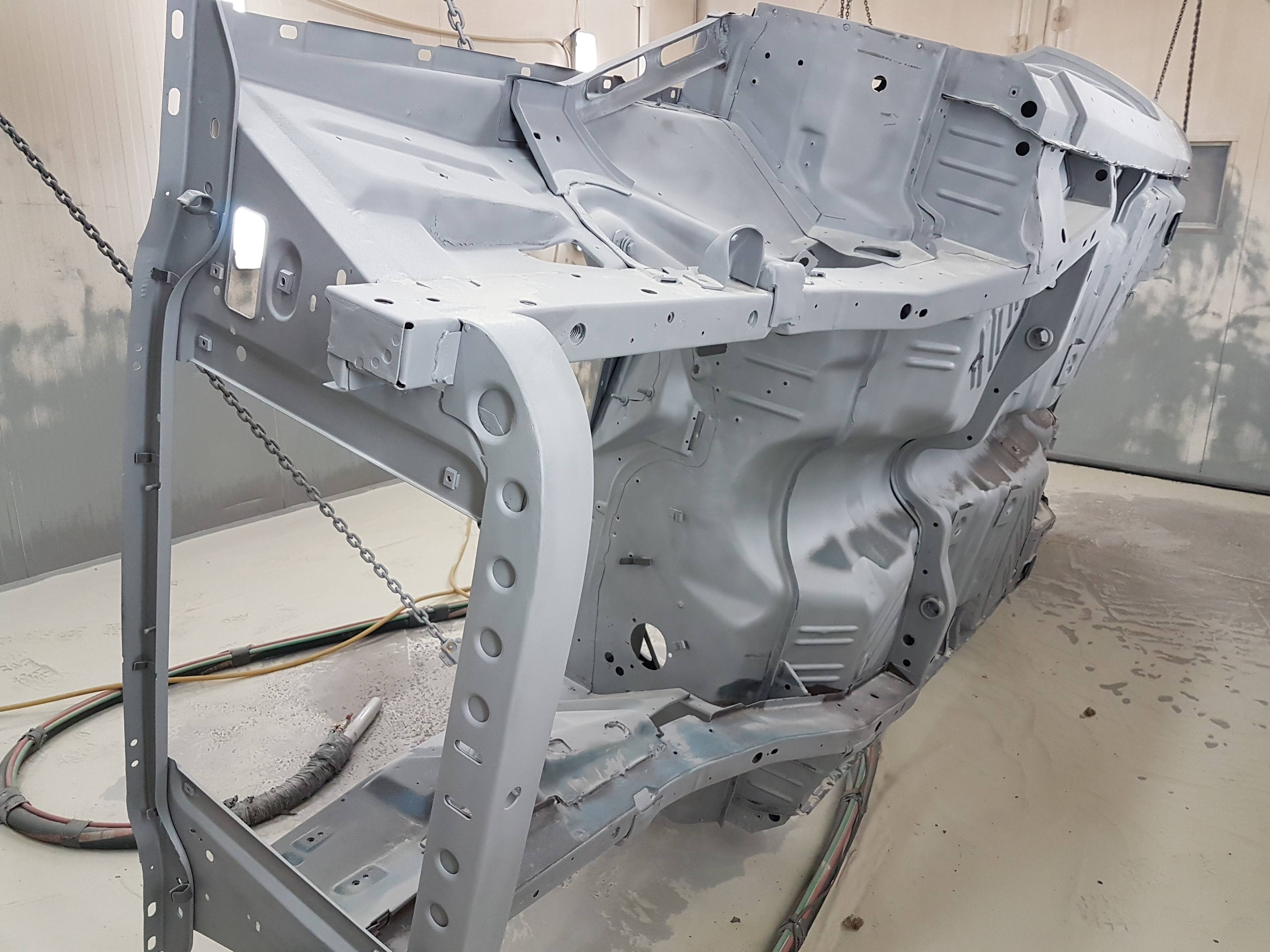

Moparmike1974: We had a conversation about your AMD firewall. I got my firewall and Cowl in the 73 Cuda. With a huge amount on "messaging". Do you have measurements for the inner fenders to weld to firewall and cowl? Measurements from side to side and corner to corner of cowl? Any tips? I attached a few pictures to help. Thanks, 1973CudaKJH
I will see if I can get some measurements this weekend. Question, did you remove any of the following: frame rails, inner fenders, radiator support, shock tower supports?
i am doing this all now as well . the cowl and firewall needs a bit of work up in the top corners for sure . the firewall and floor seem needed a bit of work as well . as you end up with a bit of a gap once cowl is on , hood hinge face to face measurment and cowl to rad support measurment would be good to know . looks like i need to trim around heater hoses etc as well
No, fortunately just had to just cut of from inner fender as pictured to change out firewall and cowl. I'm a bit embarrassed that I didn't take measurements when I cut off. Normally, I'm a detail person. Thanks so much for your help. KJH

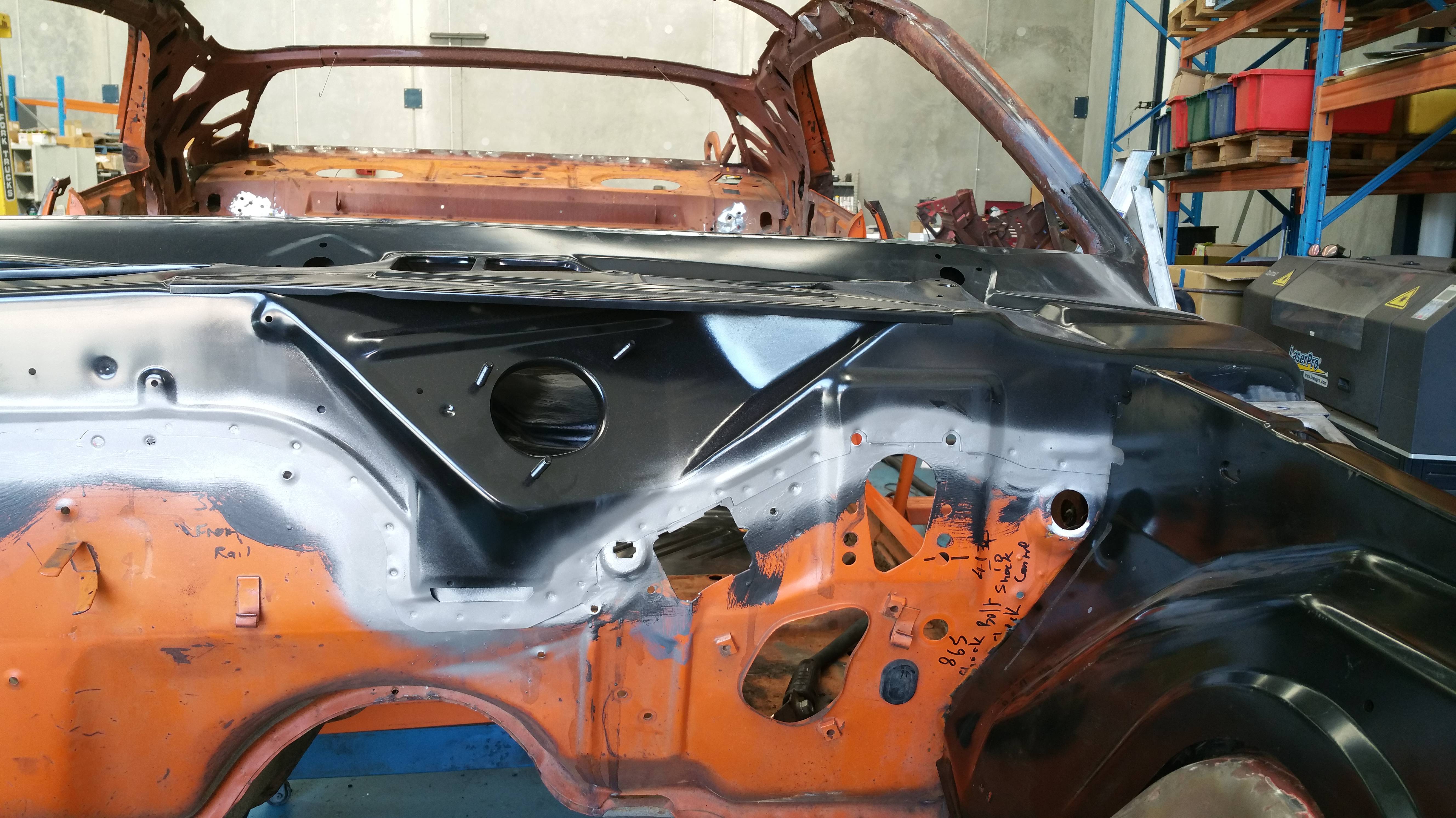

Looks like it could be a bit in the floor & some in the firewall the 1 i fiited had a gap so i pulled it together with self tappers then welded the hole over when finished dont know if this is any help original after blasting & another where i just changed the top cowl
Just would like some info. on how you duplicated the factory spot welds on the cowl panel to firewall panel. Looks amazing!
