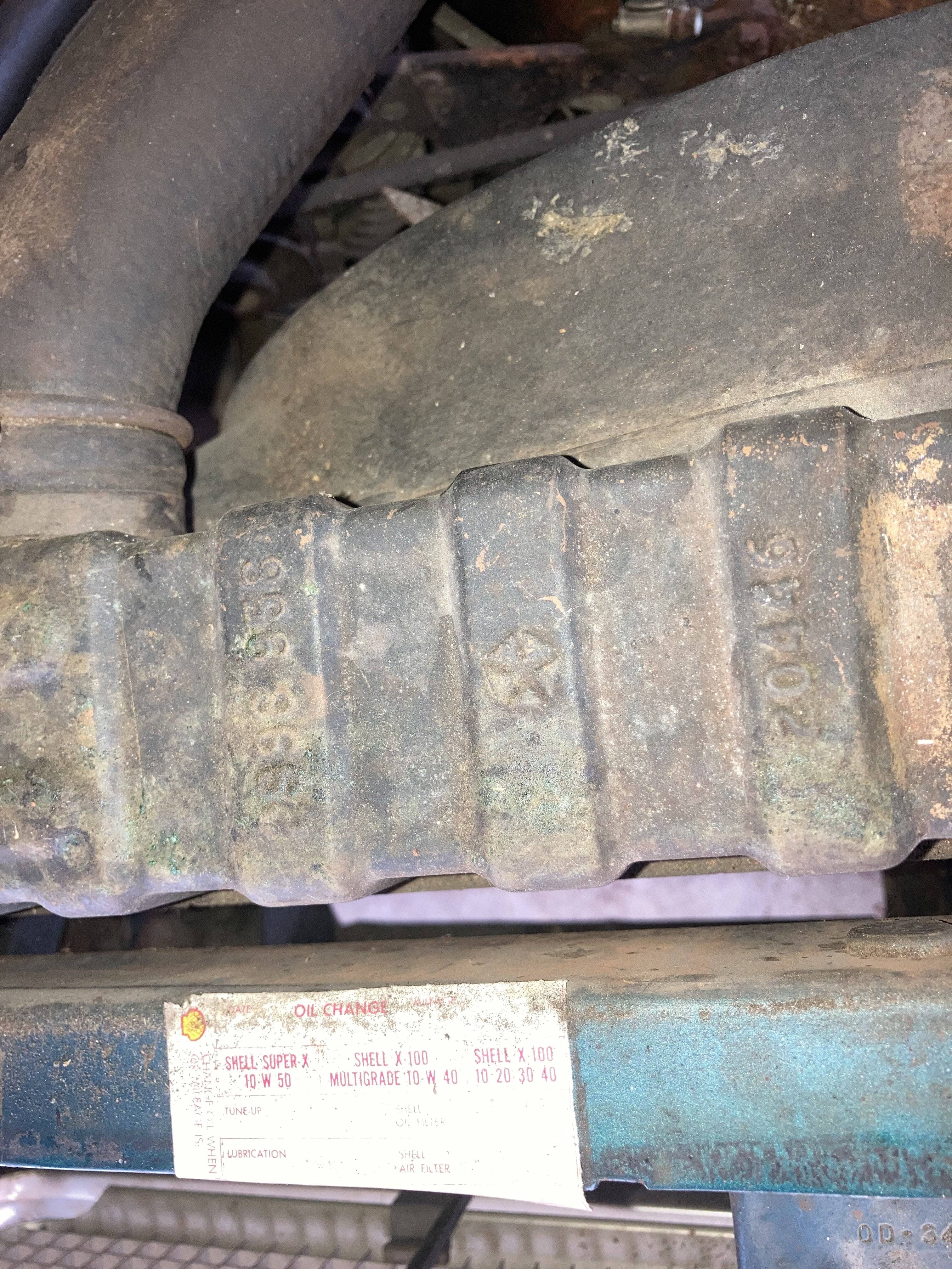

Jeff's 70 R/T
Sep 30, 2018
18
10
Anderson, In
All original '70 RT, 26" Kind of hard to see. This is what the numbers will look like tho

Challenger RTA
Oct 28, 2018
4,304
2,334
PA Flood city
Is there a fender tag or a broadcast sheet?that will show it all.As you probably know.Measure your core support will help narrow it down.Is the opening for 22 or 26?
