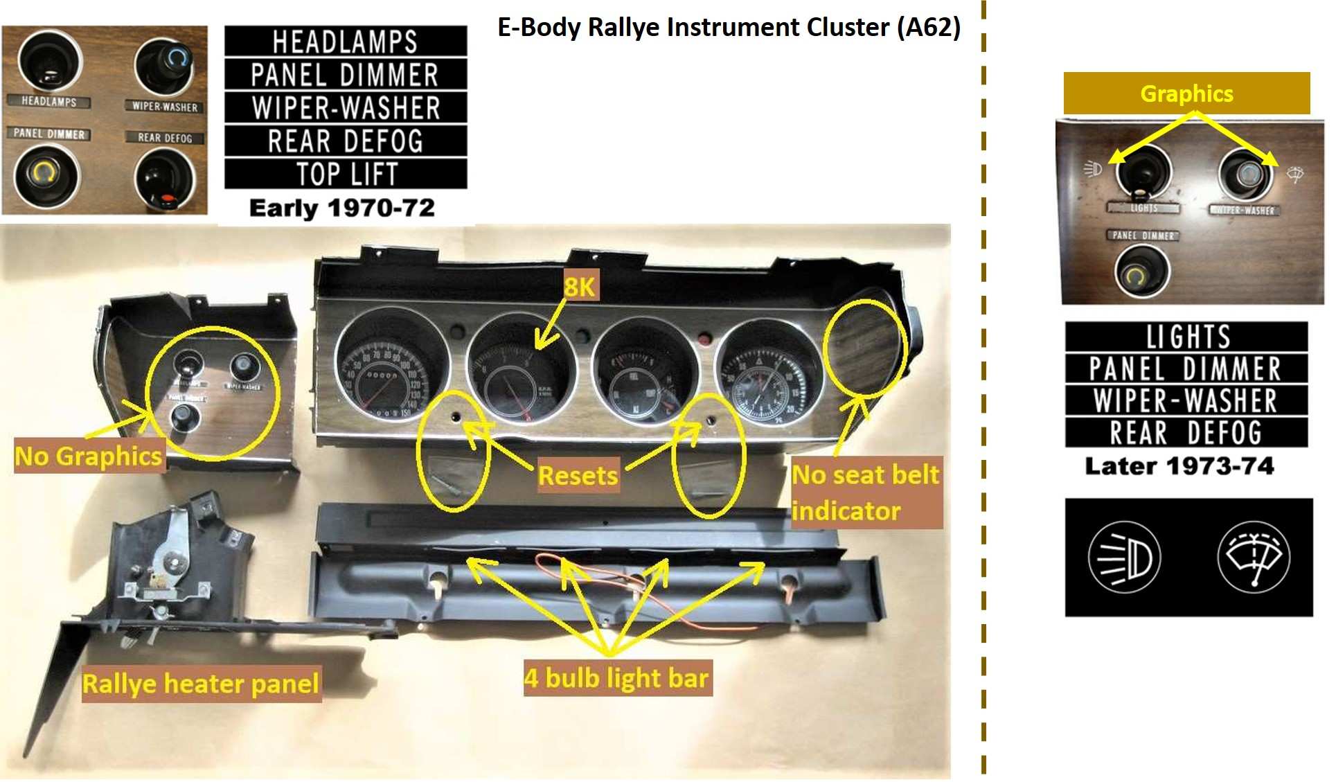

70 and 71 have the trip odometer and clock reset buttons protrude from the woodgrain (not the gauge & clock's plexiglass). No graphics on the switch panel woodgrain, just the labels. 70 & 71 tachs were 8K too, not 7K. No seat belt indicator either. 70 - 71 used a variable speed wiper switch and different motor w/some linkage changes. If accuracy isn't important the existing 2 speed wiper motor/switch setup will work fine. Pictured is a conversion package I sold a few years ago.

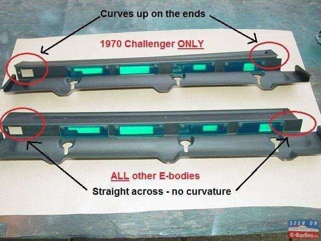

Were there 2 different rallye 4 light bars?
YES! 1970 Challenger is unique, for Rallye and Standard. All others (71 - 74 Challenger & 70 - 71 Barracuda/Cuda) are the same. Explanation and pictures at Reply#10 and Reply#18 in the link.

1970 Challenger Rallye Light Bar shape versus straight E-Bodies Light Bar. The picture at right shows the different labels for the switch panel and the later added graphics of a headlight and windshield wiper/washer.
