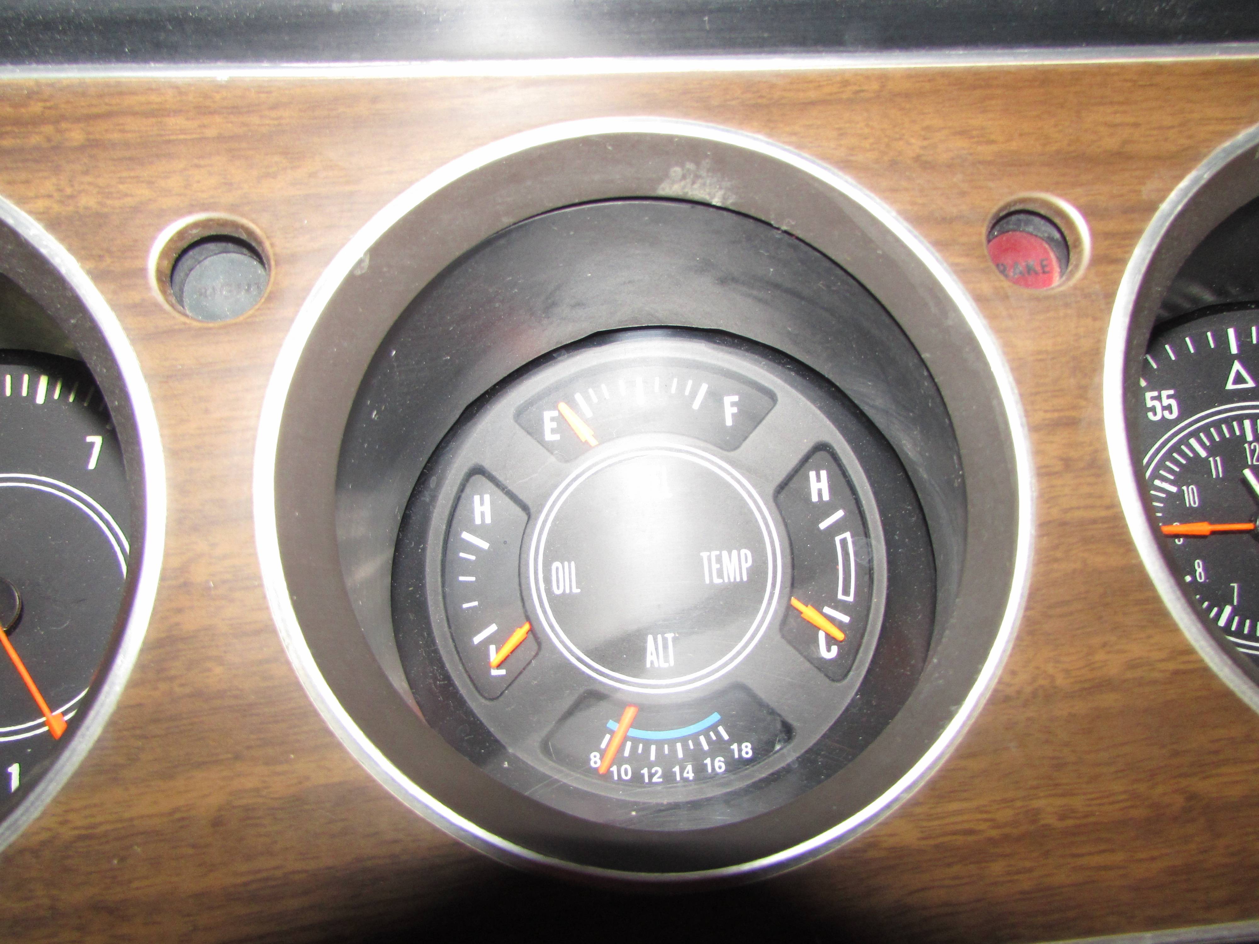

I also installed a voltmeter to replace the ammeter. I did a couple of other things to make my electrical distribution system safer. I installed relays for my low beam and high beam headlamps. I installed relays for my electric fans and I ran a better charging wire from the alternator to the starter relay.

All of that makes good sense. I've heard horror stories of ammeter causing big trouble, like fires... Which reminds me, I need to pick up a fire extinguisher today!
